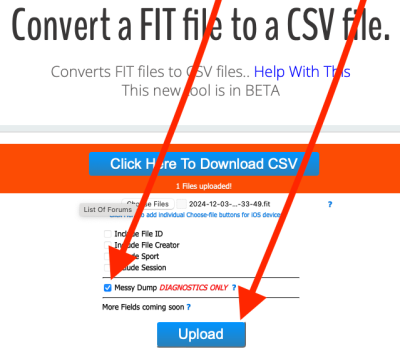

It is natural to be suspicious, so GOTOES offers a diagnostic tool that spits out all of the raw data contained inside of your file. You can upload any FIT file to this site:
https://gotoes.org/gotoes/strava/conver ... to_csv.php
Be sure to check the "Messy Dump" option so you get a diagnostics file:
- First, check the "Messy Dump" box, then click "Upload". After the file is uploaded, download the text file containing all of the raw data from your FIT file.

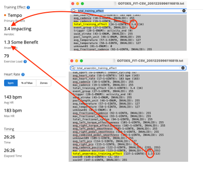

After you download the diagnostics TXT file, open it with the text editor on your computer and search for these two fields:
total_training_effect
total_anaerobic_training_effect
The number you are looking for is the number just before the parenthesis (or you could take the number in the parenthesis and divide by 10).
- Notice how in this example, the values found in the diagnostics file do match what is shown on Garmin Connect. You can test this with your GOTOES exports, and you will see that while the values in the GOTOES file are correct, Garmin might "disrespect" those values and re-calculate your training_effect based on your heart rate.
You should notice that in your original file, and in the GOTOES export, the values for this field are correct.

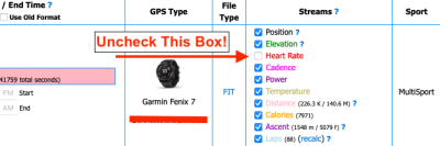

Today I noticed that the upload of edited training effect & benefit values is only working if I delete the heartrate data out of the fit file via Gotoes.
If I upload the same fit file WITH heartrate the edited training effect & benefit values are not uploaded to Garmin Connect, instead the old ones or completey new ones are shown in Garmin Connect.
Seems like there is some calculation done during upload, at least in my Garmin Connect account.

- If you omit the heart rate data, Garmin Connect will be forced to use the training_effect embedded in the file, and will NOT recalculate your training_effect.
