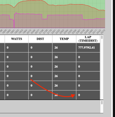

Next, you will want to find the row where you would like to add a lap. Any lap row with a "0" is eligible for automatic lap calculation (we will discuss manual editing of laps below, which is a bit of work).
Click on a ZERO if you want to insert a lap at this timestamp.

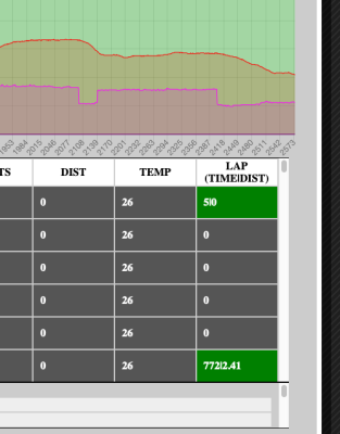

After you click on the zero, the tool will look backwards and forwards to recalculate the time/distance for this lap. It will shorten the length and time of the previous lap, and insert your lap so that the time/distance make it fit before the next lap. Please note that the Lap values are displayed in this format:
time|distance
time is in seconds; distance is in meters.
After the tool has calculated the values, it will insert them and turn the cells that have been changed a green color. You now have inserted a lap!
After the tool calculates the values, the changed fields will turn green.

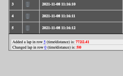

At the bottom of the table, you can view the changes that were made, and you can even scroll to the rows that were changed (by clicking on the link that represents the row number):
A record of what has been changed in your GPS file once you have added a lap.
