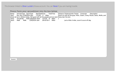

Once you have the spreadsheet filled out, highlight all the cells you have filled out, and copy-paste into the GOTOES Bulk Upload Spreadsheet to Strava tool.
Step **: You might not need to do this if you have already connected GOTOES to your Strava account... but if you haven't yet, the you will need to make this connection.
Step 2: Paste your Spreadsheet into the paste-box.

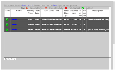

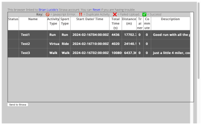

Hit the "Submit" button, and you should see a table with your entries. If any of the rows are red colored, that means your start time is invalid. The tool will skip this row when sending to Strava. The tool tries to be "smart" about some of the items; for example if you do not use the validation in the Google Spreadsheet, it will try to coerce the Sport Type and Activity Type to something that Strava will accept. You cannot "make up" sport types.
Step 3: Click "Submit" and verify that the table is populated correctly.
Finally, you will want to send the items to Strava.
Step 4: If everything looks good, click the button to send to Strava. Files that are uploaded correctly will get a green check.  Also, the Activity name will turn into a blue hyperlink (that opens the newly created activity in a new window).

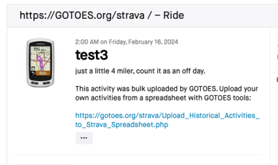

The tool is free to use for any number of uploads. Please note that if you are not a donor, the tool will insert a link back to the tool in your activity description. This will help other people learn that they can use GOTOES to bulk-upload activities to Strava. If you are a > $10 USD donor, this link will NOT appear in your activity description.
GOTOES will add a little link to your description if you're not a > $10 USD donor.  This helps spread the word that other people can also use this tool.  You're welcome to delete the extra lines from your description if you want.
