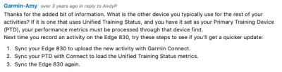

I believe that this issue is resolved. As far as I can tell, the issue is with how Garmin Connect updates their Load Graphs - not with how GOTOES prepares the FIT files. I am open to further comments on this, but here is the solution if you're having this problem. I got the information from this Garmin Forum Post. If you're not seeing the Training Load graph update immediately, I propose two options (IMPORTANT: Make sure that when you export from GOTOES, you use the device name and serial number that matches the Primary Training Device that you specified in Garmin Connect):
  • OPTION 1: Wait until the next day. It seems that Garmin does a delayed sync sometimes for files that are manually uploaded. I suspect that manually uploaded files are treated slightly differently than activities that come straight from the primary training device.
  • OPTION 2: If you don't want to wait, force a sync on your device. IF you have more than one device, SYNC BOTH - twice. Alternate between the devices when you force sync.
This is a screenshot of Garmin's original reply on the forum.

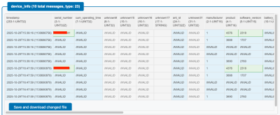

This shows all the correct info in the fit file of a strength activity done the day before yesterday:

That file that you provided was generated by GOTOES. I need the original FIT file straight off the device.

I just put the file into gotoes again and time shifted shifted it to today. I then changed the device type to edge 510 and the activity type to cycling. With the serials number oof my instinct 2 it now did affect load, even though in the activity it shows the instinct 2 as the recording device. Probably because of the serial number. Heres the file for comparison:
GOTOES_8393685760235696_edge.fit
(65.07 KiB) Downloaded 119 times

In the file counted to load the device type was changed to edge 510 but the serial number was the one from my instinct 2. In Connect it then shows the instinct 2 as recording device not the Edge, which I don't even own.

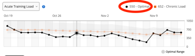

EXPERIMENT 1:
I took a screenshot of my own Training Load:

UPDATE TO MY PREVIOUS REPLY
I woke up this morning with the intention of revisiting this topic to do further research. I had been staring at those graphs so long yesterday that I noticed a subtle change this morning. Just to be sure, I grabbed the screenshot from yesterday and I hovered over the October 29th date (the date of the activity you supplied me). It turns out that I had FORGOTTEN TO DELETE THE TEST FILE FROM MY ACCOUNT YESTERDAY!
Before
This is a a screenshot of what my load looked like yesterday - even with the activity loaded into my account!
After
This is a a screenshot of what my load looked like this morning

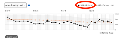

So, what it now looks like to me is this: When you load a file into Garmin Connect - EVEN IF IT HAS LOAD DATA, Garmin doesn't always immediately update your graph. I accidentally left your file in my account, and somehow overnight, the graphs changed. I know that I took that "before" screenshot AFTER I had uploaded your file to my account, and the load was unaffected. This may also explain why you saw a change from the mysterious Garmin 530 file when you uploaded the next day. You weren't seeing the result from the 530, but instead the delayed update from the GOTOES file you had uploaded before.
I still find it curious that my original load was 550 and after adding 28 "units" of exercise load, it was increased to 586. That doesn't pencil out mathematically.

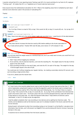

**UPDATE November 14, 2025 @ 7:25AM:
I just figured out how we got from 550 to 586 with a load of 28... I just found this forum that mentions that the load is increased by 28%. When you take the load of 28 and multiply it by 1.28 (i.e. 28%) you get 35.84, which rounded up is 36. 550 + 36 = 586 !!!
How are we getting an additional 28% load?
