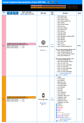

GOTOES merged the Developer Data fields. Notice how we have Tyme AND Karoo data fields in the merged file.
I then opened up a Tymewear account online, but could not find any way to upload the file I had created for a test. It seems as if you might need to be supplying files directly off the device? If this is the case, GOTOES might not be able to help, as I see no way to manually import files. Maybe you know how to do this?
Here is a shot of all your connected sensors (at least what the devices are recording)!
I also uploaded the merged file to Garmin, but I saw that none of the developer data fields have been registered with Garmin (this includes the Karoo developer data). In order to "see" the developer data, it must be registered with the platform that you're viewing it on. So, if tymewear is able to read a file that has both Karoo and Tymewear data, this attached file (merged-6.fit) should work for you. I tried it in Garmin and could not see the Tymewear data.. but I could not see the Tymewear data in your original file either because Tymewear has not registered with Garmin. Tymewear has also not registered a Manufacturer ID, so the device is currently "unidentified" across platforms. If they get registered, I can add them to GOTOES (just let me know when this happens).

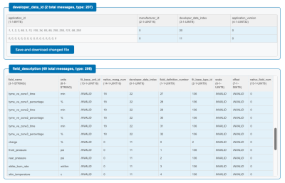

I've compared 2 timestamps and although GOTOES has merged the data the figures are all wrong which is probably why it is all wrong in Intervals and TP.
this one is to show the fields recognised in TP from a Tymewear file
this is the merged files but wrong numbers
this is the merged file uploaded to Intervals, there are just a few spikes
this what the data should look like in intervals - this is the un merged tymewear file
Re: Does the Merge Tool also combine developer fields from two FIT files?
Posted: Mon Nov 24, 2025 4:47 pm
Ah, sounds like I can use Training Peaks to test. Are you a paid member of Training Peaks? The reason I ask is because even when I upload your original Tymewear file, I cannot see the Tymewear data in my account. Also, I was unable to import files to Tymewear for testing..
However, I do see from your screenshot, the most helpful one of the raw data, that there does seem to be some sort of units difference in the GOTOES file. GOTOES does not manipulate the developer data, but instead inserts it as-is. However, GOTOES does read the field types assigned by the file and puts them in the output in the same format as GOTOES reads in. So, there does seem to be a discrepancy there.
The short answer to your question seems to be that as of today (November 24) GOTOES needs to be updated to work around this data format anomaly. I'm going to be out of town for 3 weeks, but when I return, I'll work on making GOTOES work with Tymewear files.
