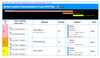

Ryan -
It appears that the 2nd file you sent (the one from the iPhone) is actually corrupted. Check out the attached image.
Corrupted file
Corrupted file
In the attached image, you will see a pink line (that represents your Garmin 25).
Next you will see the orange line. That is the iPhone file you sent me. It is corrupted, as it ends at 12:46:39...
So, I uploaded your corrupted iPhone file to Strava, and they got the remaining missing part out of it. Then I exported it from Strava as GPX, and uploaded it to my tool (just that one file; like you did: used the merger with one file). When I did that, I also did a crop so it would begin at 12:43:48... the exact same second as the pink line ends. That is what you see as the yellow line in my image.
I went ahead and unchecked all the boxes for the orange line, and combined everything from the pink and yellow lines.
Congratulations - that was a lot of climbing!

I figured out what the problem with your file was. In the FIT export produced by Strava, every other point was empty. My tool counts the number of valid point in the file, then it reads them all in. So, let's say there were 5,000 points in the file, my tool will read 5,000 points. The problem is that there are actually 10,000 points - every other one is empty... my tool was reading the 5,000 points, half of which were empty... and then stopping because the header said that was the end of the file. Effectively, it was only reading half the file.
So now my tool now looks for this type of corruption and resolves it. In the last couple days, people have been contacting me with quite a few different types of corruption in files exported from Strava. It seems as if their export corruption may be connected to their phone app. Anyway, Strava seems to be able to read their own corrupted files, but (most) 3rd party apps are going to struggle with their files until they get it fixed.
