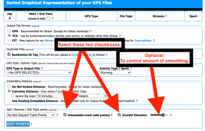

OK, I added it. In order for this feature to work, you need to select “Interpolate Points”… then you can check the smooth elevation box, and adjust the slider as shown below:
Fix GPS Track for Rouvy, Peloton, or Zwift

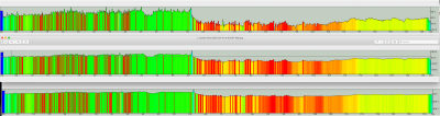

Here is a screenshot of the outputted grade when using various levels of smoothing. Speed is the color (the speed you went, I assume). The height of the peaks represents the grade (but pay attention to the scale on the right).
Smoothing Elevation of GPS | TCS | FIT Files for a Trainer | Virtual Ride
Top image: your file
middle image: Slider set to middle setting.
bottom image: Slider all the way to the right (may be too smooth!)
Maybe give it a try, but you’re still going to have to pedal harder on your way near the top of the summit! I’m guessing that the change won’t be as abrupt now.

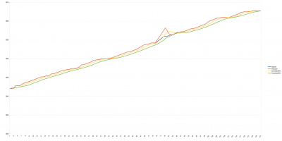

Here is the elevation after using your tool.
The blue line is the file I used as a sample.
The red line is where I modified the blue file, adding in a big elevation spike; effectively "poisoning" it.
The yellow line is where I took the "poisoned" file and ran it through your tool with the slider at 25%.
the green line is where I took the "poisoned" file and ran it through your tool with the slider at 50%.
