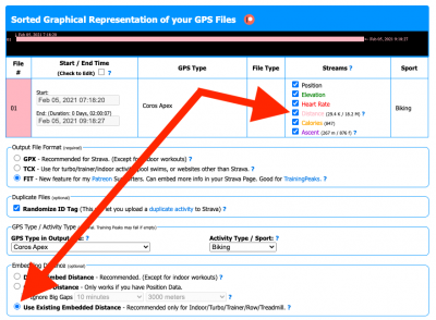

This is a good question, and one I get a lot. If you export as a FIT or TCX from my tool, the distance from your original files will be embedded in the output file. To get the distance to embed, you will need to make sure you check the "Distance" box in the streams and then check the "Use Existing Embedded Distance" option. Both of those boxes are highlighted in the image below:
Embedding Distance from a GPS file.

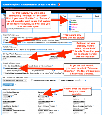

I re-read your question, and now I see that your device cannot embed distance. This inspired me to write some additional code that manufacturers distance in a linear format. In other words, since you don't have the point-to-point information, you're just going to get one straight line for speed (it will match your average speed)... but the tool will fabricate your total distance based on what you enter in the "Override Total Distance" box. Here is how you need to set up the tool to achieve this:
How to Add Distance from a Stationary Bike to Strava.
Notice how you need to select "FIT" as your Output File Format. Also, you ought to select "Virtual Ride" to tell Strava that this was an indoor workout. Next, you need to select "Calculate Distance." This tells my tool to fabricate a point-by-point distance for your new file. To do this, the tool counts up the total number of points, and then takes the distance that you enter, and it divides the number of points by the distance. This will cause a flat line in your speed. Hope that helps!

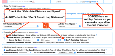

Hi Peter — what you’re asking for is already built in 😊
When you process your file, just select “Calculate Distance and Speed” and do not check “Don’t Recalc Lap Distances.” That way, each lap gets its own distance and speed based on your lap times (including a partial last lap). If your file doesn’t already have laps, you can use the Autolap feature first.
Here is a screenshot where you can find the features you are requesting.

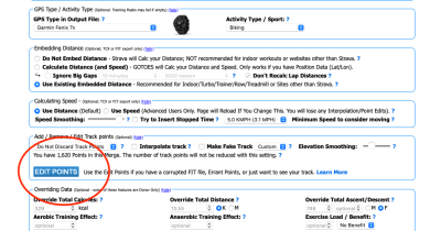

If you want to skip the CSV intermediary, you could also just upload your file(s) to the merger and click on the big blue "Edit Points" button:
How to edit individual points so you can add lap(s) to your file - directly on GOTOES.

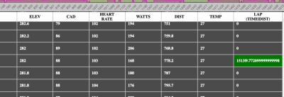

This is what an edited lap looks like. After you make an edit, the cell will turn green.  In this case, the time and distance was auto-calculated.  IF you do not have distance in your file, the time will be calculated, but you will need to type in the distance when editing.
Once you do that, you will be presented with an Excel-like table where you can manually add in laps... just scroll to the point where you want to add a lap, and enter the time/distance just like above. IF you have accumulated distance (this is what almost all "proper" FIT files should have)... then GOTOES will just automatically calculate the lap distance and time for you (and thus you will see your lap speed on Strava)... but if your source files are missing the distance, GOTOES will only calculate the time for you. Time is required to be present in order for you to even upload to GOTOES; your file will be rejected if it does not have timestamps, and you will be encouraged to add timestamps using this tool.
