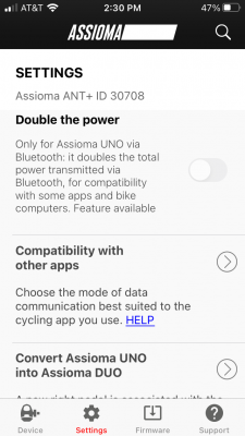

Step 1: If you have the Assioma Duo Power Pedals, your first job is to separate them. You can do that in the App.
Click on "Settings" (at the bottom of the screen).  Then click on "Compatibility with other apps".
On the next page, select "Dual Channel L/R".  This will make your power pedals each broadcast their own power on separate Bluetooth Channels.
