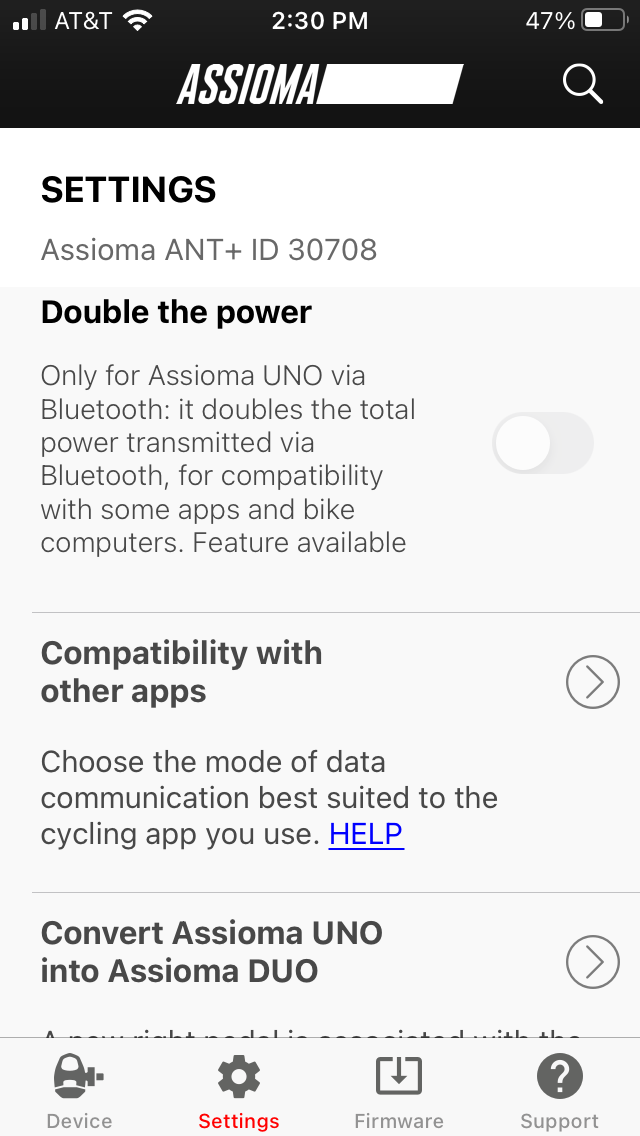

Step 1: If you have the Assioma Duo Power Pedals, your first job is to separate them. You can do that in the App.
Click on "Settings" (at the bottom of the screen).  Then click on "Compatibility with other apps".

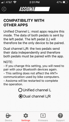

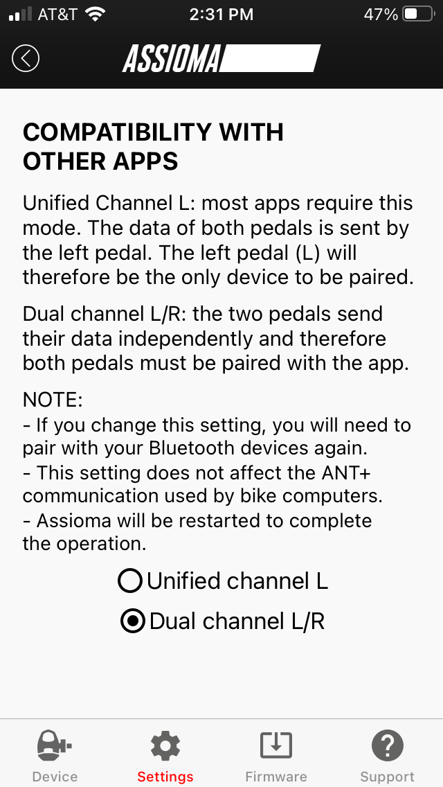

On the next page, select "Dual Channel L/R".  This will make your power pedals each broadcast their own power on separate Bluetooth Channels.

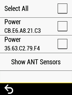

You may have to wait, but eventually you will see TWO power options; one for each pedal:
After a bit of a wait, you should eventually see two new Bluetooth devices.  Each one of these corresponds to a pedal.  Choose ONE of them to add.  Remember the name because you are going to add the other pedal to your other device.
Connect ONE of these to your GPS. You will want to repeat the same set of steps for your partners GPS - but be sure to select the OTHER pedal. You can then do a test with each pedal on your tandem to make sure you know which pedal is connected to which GPS.

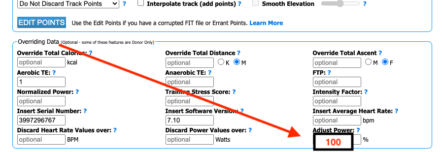

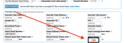

During your activity, the GPS will only record 1/2 the power (because each pedal is only recording half of your effort). After your ride, import your files into the GOTOES | Strava Tools and select the "Adjust Power" option (this is in the bottom right hand corner of the "Overriding Data" box). Type "100" in the box. This will increase your power by 100%, which is double. You can do this for your activity as well as your partners. This will allow you to record power data on your tandem with just one set of pedals.
