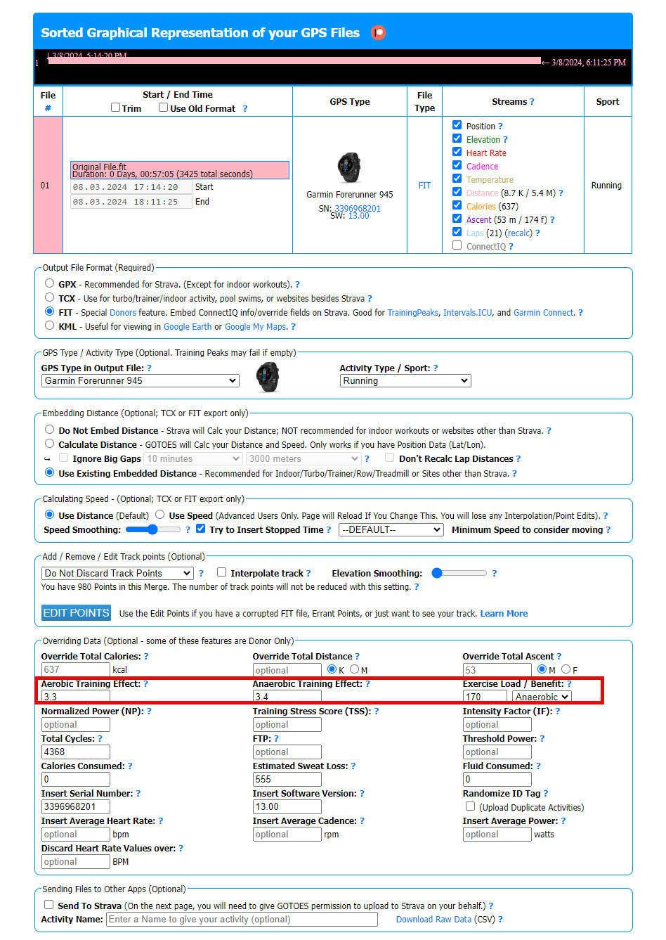

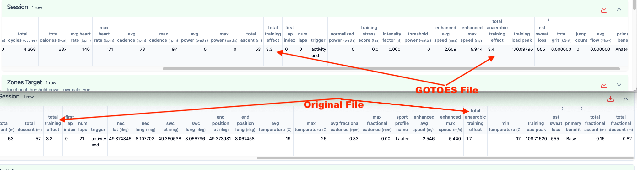

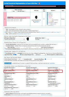

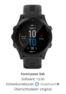

when I try to upload a FIT file to that I edited in GOTOES to GARMIN CONNECT, all values are accepted in GARMIN CONNECT except the following:
- Anaerob Training Effect
- Aerob Training Effect
- Exercise Load / Benefit

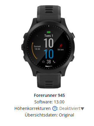

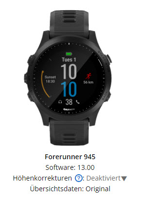

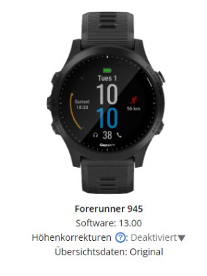

I already checked that my Garmin Device (FR945), Serial Number and Software Version (13.00) are included, which is the case.
I also do see these values and my watch in GARMIN CONNECT, but it still does not take over the 3 values from GOTOES.
Instead of that, it keeps the original values.
I noticed that the Software Sersion in the GOTOES FIT file is always set to 13.01 instead of 13.00.
So if I put in Software Version 13.00 / 12.00 / 11.00 / ... GOTOES always sets it to 13.01 / 12.01 / 11.01 / ... in the FIT File.
Could this be the reason why the values for training effort etc. are not accepted by GARMIN CONNECT?
Thanks and best regards,
D.

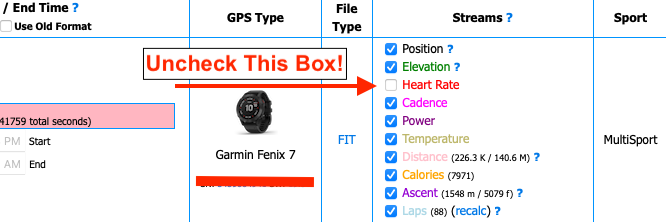

The current solution to this problem is indicated below. I will persevere the historical posts as well so you can see how we came to this resolution. I will update the post if we figure out a setting in Garmin Connect that disables this auto-correction... or if Garmin agrees that this is a "bug" that needs to be fixed.

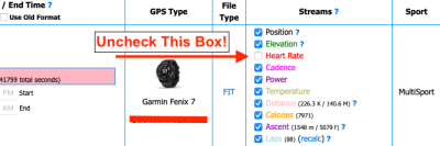

SOLUTION:
Guys - I have verified that this:
Garmin will override FIT Training Load / TrainingEffect / Benefit if you include heart rate. Basically, Garmin is re-calculating these factors from the heart rate and IGNORING the values that GOTOES puts into the fields. If you exclude heart rate, Garmin will accept the values from GOTOES.
Another user found that if they omit the Garmin Device (or maybe the serial number) Garmin also respects the GOTOES data and does not perform the recalculation.
The best way to get this fixed is to ask Garmin Connect to stop overriding the data. You can do that by using this link:
https://support.garmin.com/en-US/?productID=73207&tab=topics
Select “Chat” or “Call” and let Garmin know that they should not recalculate Training Load / TrainingEffect / Benefit from heart rate unless those values are absent. Please suggest the following:
What if you still think this is a GOTOES bug?

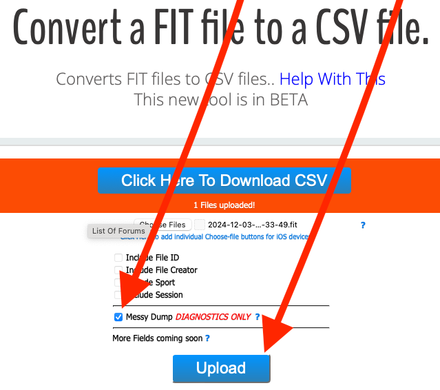

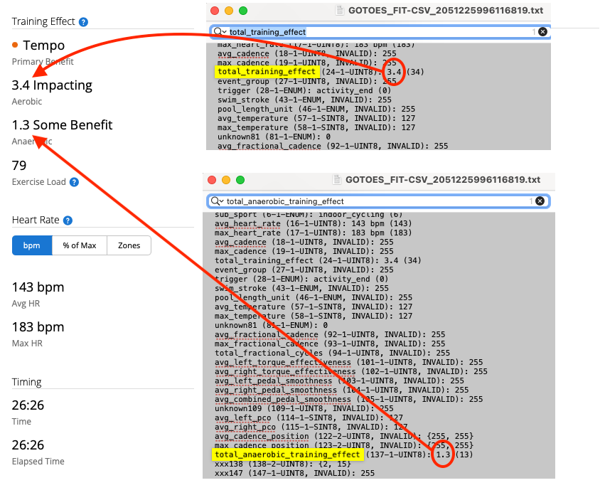

It is natural to be suspicious, so GOTOES offers a diagnostic tool that spits out all of the raw data contained inside of your file. You can upload any FIT file to this site:
https://gotoes.org/gotoes/strava/conver ... to_csv.php
Be sure to check the "Messy Dump" option so you get a diagnostics file:
After you download the diagnostics TXT file, open it with the text editor on your computer and search for these two fields:
The number you are looking for is the number just before the parenthesis (or you could take the number in the parenthesis and divide by 10).
You should notice that in your original file, and in the GOTOES export, the values for this field are correct.
Thanks!

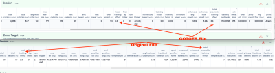

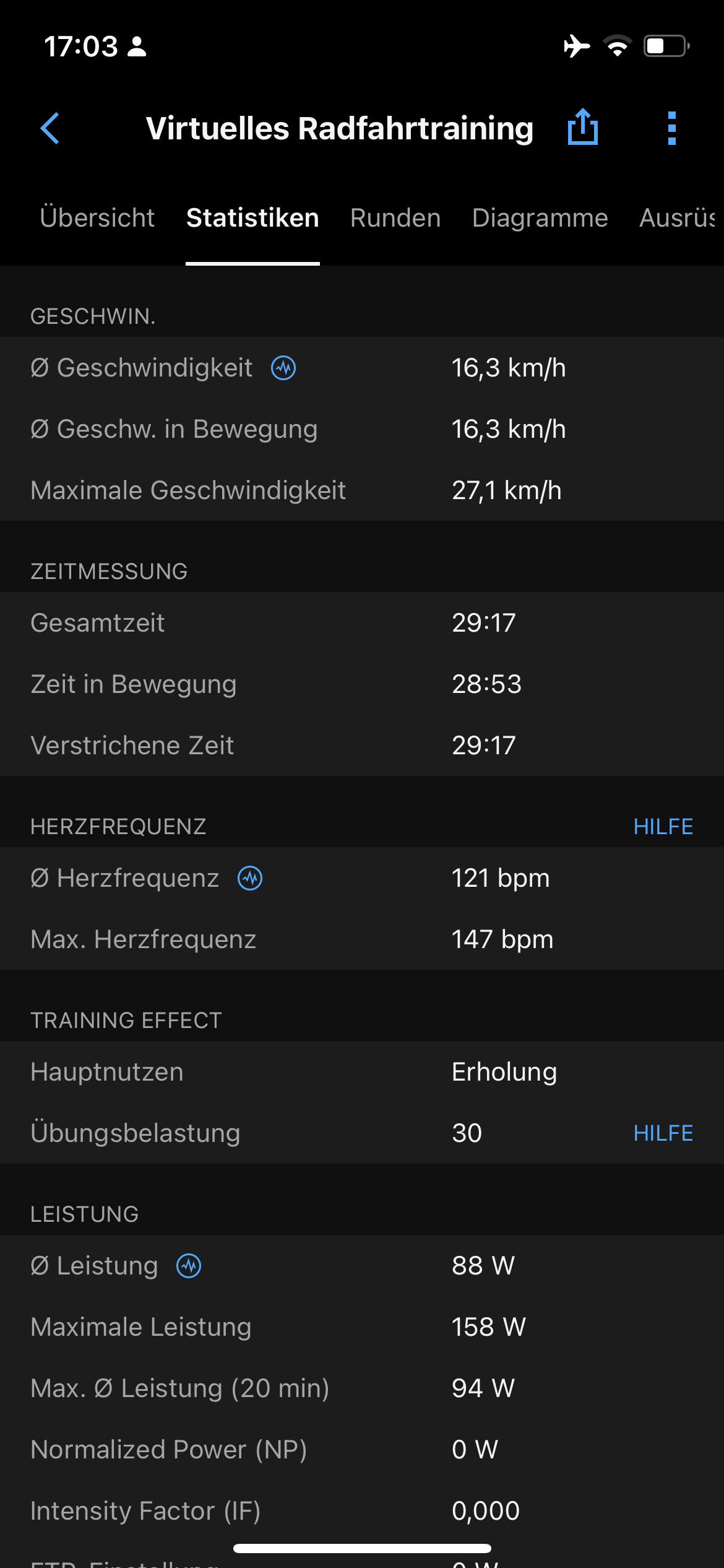

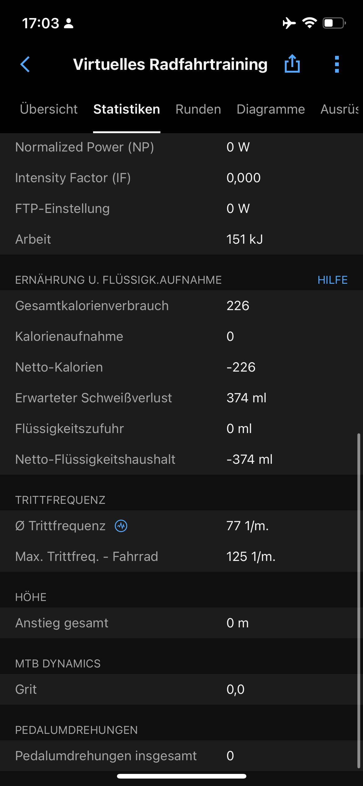

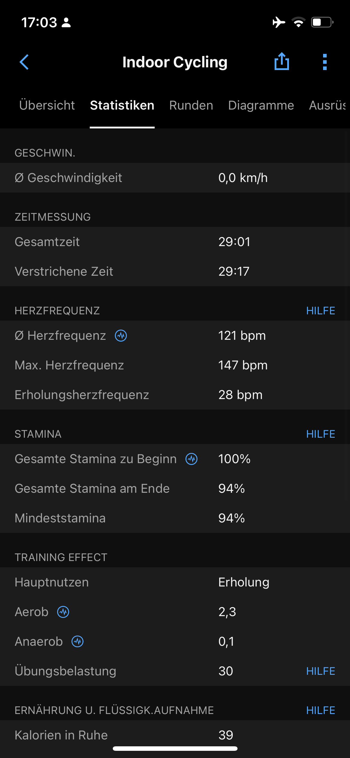

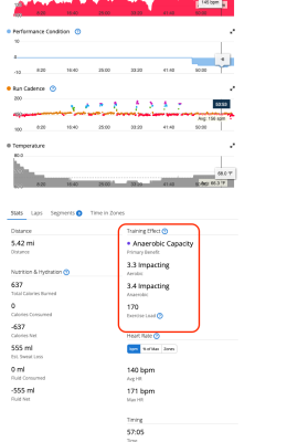

Attached you will find some screenshots and the 2 fit-files (one original from Garmin and the one editetd with Gotoes).
As you will see, I´m able to upload the edited fit-file, but the Training effect fields are not overtaken (but weirdly they changed anyhow).
The issue with the software version seems to be fixed already.
Thanksa and best regards,
Daniel

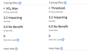

thanks for your qucik reply!
Daniel

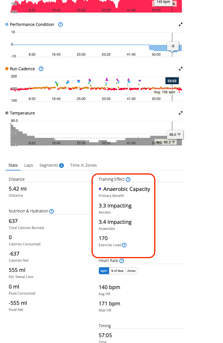

- Garmin Connect - training effect fields in original fit file
- Garmin Connect - original - training effect.jpg (18.61 KiB) Viewed 55010 times
- Garmin Connect - training effect fields in Gotoes generated fit file
- Garmin Connect - Gotoes - training effect.jpg (17.87 KiB) Viewed 55010 times

I cannot seem to replicate this issue.
First, I took your GOTOES and original files and uploaded them to https://www.fitfileviewer.com. I could see that the values from your screenshots were correctly placed in the correct fields.
Next, I took your GOTOES file that you uploaded to this forum, and uploaded it to my test Garmin Account. The values from the file were displayed correctly in Garmin Connect. Please note that I had trouble signing in to Garmin Connect for a while this morning; their site seems to have been down for a while. Maybe they were working on this issue? Regardless, given that we can clearly see the correctness of the GOTOES file in fitfileviewer, I surmise that this issue is on Garmin's end, not GOTOES. Please contact Garmin if this issue persists with your Garmin Account. Also, if they provide you with some information about what is going on, please report back here, as I would like to know. Thanks!

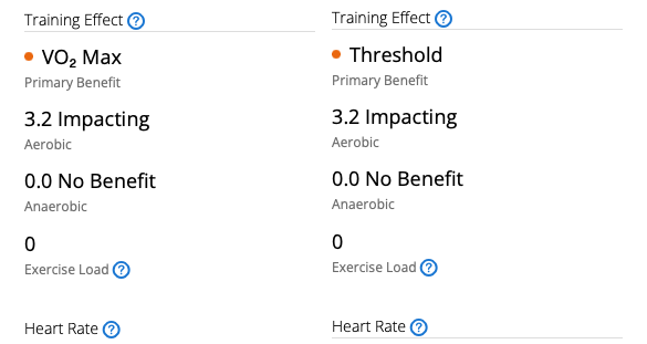

I also tested the files now with a another newly created test account in Garmin Connect. Like in your case it did work there.
But with my own real Garmin Connect account the upload of the training effect fields does still not work.
Same problem if I try with other edited training files: It does work in the test account but not in my real account. Very weird.

short update:
Today I noticed that the upload of edited training effect & benefit values is only working if I delete the heartrate data out of the fit file via Gotoes.
If I upload the same fit file WITH heartrate the edited training effect & benefit values are not uploaded to Garmin Connect, instead the old ones or completey new ones are shown in Garmin Connect.
Seems like there is some calculation done during upload, at least in my Garmin Connect account.
In the test account everything works well with or without heartrate in the fit file.
Just wanted to share this with you
Best, D.

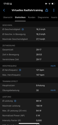

Hi, thanks for your reply. I tried to reach out to them via chat. They just sent me a link to the third party connection site and then "unexpectedly" closed the chat. I think it is hard to reach them in general and specific a person who is able to help with that issue. I think i will just stick with the wrong calculation. Maybe its more accurate as it takes the power data into account while importing.
Re: Garmin Upload - Training Effect & Benefit does not work

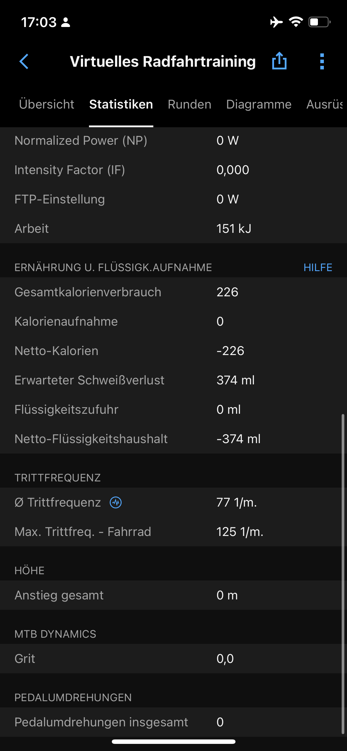

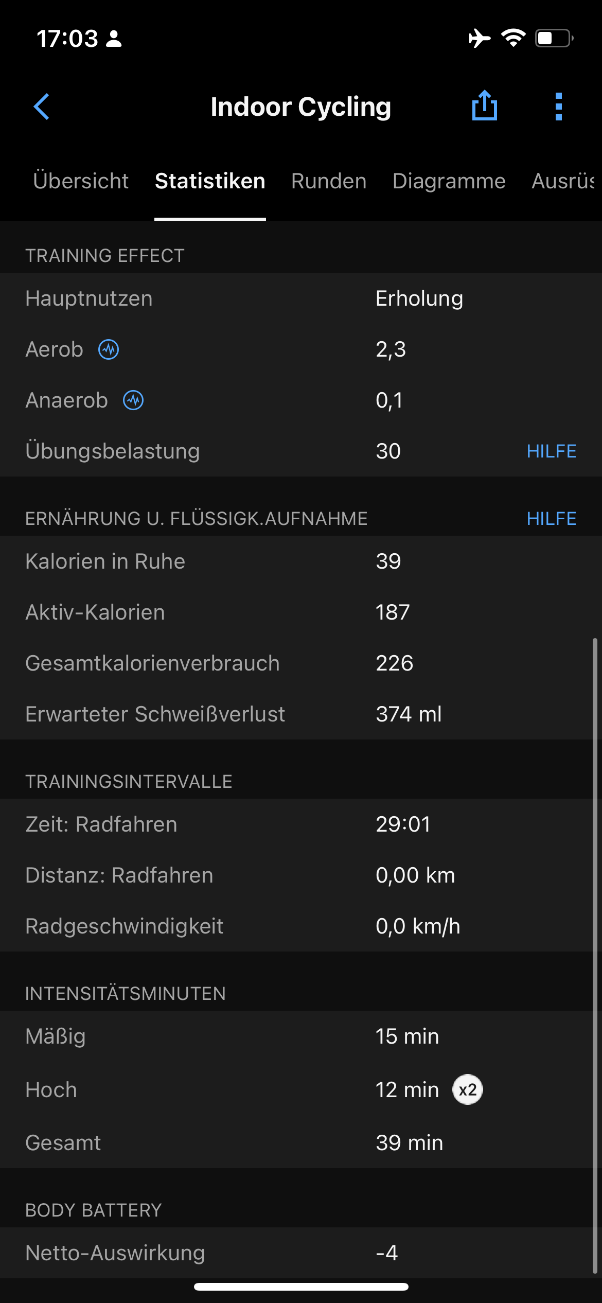

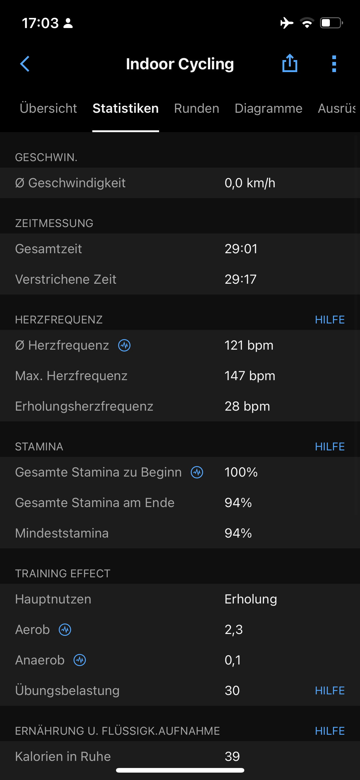

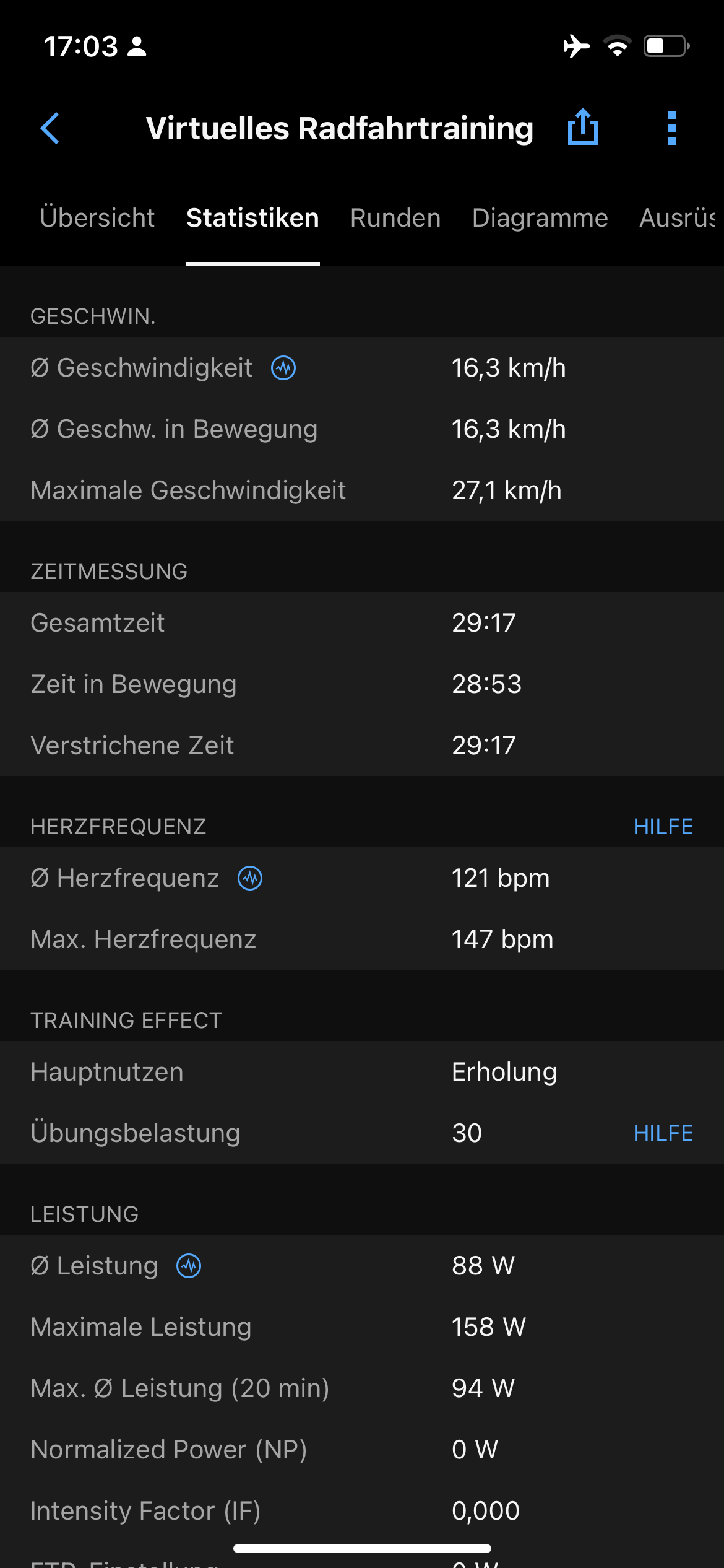

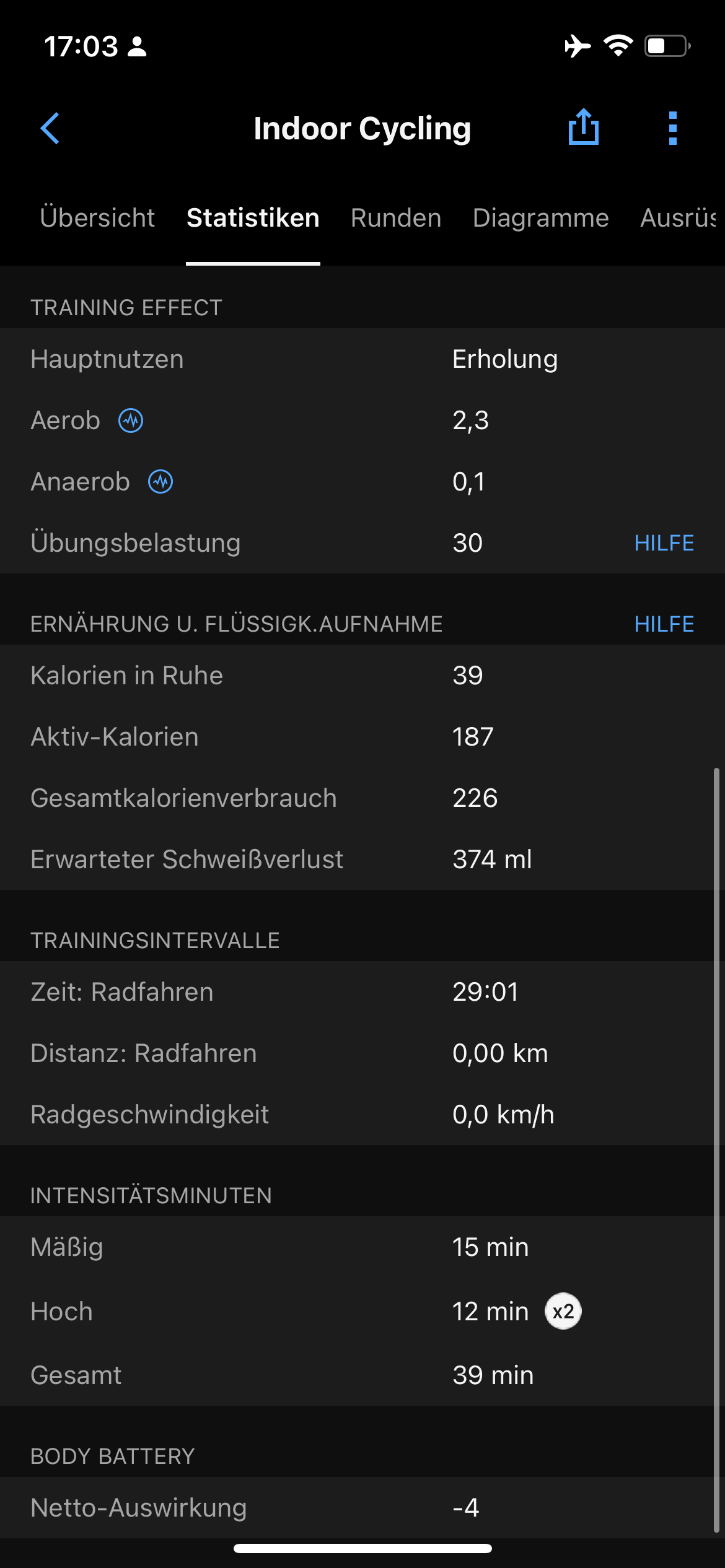

was there a change to the system? Up to some weeks ago it worked to get the Training Effect data in combined files. Now I did the combination as usual but in Garmin Connect the training effect is not showing in the activity anymore.
Also stamina and intensity minutes are missing in the combined file.
I attached the overviews like I see them in Garmin Connect.
Thanks,
Thomas
Thanks,
Thomas

I'm not sure how to change this setting, as my 2 Garmin accounts (my personal account and my test account) do not do this override. My guess is that it has to either do with a setting in your Garmin Account... or perhaps even your geography - maybe certain accounts are treated differently depending on where you live? Just guesses to explore.
Thanks for your fast reply.
I opened a second account with the same result. It doesnt import stamina, training effect etc. I found in the fit file viewer that my clock a fenix 7 is not inserted in the device info fields. Maybe this is the culprit. In a activity from April 28th, that included the training effect data, my watch is showing in the acitivity but not in the one I combined an uploaded today.
What can I do to include my watch correctly in the combined file? After importing the two files the watch is showing as well as the serial number and the software version.
Upadte:
I now have to change the "GPS Type in Output File:" to my watch manually. Then at least trainings effect data are showing again in Garmin Connect (although with the slighty different calculation after upload). Up the last time I used GOTOES end of April, it automatically took my watch as "GPS Type in Output File:" and not my indoor bike. Now I have to adjust this before combining the files.
Guys - I have verified that this: Garmin will override FIT Training Load / TrainingEffect / Benefit if you include heart rate. Basically, Garmin is re-calculating these factors from the heart rate and IGNORING the values that GOTOES puts into the fields.
https://support.garmin.com/en-US/?produ ... tab=topics
Temporary work-around:
Thanks!
Thanks!
Yes, yes! Either Garmin Connect is slowly releasing this “feature” to the public… or maybe there is a setting that we can change in our accounts? I do not know.
I will tell you this:
People in Europe noticed it first. I could not replicate the issue with either of my two USA based accounts. I haven’t looked at the problem since May, but I could not replicate the issue in May either. Now, today, I can replicate the issue… so my account is also ignoring the TE/TL/BE starting recently. I have two accounts - a “real” account and a “test” account. Check this out: In my “real” account, Garmin does the override. In my “test” account, Garmin does NOT do the override. So maybe it has something to do with the frequency of use… or an accumulation of heart rate data? or maybe Garmin recalculates if you submit from your non-primary tracking device? In my test account, I am loading files from people around the world. If you can figure out how to prevent Garmin from automatically recalculating, you’d be a hero to many! If you want to prove this to yourself, make a "test" Garmin Connect account, and upload a file from GOTOES. You will see that TE/TL/BE are all exactly the same values you specify in GOTOES.

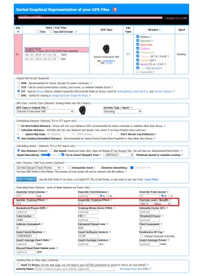

Update Dec 4, 2024:
Hi guys - today a user wrote to me and said that if he omits the Garmin Device name, Garmin will not re-calculate the two training_effect values. Leaving out the Garmin device name would be better than leaving out the heart rate stream. If you do this, though, your activity will not count towards any Garmin Challenges. I highly encourage you to write to Garmin and ask them for the OPTION to have Garmin Connect re-calculate Training_Effect based on Heart Rate. In other words, give users a choice to either use the Training_Effect values in the file OR re-calculate based on heart rate.
As an aside, you might also be able to leave out the Garmin Serial Number. I have not tested this myself. If you leave out the Garmin Serial Number, again, your activity will not count towards any Garmin Challenges. Please note that I get questions about this 3x per week, so if everyone writes to Garmin, hopefully we can get this resolved.
