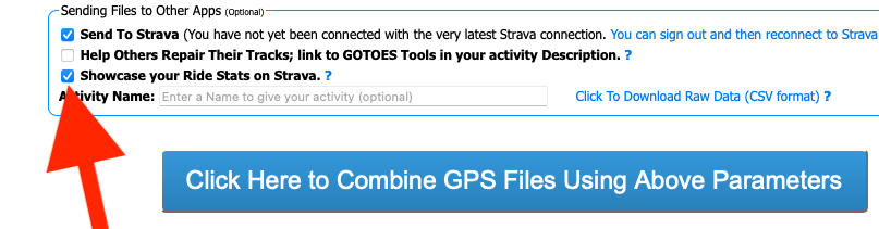

So, I added a new checkbox that arrives if you upload a file that has data that I've figured out how to "showcase" on Strava. This is that checkbox:
If you check the "Send to Strava" Checkbox AND your files have some data that can be showcased, you will get this checkbox that allows you to display the data in the "description" field on Strava.

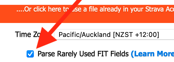

To make this work, you will want to be sure that you include "Rarely Used Fields" when reading-in your source FIT file(s) to GOTOES:
Make Sure you check the "Parse Rarely Used FIT Fields" checkbox when you import FIT files into GOTOES.
In order to see the checkbox, these conditions must be true:
  • You need to check the "Parse Rarely Used FIT Fields" checkbox when importing your FIT files to GOTOES.
  • You must be exporting as FIT file format from GOTOES.
  • You must have the "Send to Strava" box checked.
  • Your loaded files must have data to showcase. So far, that is Grit, Flow, and Jumps.

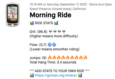

Here is what the data will look like on Strava if you elect to add this extra data:
This is what the extra data will look like once you upload to Strava.
