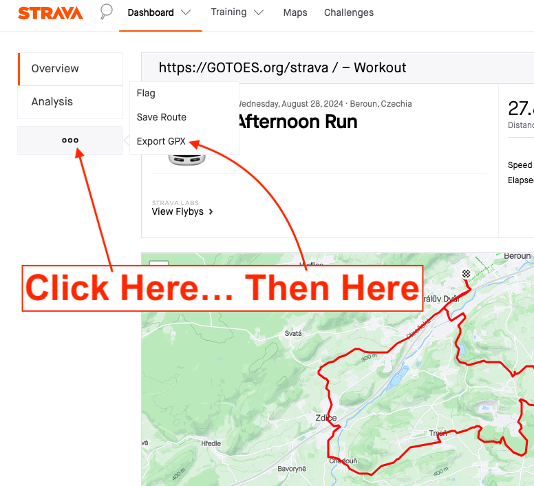

Find the other person's activity from which you want to create a Strava segment. Click the three dots, then select "Export GPX."

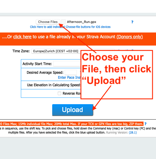

Take the resulting GPX file and upload it to GOTOES here: https://gotoes.org/gotoes/strava/Add_Timestamps_To_GPX.php
The reason you need to use GOTOES is because the file you get directly from Strava does not have timestamps. This means that it will not look like a "real" activity to Strava. By adding timestamps, you will be creating a temporary "real" activity in your own account. You do not need to change any of the settings on the page above, just choose the file and then click the big blue "Upload" button to go to the next page. The default settings will work fine for this purpose.

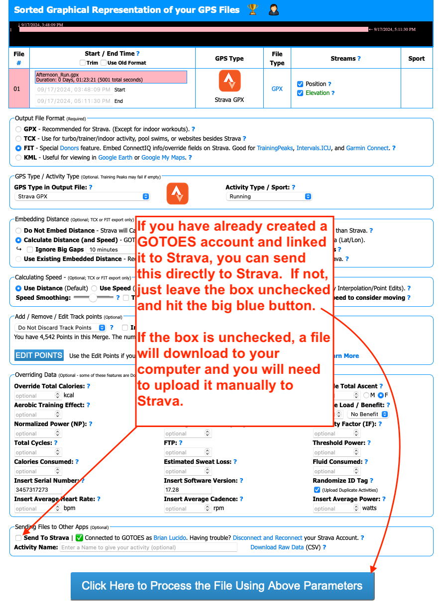

On the next page, scroll down to the bottom. If you have a GOTOES account, you can check the box that says, "Send to Strava". If you don't have a GOTOES account, you can leave that box unchecked, and a file will just download to your computer. At this point, you should click the big blue button that says, "Click Here to Process The File Using Above Parameters"
