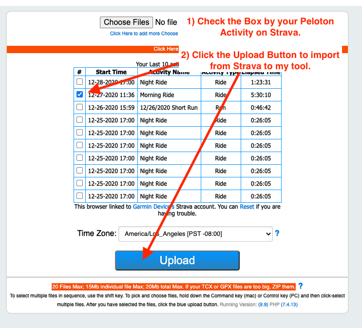

3) Check the box(es) for the activities you want to take from Strava to Training Peaks
4) Click the Upload Button.

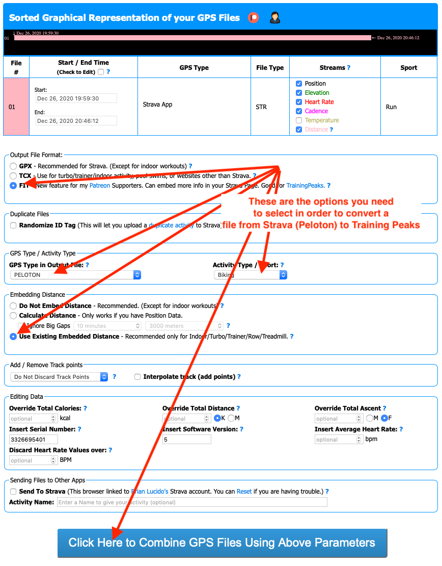

5) On the next page, make the following selections:
- "FIT" under "Output File Format"
- "Peloton" under "GPS Type in Output File"
- "Biking" under "Activity Type / Sport"
- "Use Existing Embedded Distance" under "Embedding Distance"
6) Make sure that "Send to Strava" is not checked, and then click the button that says "Click Here to Combine GPS Files Using Above Parameters"
7) A FIT file will appear in your downloads. Upload that file to Training Peaks!

Here is how to Transfer a PELOTON activity directly from Strava to the GOTOES App.  In the second step, we will prepare the file for export to Training Peaks.
Here are the settings to repair a PELOTON file for use in Training Peaks.
