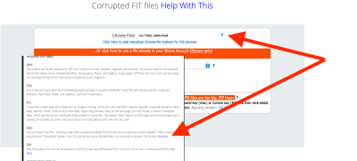

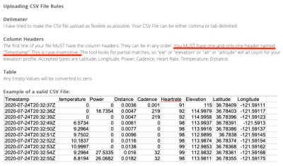

My site does have information on how to upload a CSV with the proper format. That can be found by clicking on the question mark near the upload button. There are also other question marks that you can click that reference this. So you can see, I have added a screen shot:
How to get help with uploading CSV files to convert to GPX
How to format CSV uploads to convert to GPX

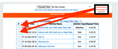

Once you sync your fitbit with Strava, you can then go into my tool and check the boxes for each activity. To be totally clear, I made a mock-up screen shot displaying how you might combine a GPS track with a fitbit heart rate activity:
How to merge FITBIT Heart Rate data with a GPS track
Once you get to the second page on my tool, make sure that the box saying "Randomize ID Tag" is checked. That will enable you to upload a duplicate activity (because this new merged track will be a duplicate of the stuff you have already loaded; only difference is that the heart rate and GPS will be merged).

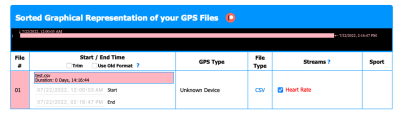

I took the file you sent me, and I opened it with Libre Office. Next, I noticed that the first header was "Date & Time" so I changed it to "Timestamp" (as indicated in the FAQs that I mentioned to you earlier in this thread). Next, I selected "Save As" and saved as a CSV file. I imported this to my tool and it worked. Please see screen shot below.
Uploading CSV Heart Rate File from Fitbit to merge with GPX file.
One thing I noticed about the time stamps in that file is that they begin at midnight (UTC). So, unless you did happen to start at midnight UTC, you might also have to do a time-shift. I'm not 100% certain because it is possible that you just exported your heart rate for the entire day. If that is the case, then you might not have to time-shift. I do have another tool that allows you to align time.
So, with the CSV file, all you have to do next is upload the GPX file along with this one and merge them. If you upload two files, you will get a button that is named "smart trim" - and if your GPX activity fits "within" the heart rate file, it will trim them down so you don't have to.
