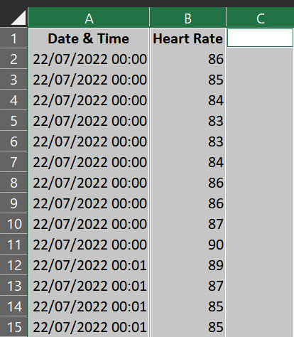

ive added what it looks like when its exported using that site because as far as i can find there is NOTHING else that will export Fitbit heart-rate from either a GPS-less activity or straight from fitfit at all for that matter, tho the site does only suck it right from fitbit so would need manual cropping or the site to dismis most of the tracking points and match it up with an actual activity downloaded from say strava

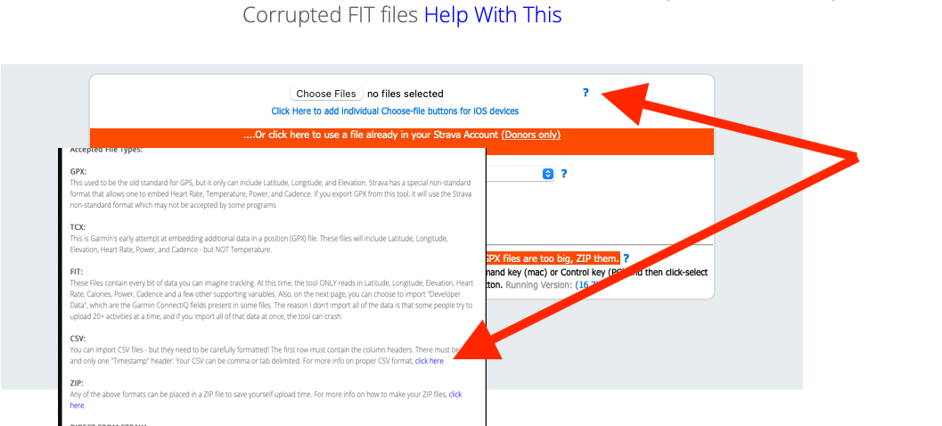

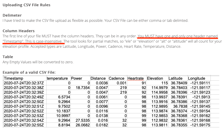

My site does have information on how to upload a CSV with the proper format. That can be found by clicking on the question mark near the upload button. There are also other question marks that you can click that reference this. So you can see, I have added a screen shot:

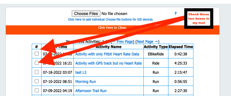

Once you sync your fitbit with Strava, you can then go into my tool and check the boxes for each activity. To be totally clear, I made a mock-up screen shot displaying how you might combine a GPS track with a fitbit heart rate activity:
Once you get to the second page on my tool, make sure that the box saying "Randomize ID Tag" is checked. That will enable you to upload a duplicate activity (because this new merged track will be a duplicate of the stuff you have already loaded; only difference is that the heart rate and GPS will be merged).
I hope that this solves your issue without having to resort to more complicated solutions with file conversions to CVS, export, etc.

So, let's go back to Plan A: I'm going to need a CSV file so I can test. I see you posted a screen shot of the CSV above, but you will need to send me a CSV file so I can give it a go. I think that I will try to implement "native support" for the export that you provide - but that MIGHT NOT be possible (I don't want to override any other CSV import types)... but if there are enough unique identifiers, my hope is that you will be able to dump a CSV file directly from that app into my tool. I need the file to do this, though. As I said above, direct contact is best, but you can also upload a CSV to this forum.

Nothing special in the file so im gonna put it here incase anyone wants to figure out what im talking about, but if you do want me to start using direct messaging i can
here is what gets outputted when you use https://exain.com/fitbit/
its an XLS file so would require another file format to be accepted alternativly the site could ask that XLS is converted to some other format and that be used instead
i had to put it in a zip file cus XLS isnt supported for attaching
im hoping it could be done by exporting as CSV with a name change from Date & Time to timestamps or something if XLS cant be added

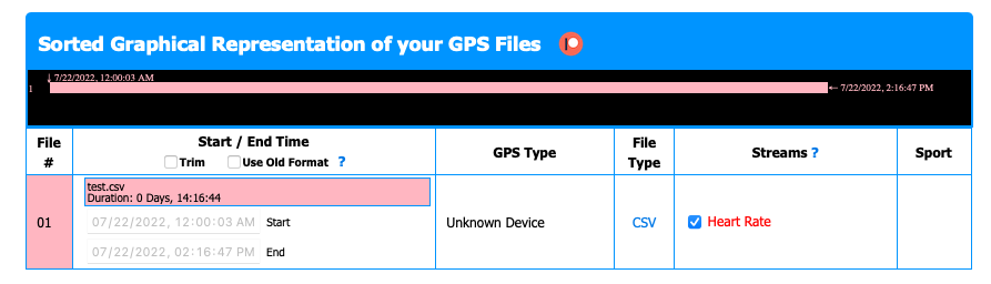

I took the file you sent me, and I opened it with Libre Office. Next, I noticed that the first header was "Date & Time" so I changed it to "Timestamp" (as indicated in the FAQs that I mentioned to you earlier in this thread). Next, I selected "Save As" and saved as a CSV file. I imported this to my tool and it worked. Please see screen shot below.
One thing I noticed about the time stamps in that file is that they begin at midnight (UTC). So, unless you did happen to start at midnight UTC, you might also have to do a time-shift. I'm not 100% certain because it is possible that you just exported your heart rate for the entire day. If that is the case, then you might not have to time-shift. I do have another tool that allows you to align time.
So, with the CSV file, all you have to do next is upload the GPX file along with this one and merge them. If you upload two files, you will get a button that is named "smart trim" - and if your GPX activity fits "within" the heart rate file, it will trim them down so you don't have to.
Hope that helps!
