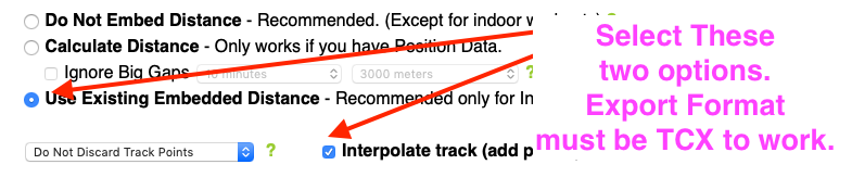

Try using TCX export and then selecting to use embedded distance (one of the options on the 2nd page). This uses the distances in your original files. This will only work with FIT files imported (and most TCX if they have distance embedded). It will not work if you import GPX because GPX doesn’t have anywhere to store distance.
The problem with average speed is that Strava has their own “minimum speed to be considered moving”. Strava re-interprets every upload, so there might be small differences; usually not enough to matter.
Also, you may want to try the "Interpolate track (add points) " option.
