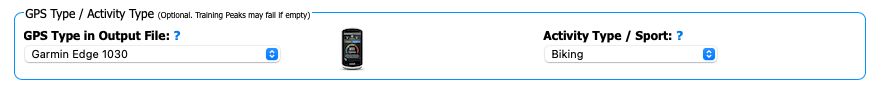

  • Was this an indoor workout with a map? If so, you need to select "Zwift" (or other indoor trainer as your GPS type) and "Virtual Ride" as your Activity Type when you export from GOTOES.
If you use the Zwift (or Peloton or FulGaz, Rouvy, or Wattbike, etc..) selection... along with "Virtual Ride," this will tell Strava that it was an indoor workout and Strava needs to use the time zone in your profile instead of trying to calculate your time zone from the fake GPS coordinates in your activity.

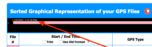

Gotoes has a time zone drop down menu, but for GPX and TCX the only purpose of the selection for loaded GPX/TCX files is so that when you get the sorted, graphical display of your loaded files, you can see the time in a familiar time zone.
Your selection of Time Zone controls the time displayed here.  However, when you export as GPX, TCX, or KML, the timestamps are still recorded in UTC (the time zone at the prime meridian).

**When you select the GPS type in GOTOES, you're telling also telling Strava a little about if your recorded activity was real or virtual. This can have an impact on your activity start time:
If you select a regular GPS in GOTOES for an indoor trainer workout recorded with a map (like Zwift), expect to get a weird time zone on Strava! This is because Strava will see the map and think you really were riding on some island in the South Pacific!
