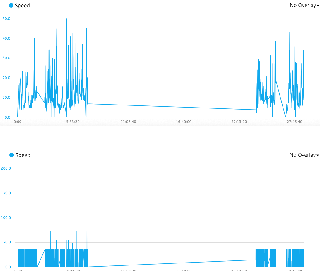

Unlike Training Peaks and Strava, Garmin Connect, still respects the speed values in the original file. Below is a screen shot of a file with speed smoothing (top) and no speed smoothing (bottom). Notice how in the bottom capture, there is a point that shoots up to nearly 200mph. By using smoothing, we can eliminate this errant point which is messing up the scale of the graph tremendously.

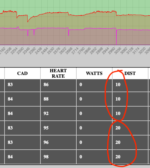

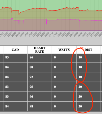

Some GPS devices do not record distance with a fine granularity. If that happens, you will get a lumpy speed graph when using GOTOES to process your file (although it will be better if you have smoothing turned on). Here is what that might look like in a table if you select the "Edit Points" tool in GOTOES:
Each row in the table represents one second.  Notice how the distance traveled in the source file is the same (10 meters) for the first 3 seconds. Then it jumps up to 20 meters all of a sudden, and stays there for another 3 seconds.  This is what causes &quot;lumpy&quot; speed graphs.
Each row in the table represents one second. Notice how the distance traveled in the source file is the same (10 meters) for the first 3 seconds. Then it jumps up to 20 meters all of a sudden, and stays there for another 3 seconds. This is what causes "lumpy" speed graphs.
The above is a problem with GPS source files - but it can be overcome by telling GOTOES to calculate the distance for you. If you select that option, GOTOES will calculate the distance between each position point (latitude and longitude) and discern a very fine granularity of distance (and thus speed) for each time frame. You can still use the speed smoothing slider option to apply smoothing to the GOTOES algorithm; these features work in tandem.
