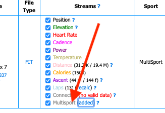

In some instances, you will be given the opportunity to add data from your original file into your export. Notice how it says, "added" next to "Multisport":
Adding Extra Data to your GOTOES FIT FILE export

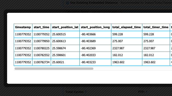

Once the extra data has been added to your potential export, you can view it by clicking the link that says, "added":

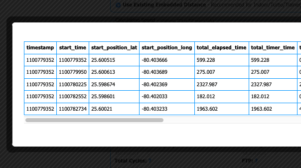

A new window will pop up showing you the RAW data that will be added to your FIT export

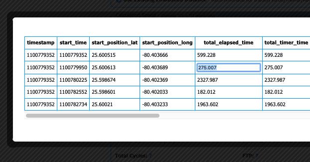

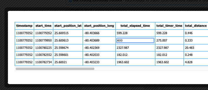

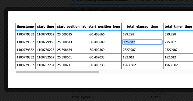

You have the option of editing any of these fields. I don't recommend doing this unless you REALLY know what you're doing. Note that currently only numeric fields can be edited. Any characters other than the numbers "0-9" and "-" and "." will be removed from your input. This is to prevent you from accidentally corrupting your files. To make an edit, simply click on the number you want to edit, and an edit box will appear:
Editing a FIT file data entry on GOTOES

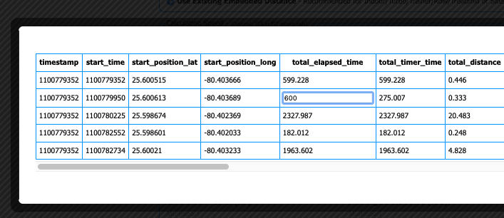

Changed the value to 600....

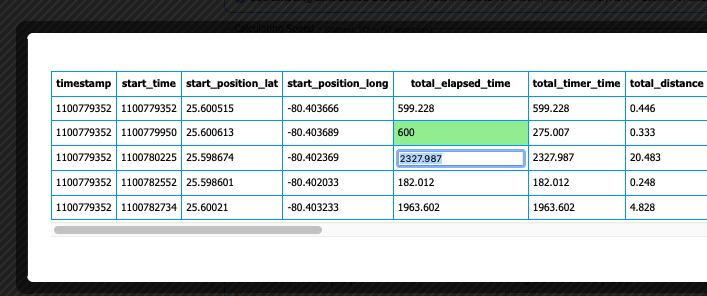

Once you have made the desired edit, either click-away, use the tab key, or use the enter key to leave the box. Upon exiting the box, the value will be saved, and the table cell will turn green - indicating that the new value has been saved.
Successfully edited a FIT file using GOTOES.
Please note! Changing individual values can immediately corrupt your FIT export. For example, if you are editing a multisport activity, and you put the same timestamp in twice, you will end up with a useless export. Alternatively, if your leg durations do not match your timestamps (don't add up), again, the file will be corrupted. So, you need to use this manual editor with care!
