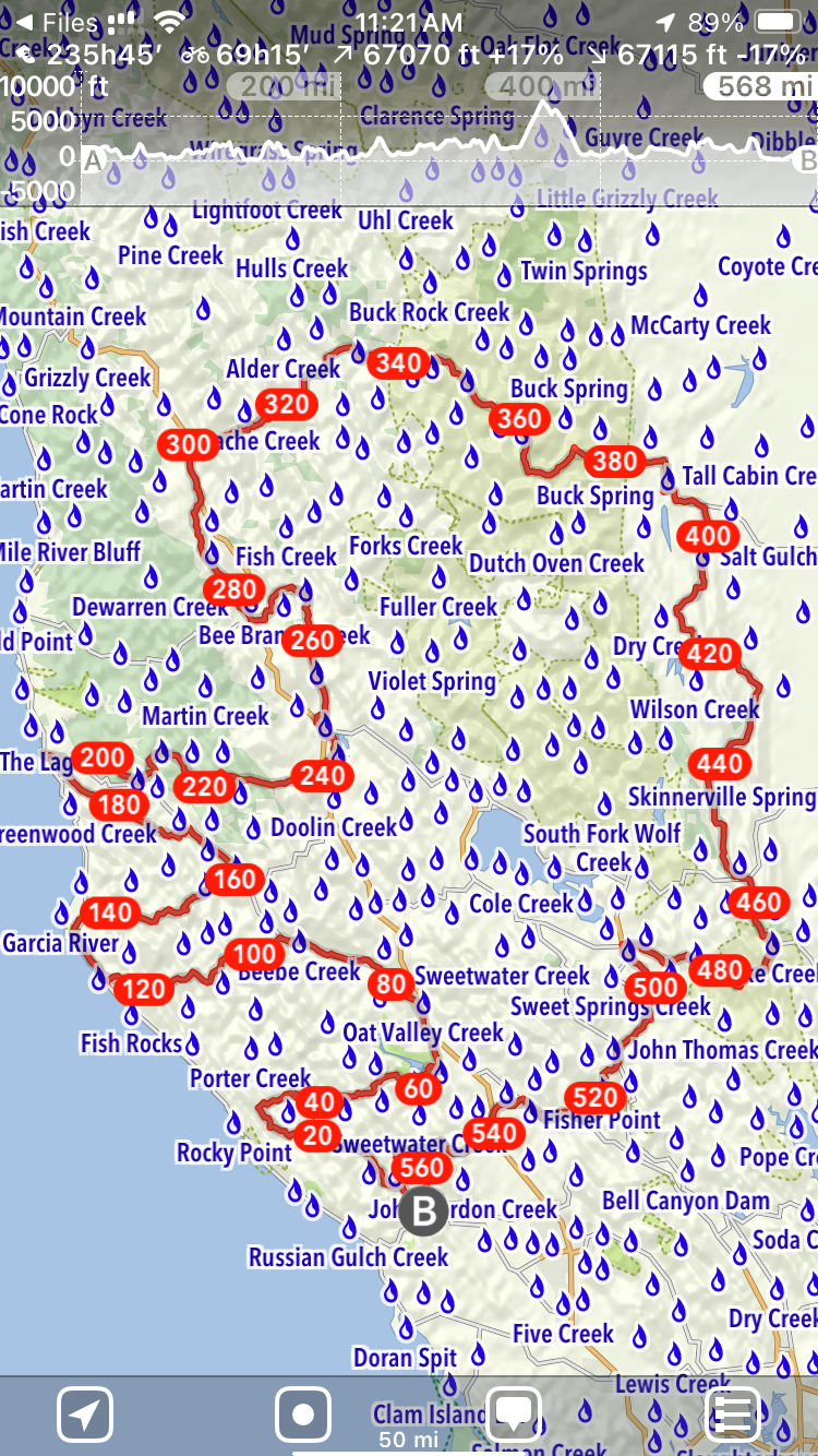

BEFORE using the GOTOES Waypoint Filter

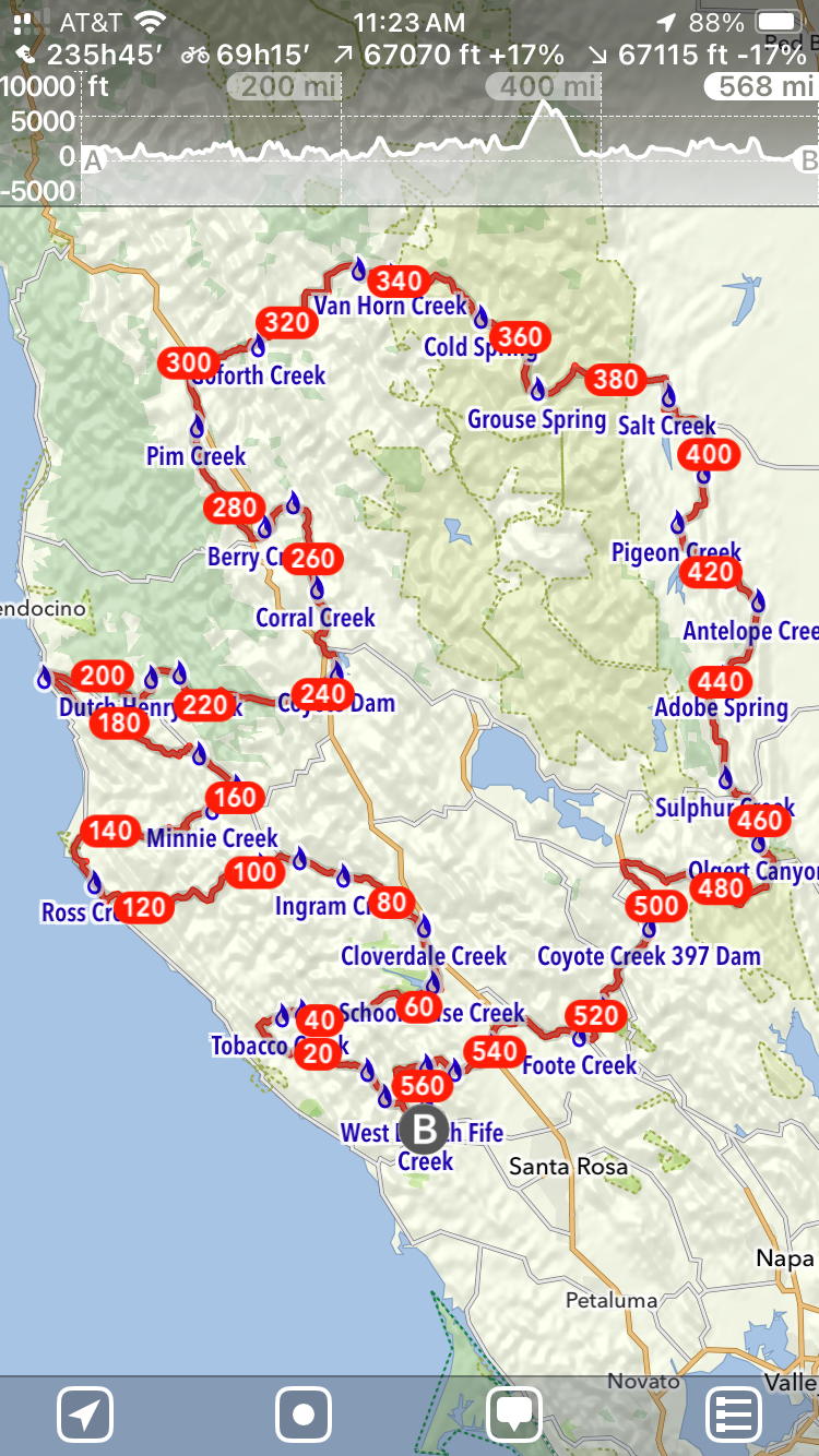

AFTER using the GOTOES Waypoint Filter
