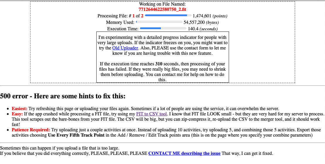

Let's say you upload a FIT file to the merge tool, and you get a crash screen like this:
If you get a 500 error like this, maybe you need to convert your BIG FIT File to a CSV file.
The 500 error with a FIT file is a signal that you may have too much junk data embedded in your FIT file for my tool to parse it all out. You may have noticed that FIT files are very small in size (something like 1Mb sometimes). The resulting CSV file would actually be quite large (maybe something like 14Mb). How could a CSV file be better than a FIT File?

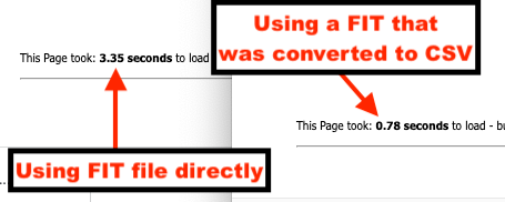

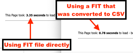

Check out the difference in time between uploading a FIT file directly vs converting it to CSV first!
