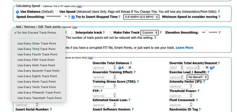

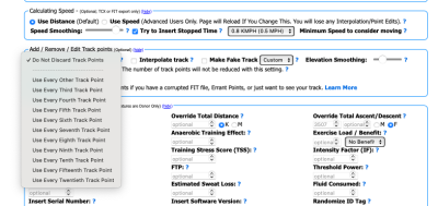

Strategy 4: Remove Excess Points
A lot of people like to use 1 second recording to get "All the Data". 1 second recording is great for your 5 hour bike rides, but if you're doing an ultra-marathon that takes 24 hours or trying to merge a bike ride across a country, 1 second recording is just too much for my tool (and it is too much for Strava to display their maps correctly). If you're trying to merge files that have just too many points, you can upload them one-at-a-time to the tool and use the "Discard Track Points" Feature, and then re-export the files (see screenshot below). Don't worry: if you have a point every 5 seconds instead of every 1 second, it will still look great on Strava. After you shrink and export all of the files, you can re-import them for a merge and they should process much faster. Remember that you can combine Strategies 1 and 2 with this Strategy 3. I have a discussion on discarding extra trackpoints here

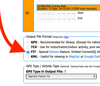

  • Export as FIT (fit is a smaller overall file size than GPX, CSV or TCX but will keep all of your points)
  • Discard Trackpoints (see screenshot below) - and then export as GPX, TCX, or FIT.

How to discard GPS trackpoints to make your file smaller
FIT files are smaller - but much more intensive to process.  IF your issue is merely file size, exporting as FIT can help
Screenshot 2025-12-11 at 7.33.57 AM.png (33.16 KiB) Viewed 14430 times
