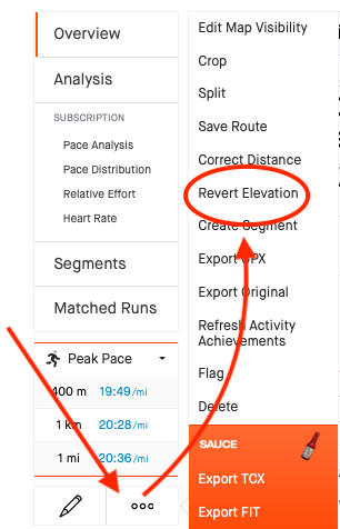

If Strava has "corrected" your elevation, you can undo it (see image from Strava Activity Page below). You need to click the 3 dots and then click "Revert Elevation Correction" or "Correct Elevation".
How to revert corrected elevation on Strava

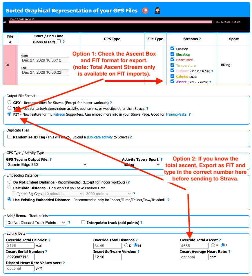

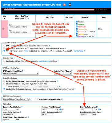

3. GOTOES TO THE RESCUE: Override the GPS Elevation!
You can override the totals ascent shown on Strava directly from my tool. To do so, you need to export from the tool as FIT, and then include the elevation by checking the "Total Ascent" in the Streams. Strava no longer respects total ascent in TCX files, and there is nowhere to specify total ascent in GPX files. Note that exporting FIT files from my tool is a feature only available to Donors.
If your file doesn't have Total Ascent already embedded (for example, you uploaded a GPX file instead of a TCX or FIT file), then you can select the "Override Elevation" option and insert the total ascent in the box labeled "Override Total Ascent." Make sure you also check the green "Elevation" Stream, as Strava is now looking for the individual data points as well.
Also, if you uploaded an INDOOR / TRAINER WORKOUT, you can use the "Create Fake Track" checkbox to override elevation on activities that do not have location data (latitude / longitude).
How to make Strava show the correct elevation / Total Ascent.
