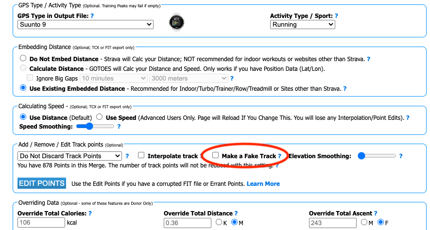

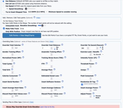

Your question inspired me to add a new feature: A checkbox called "Make a Fake Track"
How to override elevation on Strava when you have an indoor workout.

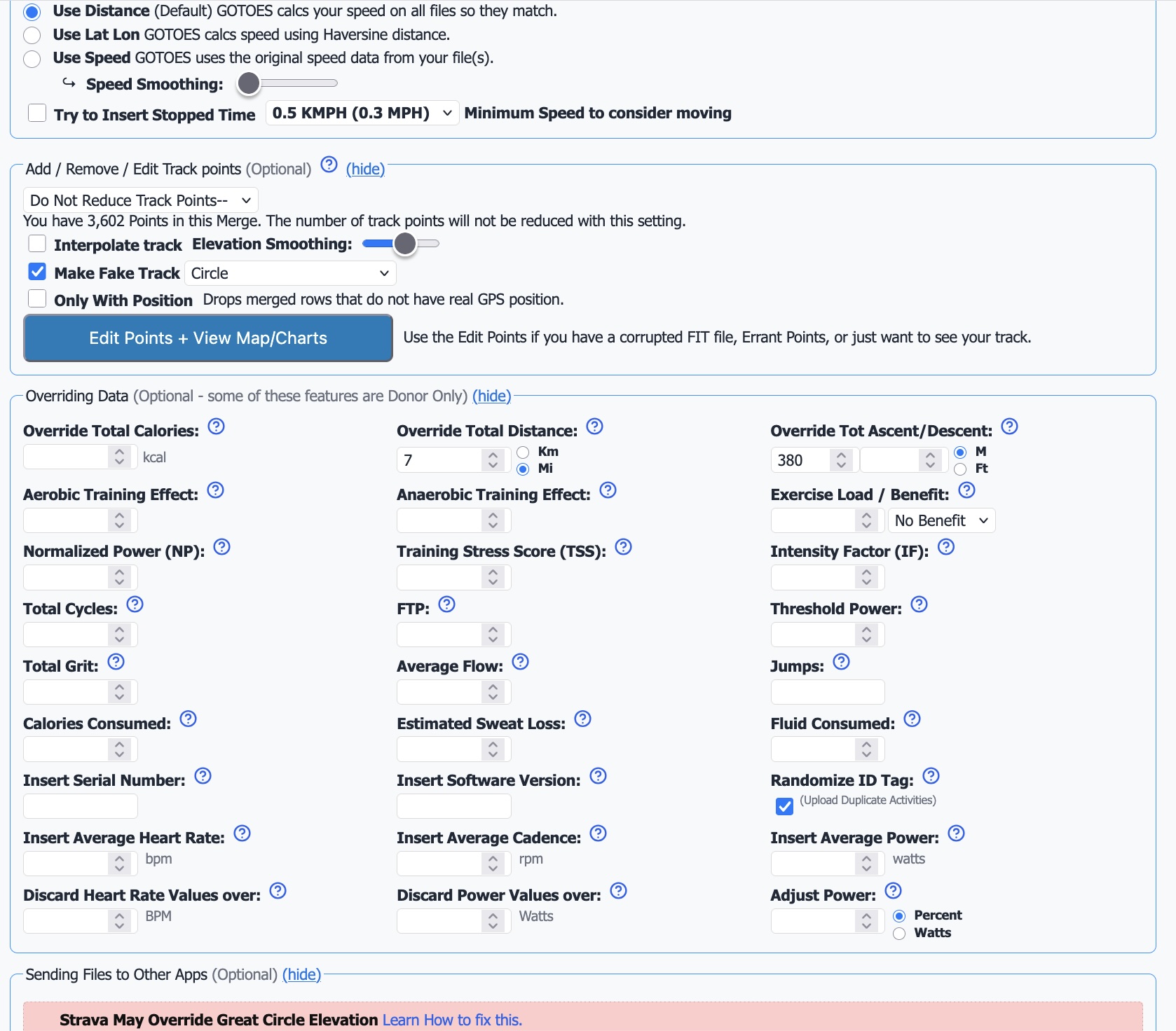

You will only see the "Make a Fake Track" checkbox if the files you uploaded have distance data. This is because GOTOES needs your distance to compute your position over time. If you do not have distance, but your files do have speed, you can click the "Use Speed" instead of "Use Distance" and the page will refresh - backfilling the distance field for you.

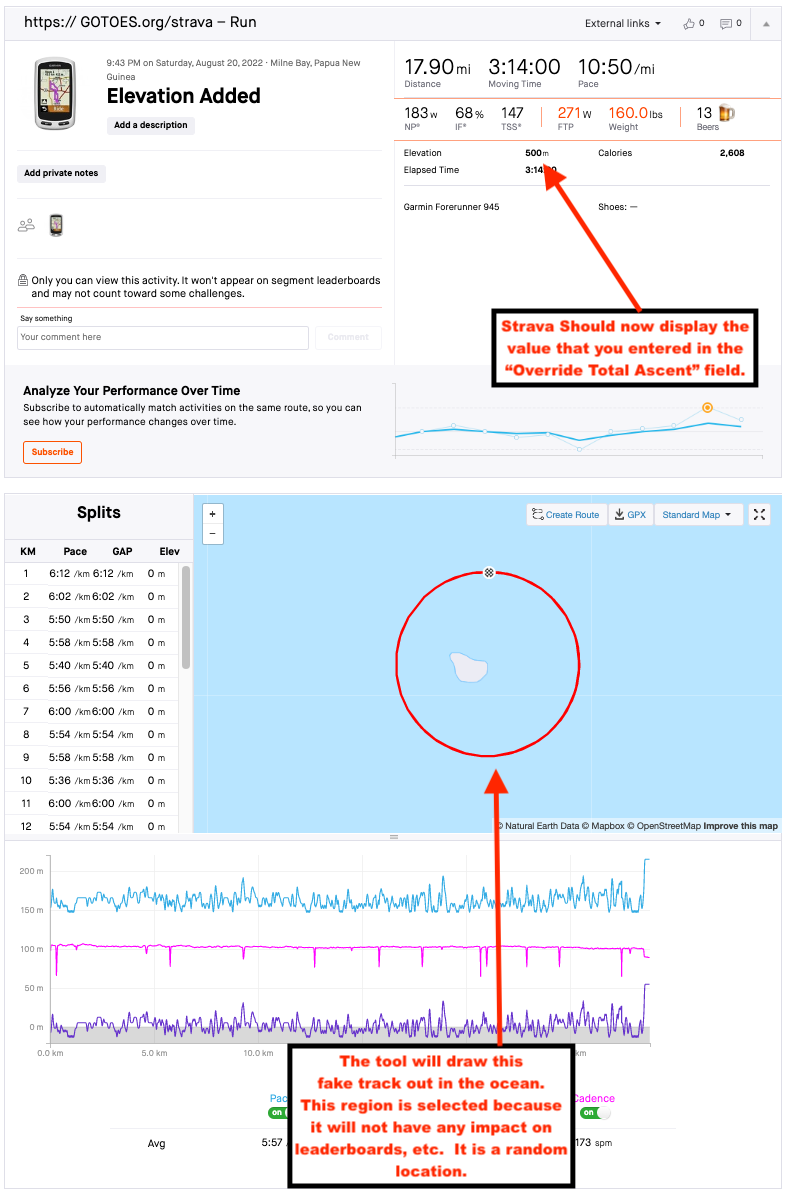

If you check the "Make Fake Track" box, by default, the tool will create a track which is a 1 kilometer circle out in the South Pacific. You will continually go around and around the circle, depending on how much distance you accumulated in your activity. The elevation plot will be flat if the elevation is missing from your file, but you can now enter a number in the "override elevation" checkbox to get a total ascent value in your final file. You also have the option of uploading a custom GPX file to substitute and back-fill position data for your GPS activity file.
Here is what it will look like if you use the circle (default) method:
Uploading a virtual activity or treadmill activity to Strava may not show elevation / total ascent.  This is what it looks like before modification with the "fake track" tool.
Here are the recommended steps / settings if you need to override the total ascent from your virtual ride / run

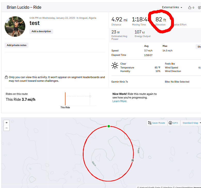

What your upload to Strava will look like after you have made the modifications above.

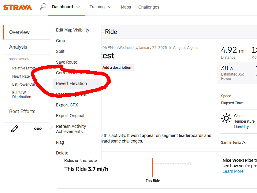

Step 1: Make sure that you exported from GOTOES as FIT and not TCX or GPX (GPX does not support total ascent, and TCX is not "trusted" by Strava). Also, make sure that the device you selected when exporting from GOTOES is a barometric device. For example, the "Garmin Fenix 6" has a barometer and is "trusted" by Strava. The "Garmin Edge Touring" is NOT a barometric device, and will therefore have its elevation overridden by Strava no matter what.

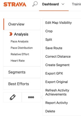

Step 2: Go to the 3 dots and select "Revert Elevation"
Select Revert Elevation.  If you have the option to Revert Elevation, that means Strava did an override anyway.
Step 3: Click the button that says "Revert Elevation"
Next click the button to accept the elevation reversion.
Step 4: Now you will see that Strava will display the GOTOES assigned elevation. Strava is always eager to override your elevation, so this is how you can overcome that.
Back to 82 feet of climbing after Strava calculated it to be 297 feet.

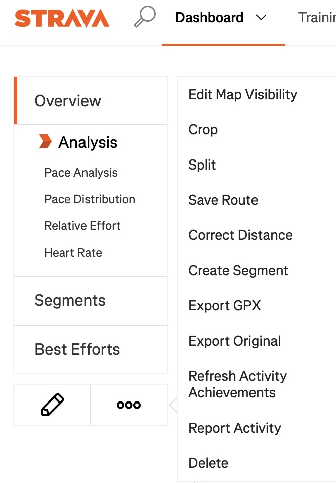

Thank you for the great explanation, however I don’t have an option to „Revert Elevation“.
I simply downloaded files from Strava and reuploaded them jointly loosing elevation. Hence I would like to reset.
Re: Overridden Elevation not shown on Strava
Good question about the "Revert Elevation" What device are you using/specifying when you do your upload? Strava treats devices differently. If you tell Strava that you're using a device with a barometric altimeter (Say a Garmin Fenix 6 for example), then Strava should give you the option to "Correct Elevation" as well as "Revert Elevation." If you use a non-barometric device (Say a Garmin Edge Touring), then Strava will always override any elevation supplied by the device and re-calculate. This is because Strava has decided that non-barometric (GPS based) altimeters cannot be trusted. Most phones are "not trusted" for example. Anyway, you can use GOTOES to tell Strava that you're using a barometric device. This is called "spoofing" the device type. If you do that, and export from GOTOES as the FIT format (not TCX or GPX), then I would expect that Strava will respect your wishes and elevation changes rather than override them.

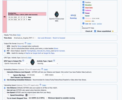

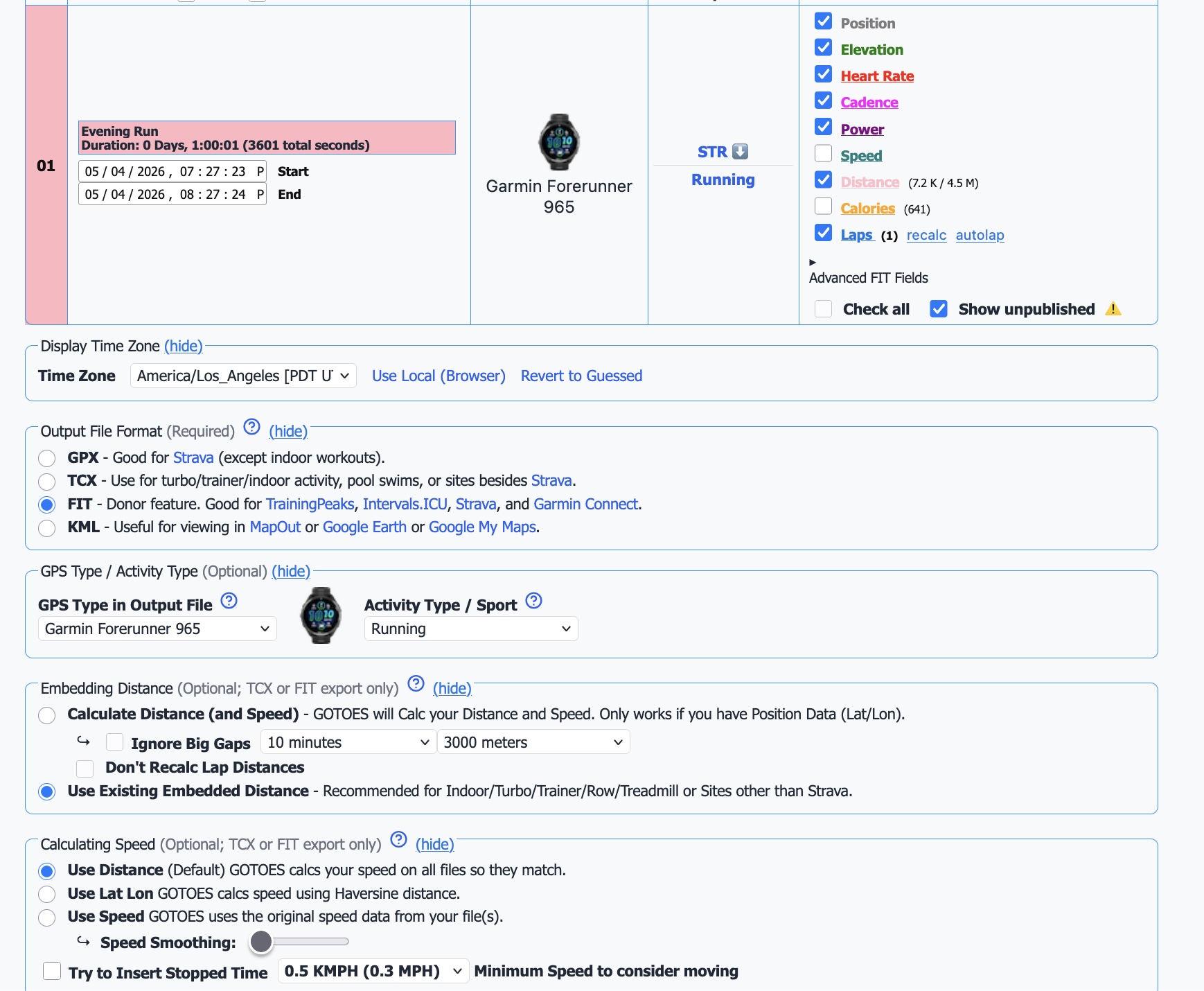

Interestingly, this worked once for me, and now I am also not seeing the "correct elevation", despite trying with Forerunner 965 and Fenix 5X. I thought that I followed all your steps, but maybe you can see something that I am missing?
Re: FAQ: How to make Strava show elevation from trainer / indoor workouts (solved)
Hi Tommy -
Did you ever get this figured out? I just tested in my Strava and I DO see the "correct elevation" option... It appears you did everything correctly.
