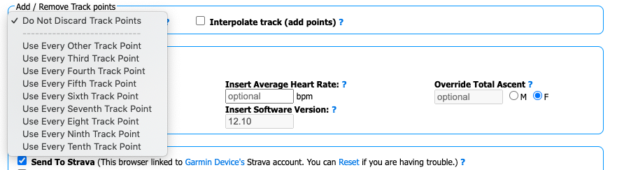

The solution to this is to use the "Discard Trackpoints" feature. This happens often when you have One Second Recording turned on your GPS for a very long activity. The default setting is called Smart Recording, which only records trackpoints when necessary. I recommend that you leave your GPS on Smart Recording, but if you have already recorded an activity using One Second Recording, Please use the feature to discard track points.
The option to discard trackpoints is in the "Add / Remove Track Points" area. You can discard up to every 10 trackpoints. See image below.
