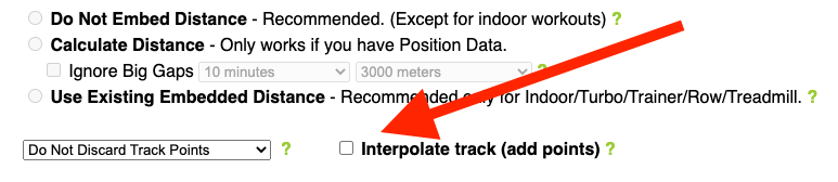

Also, I recently added a feature where you can Interpolate Track (add points). This will put a point in every second. Selecting this option may also fix the swim time so that the moving time matches the elapsed time. See image for where this option is in my tool.
