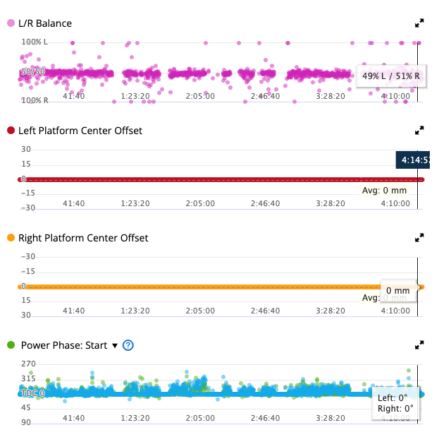

Last week, I added the option to read extra data fields from your FIT files (and subsequently export them into your output FIT files). Please note that these fields are NOT displayed on Strava - so if your only platform is Strava, you can stop reading here. If you use Garmin Connect, Training Peaks, or some other data analysis software, here are the additional fields I added last week:
accumulated_power, left_right_balance, vertical_oscillation, stance_time_percent, stance_time, left_torque_effectiveness, right_torque_effectiveness, left_pedal_smoothness, right_pedal_smoothness, fractional_cadence, left_pco, right_pco, left_power_phase, left_power_phase_peak, right_power_phase, right_power_phase_peak
Here is what your Garmin Connect Activity Page will look like if some of these additional fields have been included.

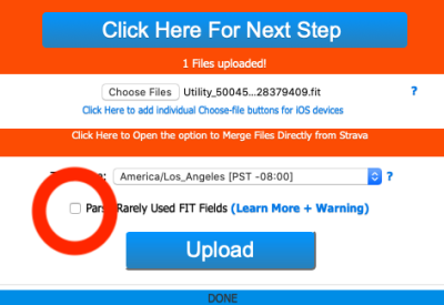

PARSE RARELY USED FIELDS
Where to click if you need to include any of the additional data fields mentioned above.

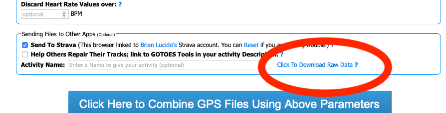

In the image above, you can see the checkbox that lets you read-in additional fields to your merge. They will be read into memory, and once you get to the merge page you can even see them if you click the "Click to download Raw Data" link. The data is in tab-delimited format, so best viewed in an app like Excel, Google Sheets, Apple Numbers, or Open Office. The only reason you'd want to check the box above, though, is if you're going to be exporting in the FIT format. If you plan to export as GPX or TCX, there is nowhere to embed that type of information, so it will simply be discarded.
You can see your "extra data fields" in raw format by clicking this link on the download page.
