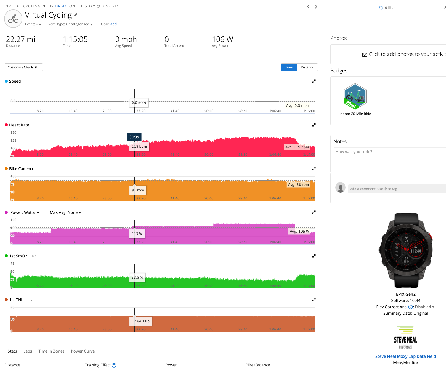

It seems like Garmin is a little picky about this. Garmin Connect WILL show the data if you specify in the GOTOES tool that the data is from a Garmin Device. But, if you select a non-Garmin Device, Garmin Connect will not show the ConnectIQ data - even if it is embedded in the file. Please see the two screenshots below for a demonstration:
Uploaded to Garmin Connect as "Garmin Epix Gen2".  Notice how the ConnectIQ fields are correctly displayed after the merge.

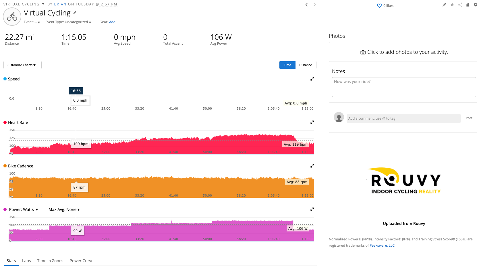

Uploaded to Garmin Connect as "Rouvy" (a non-Garmin GPS type).  Notice how the ConnectIQ fields are not displayed after the merge.
