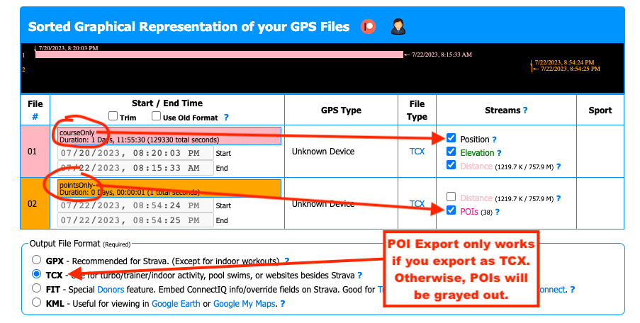

Here is how it works:
  • Upload any combination of GPX / TCX files that contains a track, just waypoints/coursepoints, or both. The tool tries to flexibly handle any of these conditions.
  • Once the files are uploaded, you should see the normal graphic representation of your track/courses and a new representation of your POIs (a checkbox in the streams area saying "POIs" with the count of the number of POIs detected).
  • Check the streams you want to include - maybe a position stream from one file, and a POI stream from another.
  • Make sure you have selected "TCX" as the export type - otherwise, you won't be able to select any POI streams.
  • Process the files with the big blue button at the bottom. This file should be able to be imported into a GPS to give you turn-by-turn directions.
An example of combining one file that contains just a route (course)... and another file that contains only POIs (waypoints).

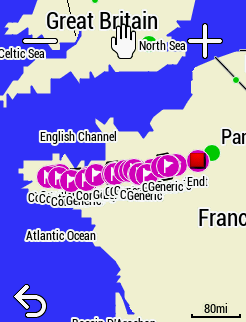

Next, you will want to load this course file into your device. For a Garmin, you do that by connecting your device to a computer, and then drag the file into the "NewFiles" folder. When you unplug the GPS, you will get a map of the ride with your POIs shown like the image below:
What a POI course looks like in a Garmin. Many modern GPS devices support this type of file, but I only own a Garmin for this type of testing.
When you navigate this course, you should receive turn-by-turn directions where a notification pops up on your screen before the next course point. Course points can notify you about things to see, stores, turns, and road hazards... they don't just have to be direction-related.
