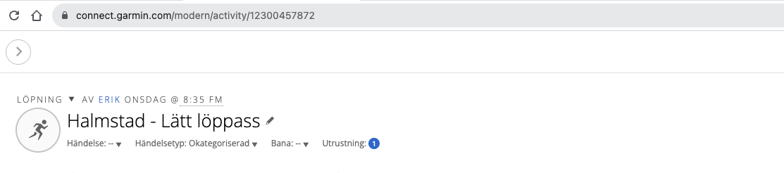

Ok let me explain. The file 12267589385.... Is the correct on. When I upload that in to Garmin connect I get it logged as ...../modern/activity/12300457872
When I merge all the files I get another activity number and it will be logged as an activity in Garmin Connect but not in Garmin Coach training plan.
