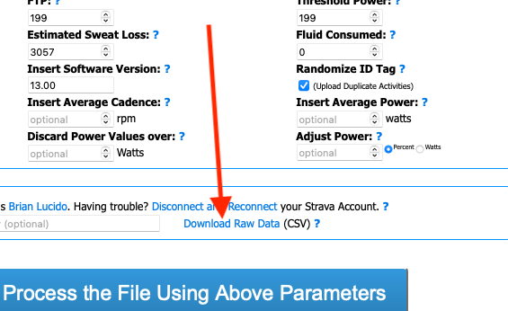

Step 1
Upload your FIT / TCX / GPX / CSV file to GOTOES here. Once your files is uploaded, go to the bottom of the second page and click "Download Raw Data"

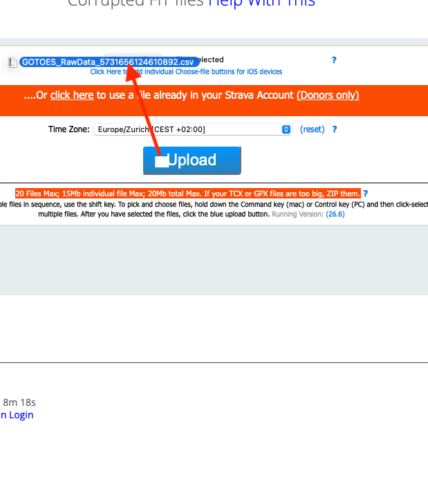

Step 3
Once you have made the changes to the spreadsheet, save the file and upload the CSV to GOTOES. Now you should have two heart rate streams in one file. Make sure that you leave the header as cadence...otherwise, one heart rate will overwrite the other. There is only room for one heart rate in a FIT / GPX / TCX file... meaning that you will have to look at the cadence graph when you're processing your data.
Step 1

Step 3
