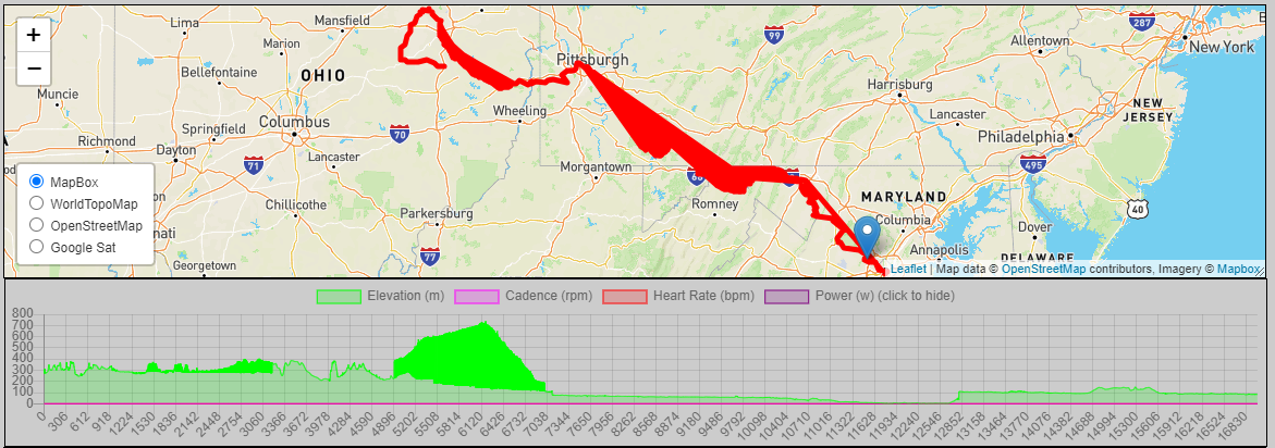

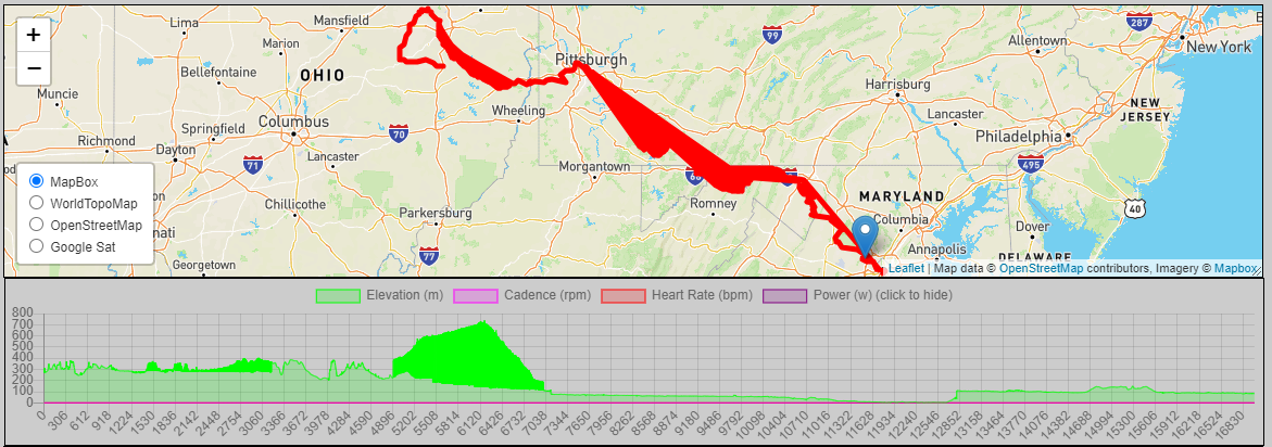

We are working on a ride from Ohio to Wash DC and have each days file completed. The files look good in Strava and Garmin. Some of the files join perfectly, but two jumble up and go from less than 100 miles each to thousands of miles. Another two files join out of order and create an added straight line between them. Any help is appreciated. Joe

First, the original problem:

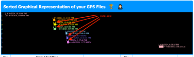

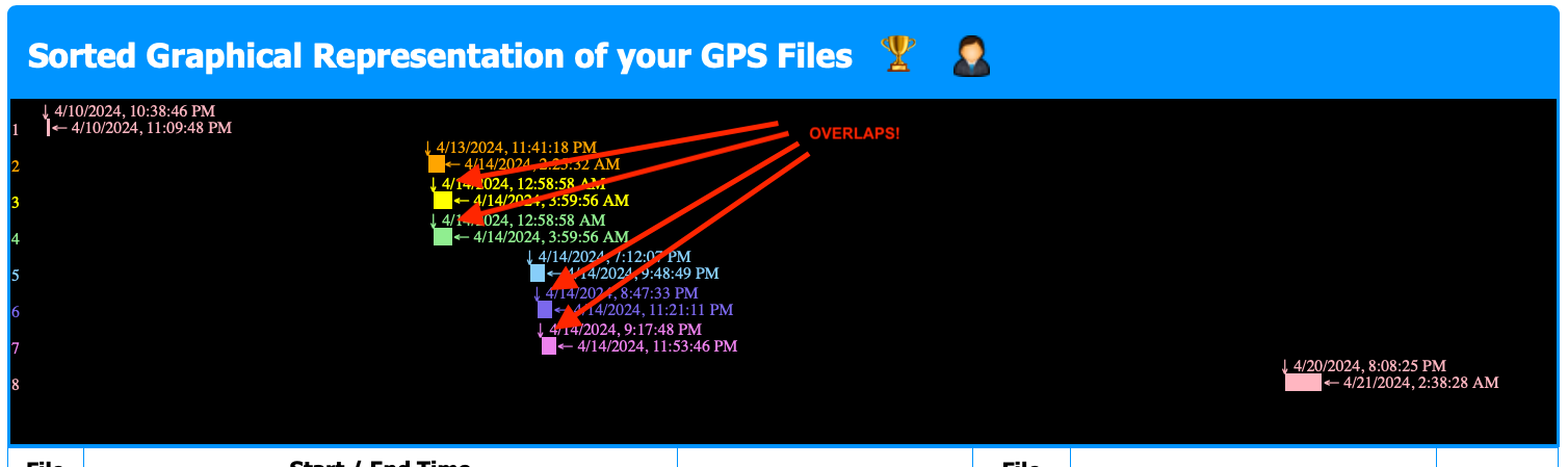

In the image below, see how there are overlaps in your files? When File 3 (yellow) begins at 12:58AM, File 2 (orange) is still going. This means that all of these overlapping points will have occurred at the "same time" - and the track will zig-zag between these points until the overlap ceases.

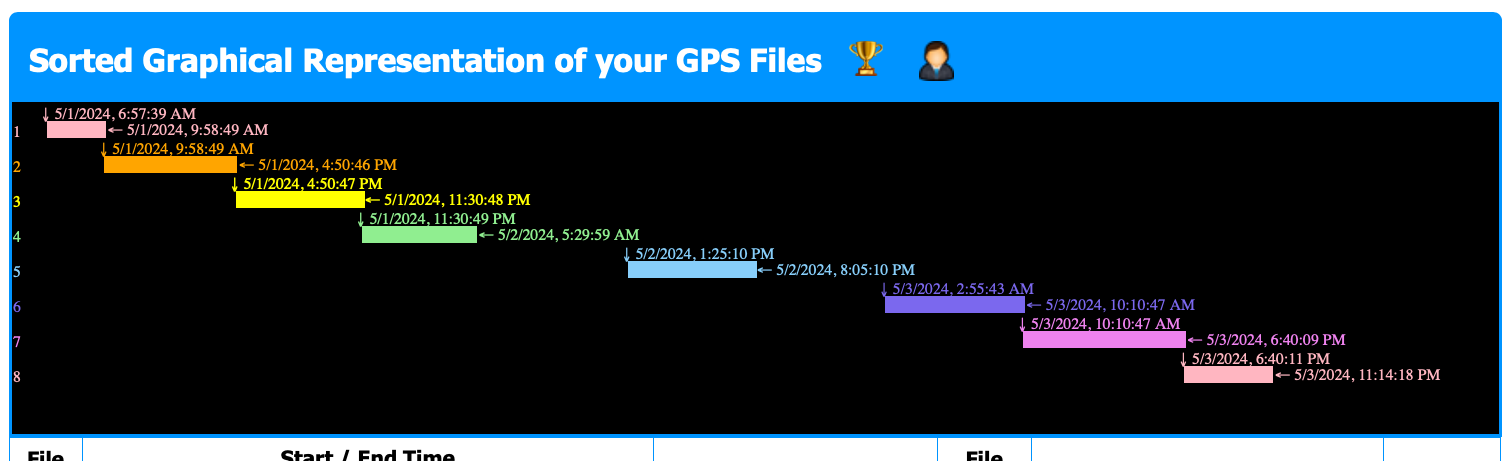

The Solution:

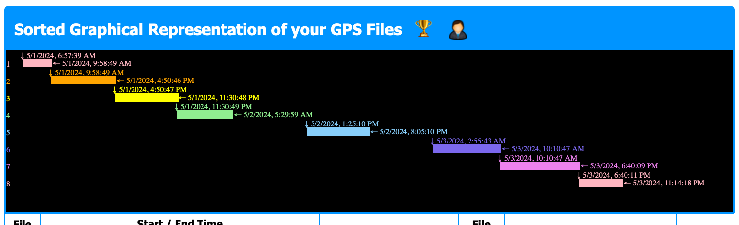

You will need to overwrite the timestamps. It is not possible for my tool to know the correct order of the files, but you should know that. If you name the files Day 1, Day 2, Day 3, etc... The tool will sort them by those names and put them in the desired order. The tool that does this is the Add Timestamps to GPS Files Tool. I uploaded your files to this tool, specified a start time of May 1, 2024 and an average speed of 10mph. These were arbitrary choices. I left the rest blank.
The resulting timeline is as follows:

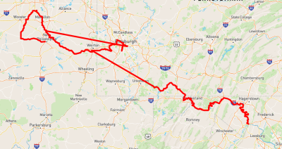

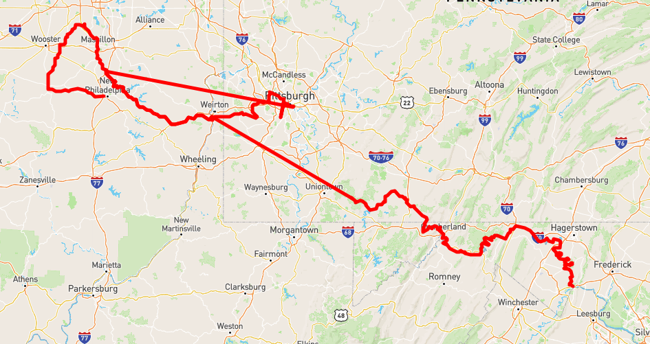

This looks good now! But I still found an issue with your map:

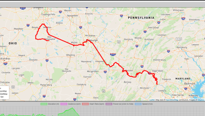

See how there is a straight line near Pittsburgh? That means there is an issue with one or more of your files. Upon deeper investigation, I found out that Day 4 and Day 5 were actually duplicates... so when the track of Day 4 ended, it would go back to the same starting point as before (because 4 and 5 were duplicates)... so I left out Days 4 and 5 and got this:
Looks like all you need to do is fix days 4 and 5 and then use the Add Timestamps to GPS Files Tool.. and your jumble will be gone. Hope that helps!
