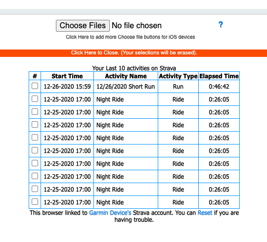

From the upload page, you can reset GOTOES | StravaTools Cookies by clicking the "Reset" link seen at the bottom of this table:

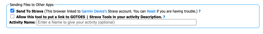

From the 2nd page where you set the parameters, you can reset GOTOES | StravaTools Cookies by clicking the "Reset" link seen in the "Sending Files to Other Apps" tab:
