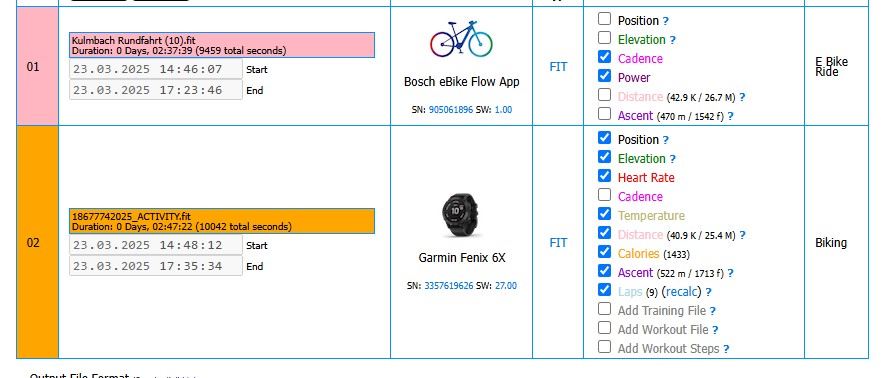

I'm using the Bosch Flow app and my Garmin Fenix 6x to display my bike rides. Unfortunately I'm not able to display the cadence on a combined file. I can display the cadence in the original Garmin and Flowapp file but the cadence is disapearing in the combind file. The power is shown so the basic import works.
maybe I make a mistake - you have any tips or tricks?

When you export the combined file from gotoes, are you exporting as the GPX format? If so, please switch to TCX or better yet, FIT. GPX does not support cadence. Strava does accept a special format (which gotoes uses) to override the fact that GPX does not support cadence… but no other platforms can read this special encoding within a GPX file. FIT is the best format for interoperability.

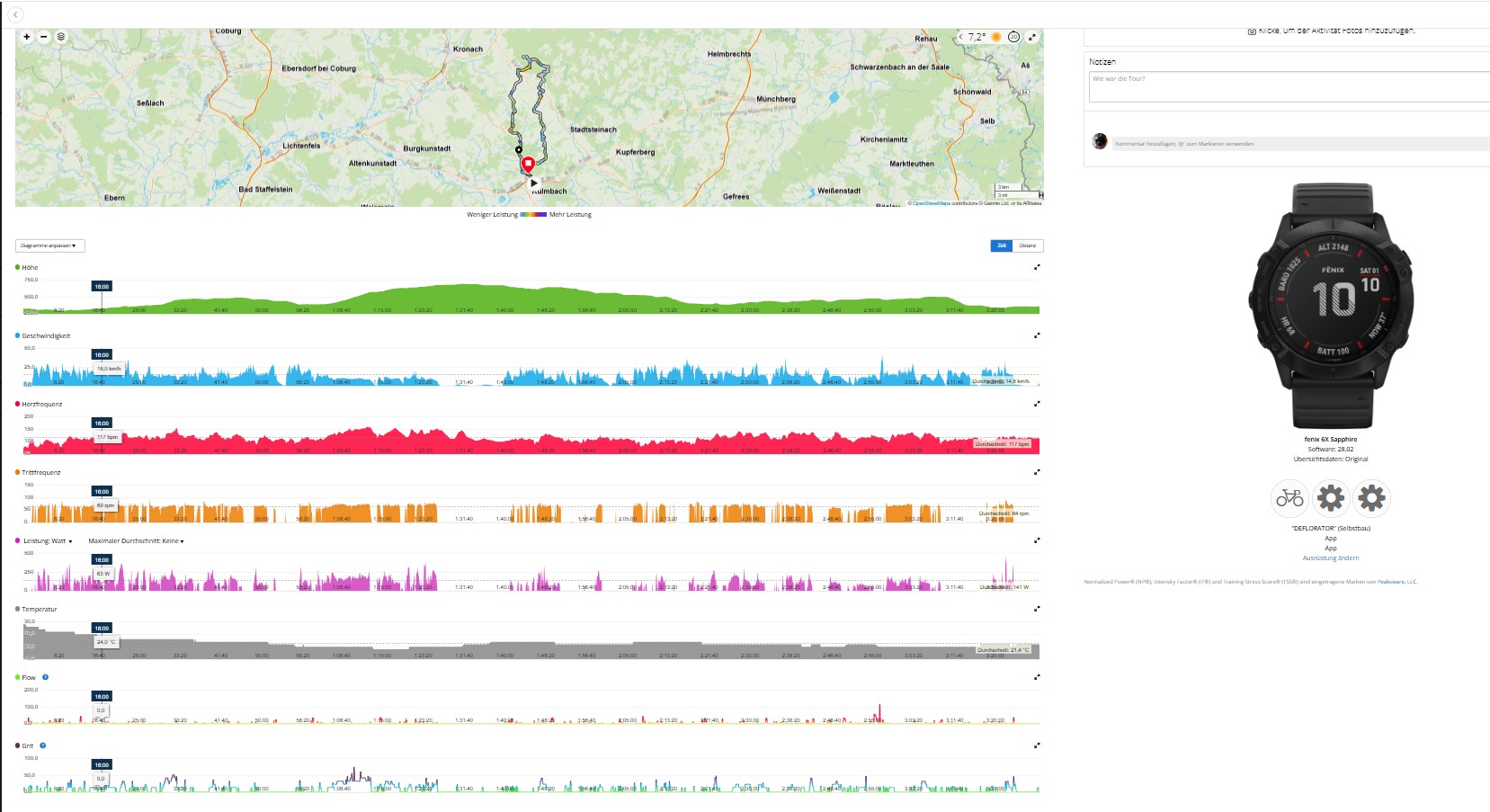

Hi
I have news on this topic.
My Garmin Fenix 6 got an update last week to V28.02 and with this firmware it looks like it works. I still get the minor faults during import but now everything is displayed including cadence - see picture
I do some more tests the next couple of days and we will see.

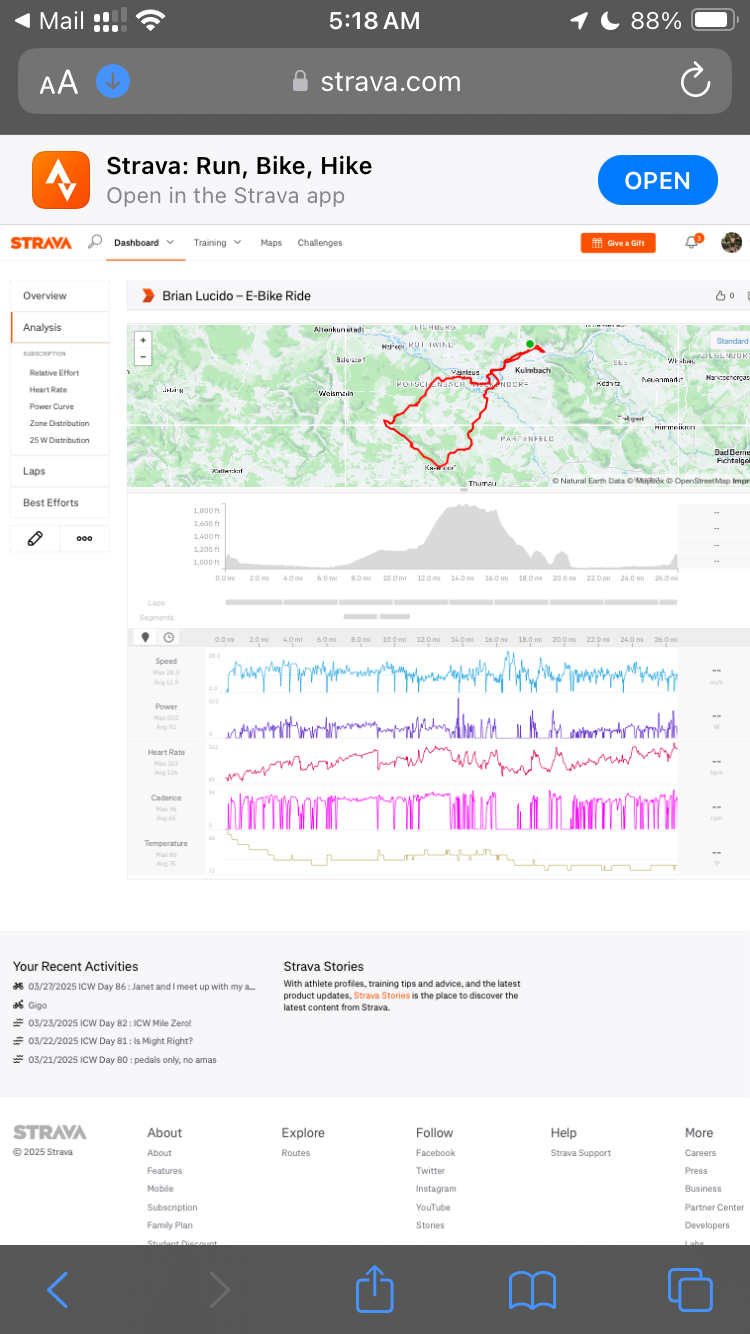

Correctly Detected in Strava.
