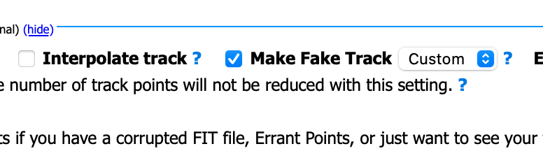

Hey! I tried to fix your original activity file using the "Generate Fake Track" option. That would have been the best option to solve this, so I will outline the steps - even though in your case, it's not going to help much.
Normal Procedure
1) First, make sure you are logged in to a GOTOES account. This is needed so GOTOES can store your Course File.
2) Next, upload the activity file to the GOTOES merge tool - the file that needs to be repaired.
3) On the subsequent page, Check the drop down near the "Make Fake Track" option, and select "Custom"
4) Upload your Course File to the new window. If the course file is good, you should get a green message. You can close the inner window if everything worked.
5) Make sure that the checkbox near "Make Fake Track" has been checked... and export!

Normal Procedure
