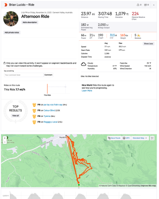

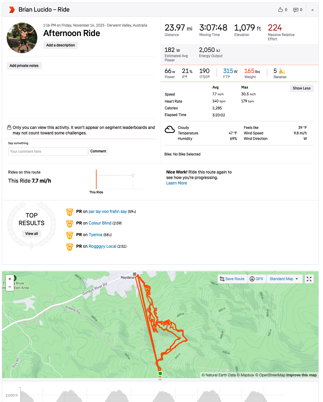

I wonder if you just encountered a Strava Glitch? I uploaded your GOTOES file to my account and it showed up with no issue.
I don't know what an "uplift" is, but I think you are referring to the straight lines on the map? If that is the case, it will kind of be impossible to remove the visual line. I have a detailed report on straight lines in GPS tracks here. Essentially, Strava will ALWAYS draw one continuous line for activities, and even if you have a big gap, Strava will pick up where the last line left off. The benefit to using GOTOES is that with a FIT export (and maybe TCX) you can at least override the distance contributed by the line.
What I would do to save yourself time is to first try again (if you still have the TCX export from GOTOES). It should probably work now if Strava had a temporary glitch. Also, if you're trying to eliminate the distance (like I said you will never get rid of the straight lines), you must use TCX or FIT. I cannot guarantee that TCX will even work because Strava has also been overriding the embedded distance in TCX files. FIT is the most reliable way to correct for distance.

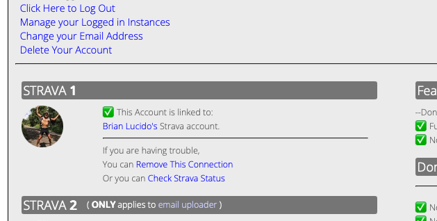

Also, as an aside, if you link your GOTOES and Strava accounts, you can have GOTOES directly send the GPX straight to Strava. This saves you from having to download and re-upload the file. GOTOES accounts are free and only take a minute to setup. Then on the login dashboard, you can link your Strava to your GOTOES:
What it looks like once you have linked your Strava and GOTOES accounts.  This is in the GOTOES dashboard (the login page).

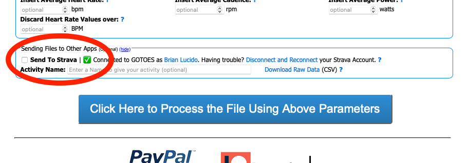

Once you have established the link between GOTOES and Strava, there is a checkbox at the bottom of the merger page that allows you to directly send the file to Strava:
Check the "Send to Strava" box, and GOTOES will send your edited file directly to Strava for you.  This avoids the download and re-upload step.
