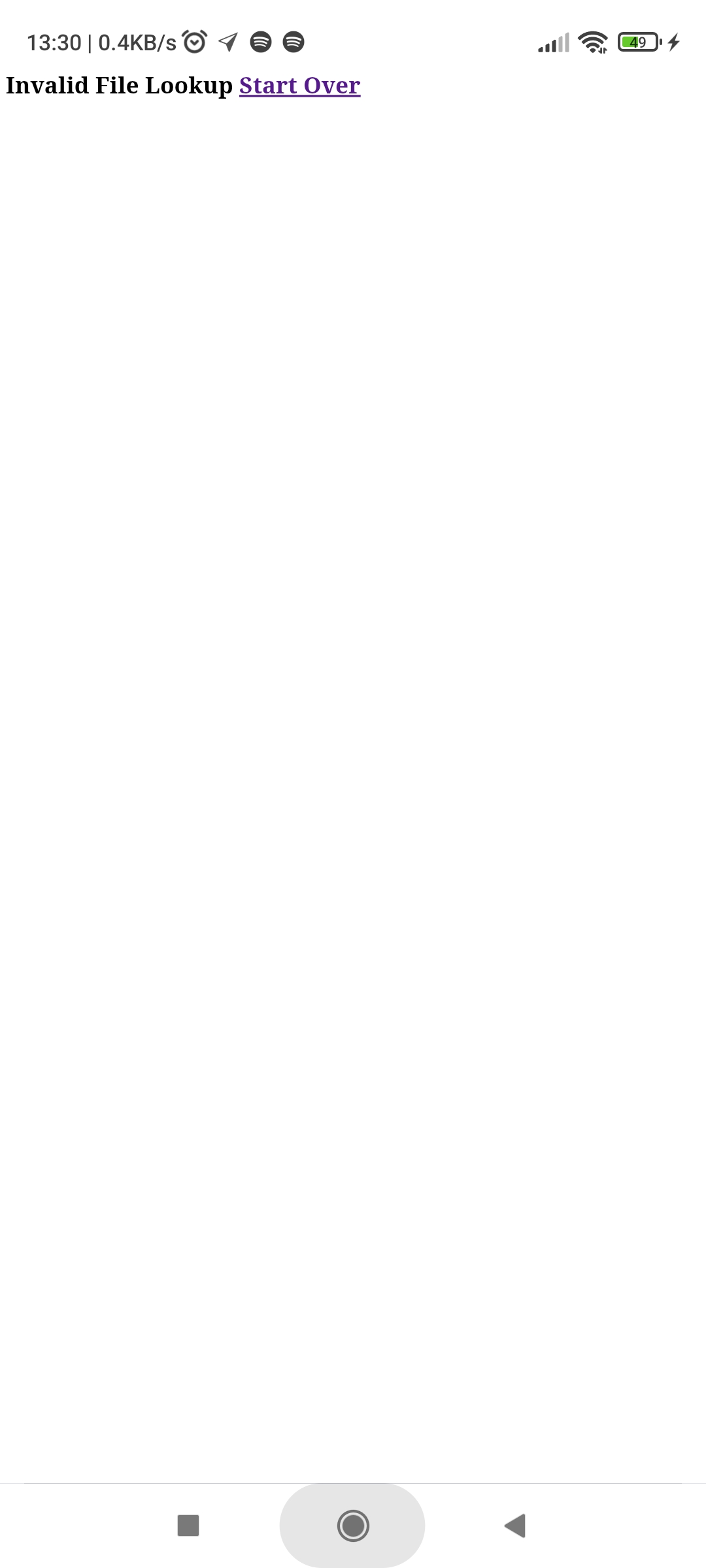

When I try to use the merge tool with my Strava activities, I just get an "Invalid File Lookup – Start Over" error.
I’m logged in, and I can see my activities in Garmin. I’m using Chrome on Android, and I have the “Randomize ID Tag” option selected.

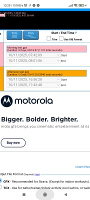

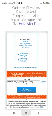

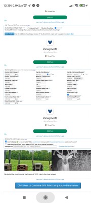

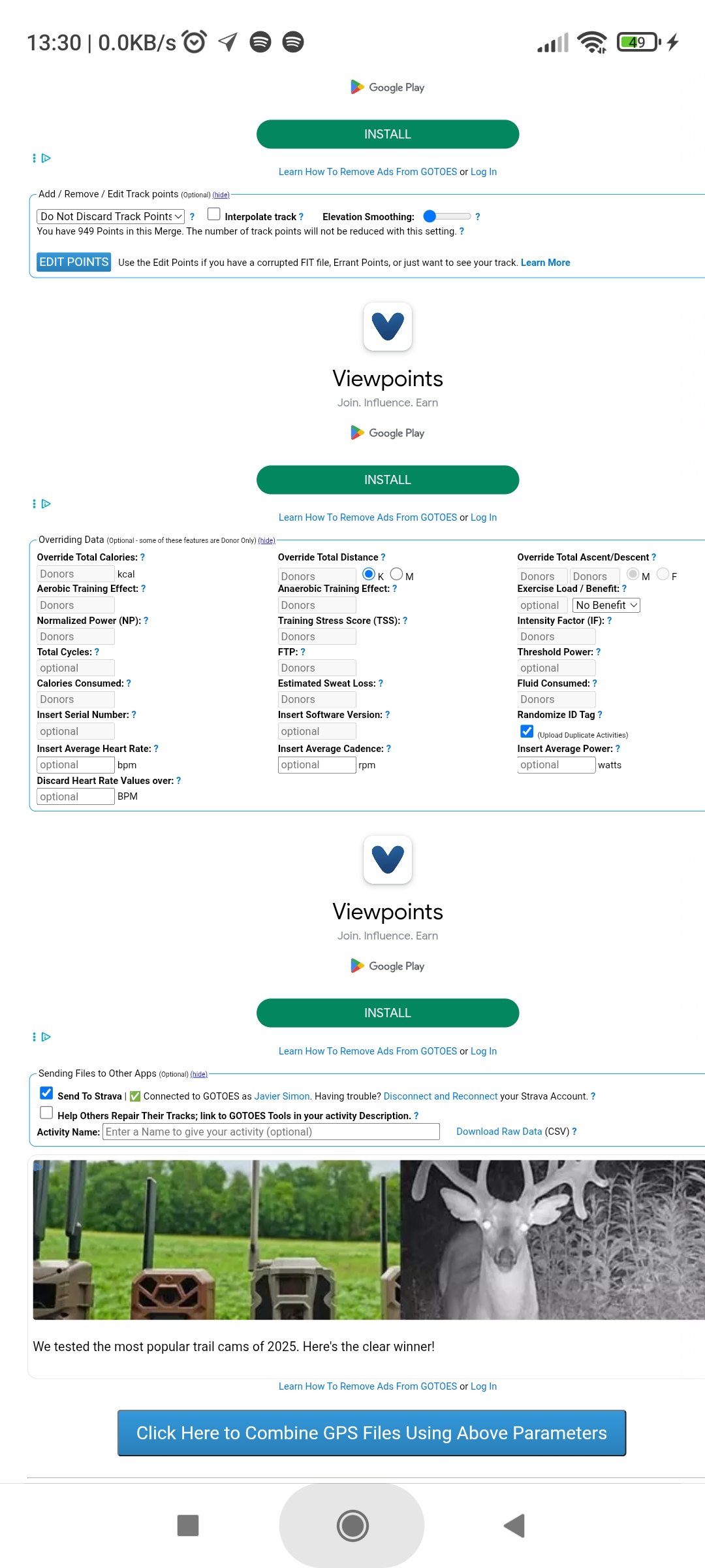

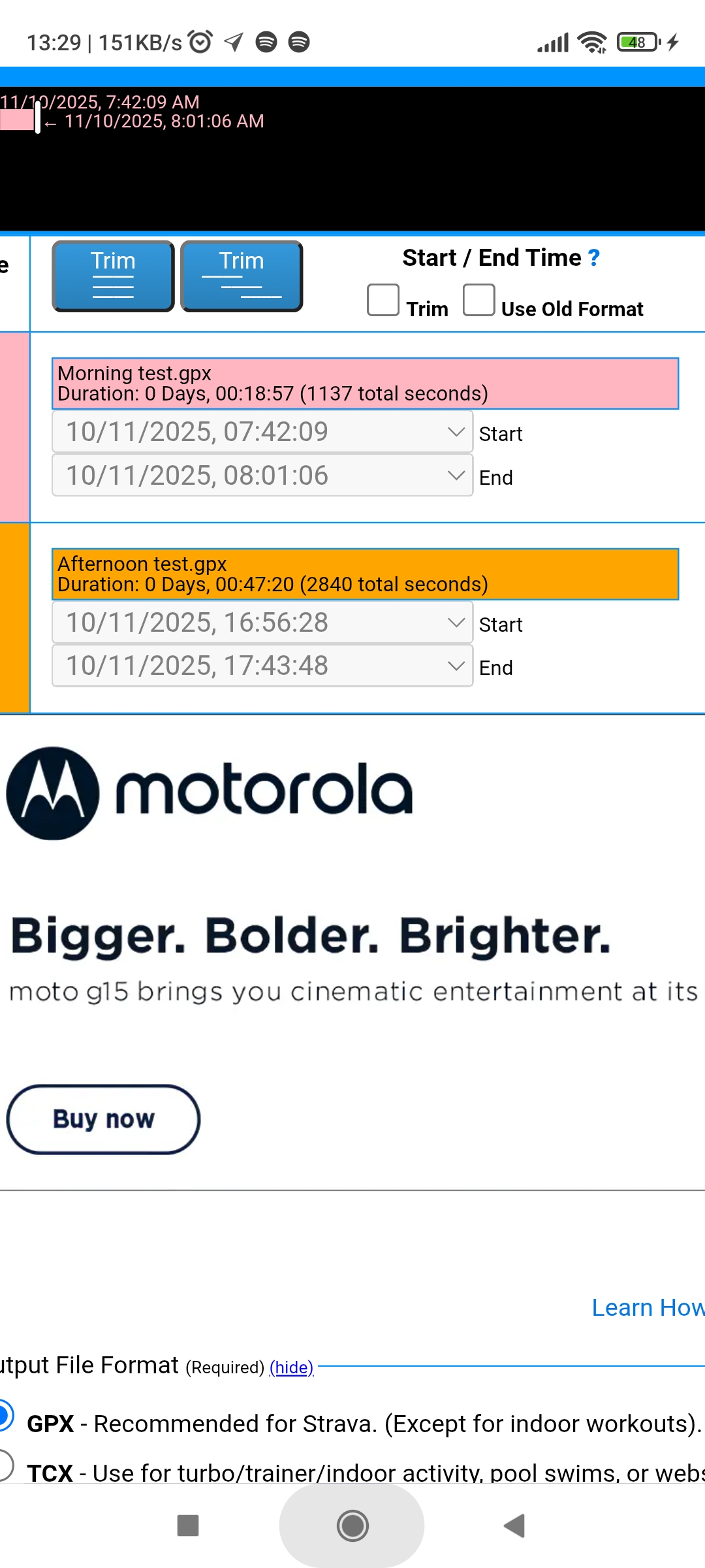

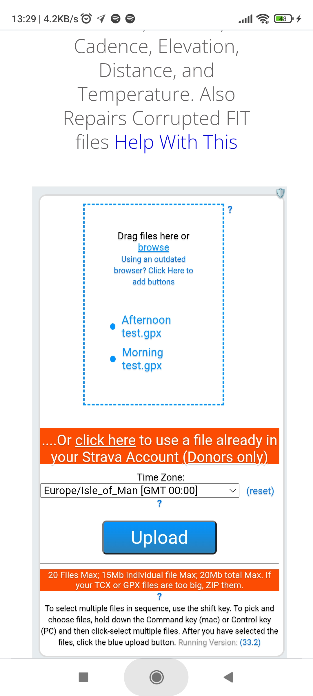

Yes, it seems it started after time change. So far this is the only tool I use and never had a problem. I use my mobile phone, not a computer. The time stamps are correct.
Have a look at the screenshots.
Re: Invalid File Lookup / Merge Tool Error when Combining Strava Activities [Solved]
Thank you for the screenshots. There is only one way to get that message - if the 16 digit upload code is missing from your submission.
I tried to replicate the issue on various browsers, and I was unable to get the same problem as you. I tried my iPhone using Chrome, Safari, DuckDuckGo, Opera, Aloha, Brave, and Vivaldi. None of them "lost" the 16 digit code. So, now I am wondering: Which browser are you using? I want to see if I can make this happen on my phone somehow, though I only own an iPhone for testing...
For you, the current solution would be to try a different browser that allows cookies and is not a private tab or incognito tab... but even if that resolves the problem for you, knowing how to replicate this issue MAY help me adjust the code so that the variable is not lost by the browser.

Just tried now again.
Using Chrome on Android. Been using only the merge tool without any problems. Same phone, same browser...

No, it's not fixed.
No incognito browser and the time stamps are correct.
I'm going to try on my tablet and see if that works.

It works on my Android tablet.
Probably this phone is starting to show its age?
I do not think that the problem is with the age of the device. I think it is one of the other things I mentioned - in particular, the date/time/time zone settings should be examined carefully.
