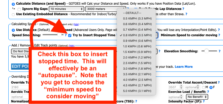

Get the Benefits Without the Risk
If you still want accurate moving stats, GOTOES makes this easy with the "Try and insert stopped time" option:
Once you check that box, you can choose your own minimum speed to consider moving.
This effectively gives you your own customizable version of the feature — without relying on the device's hidden threshold.
Recommended Workflow
  • Turn off Auto Pause on your device
  • Record the full activity safely
  • Use GOTOES "Try and insert stopped time" to clean up averages with a threshold you control
