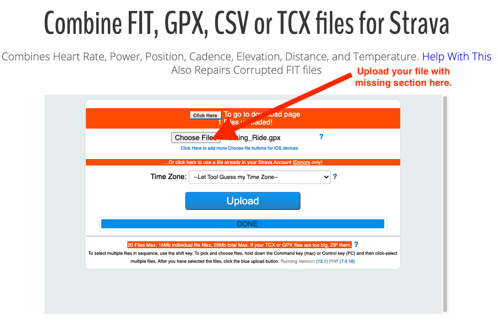

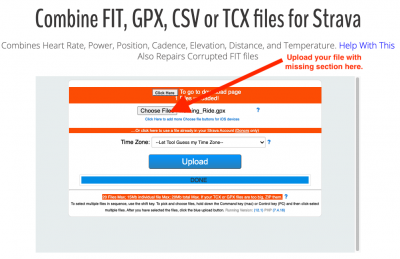

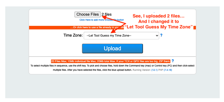

Step 1: Upload your ride to the tools. This is temporary; we just want to find out at what time your ride went wrong.
Getting Ready to Splice part of your friend's ride into your activity

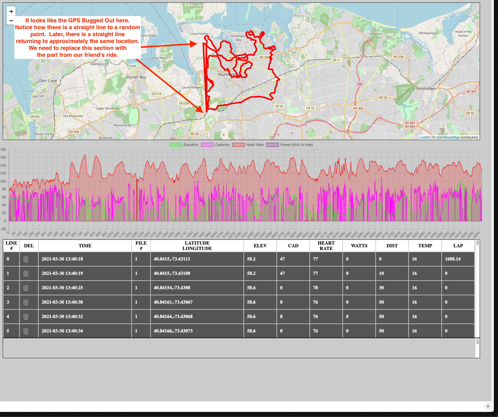

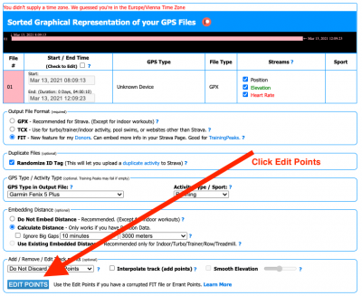

Step 2: Once your file is uploaded, click the button that says "Click Here" and go to the next page. On this 2nd page, click the "Edit Points" button.
Click the "Edit Points" Button. This will let you find where the GPS bugged out.
Screen Shot 2021-03-15 at 7.57.51 AM.png (85.67 KiB) Viewed 17464 times

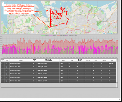

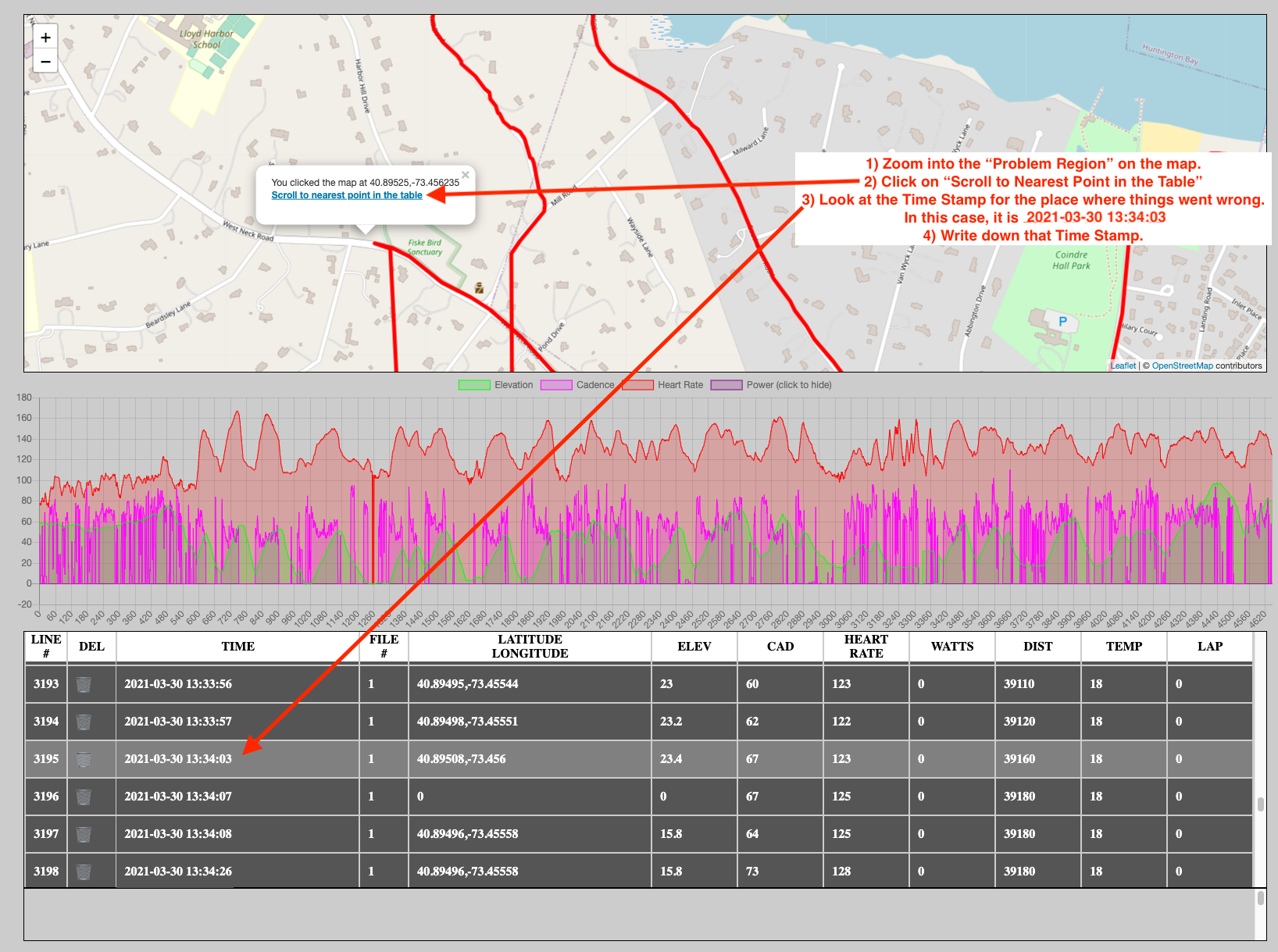

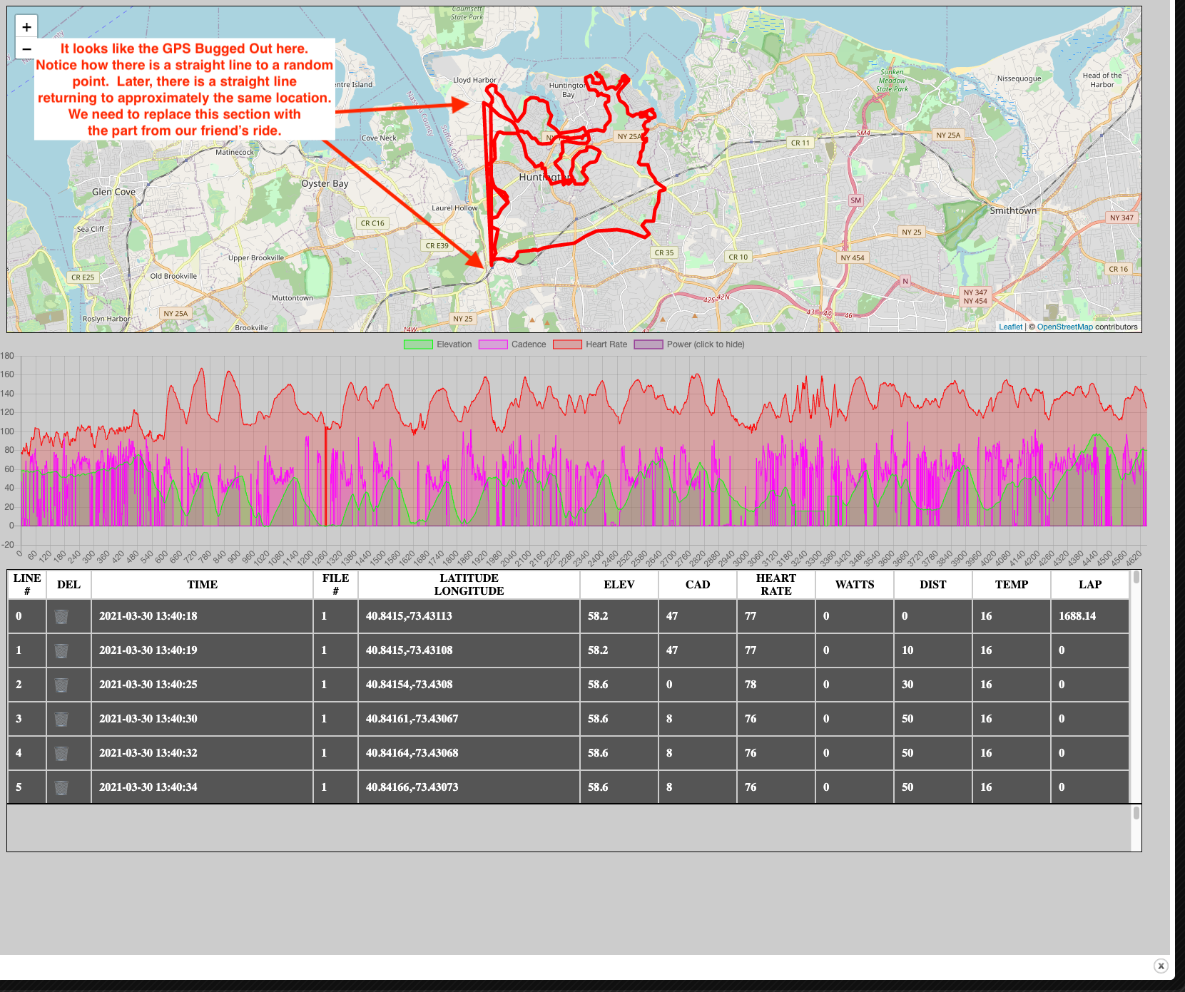

Step 3: Let's identify the location where the GPS went wrong on the map:
Finding where the GPS track went wrong.

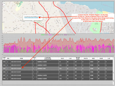

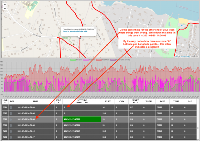

Step 5: Now, we need to figure out the time-stamps that "bracket" the problem region. Zoom in to one end of the problem, and click the "Scroll to Nearest Point in the Table" link. This will identify one end of the problem area.
Taking note of the timestamp where things went wrong with the GPS

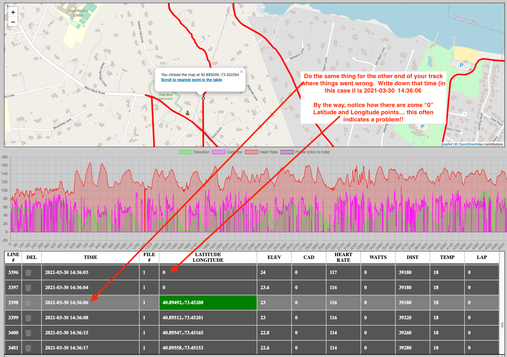

Step 6: Do the same thing for the other end where things got back on track. Take note of the time stamp.
Finding the other end of the problem area in your GPS track.

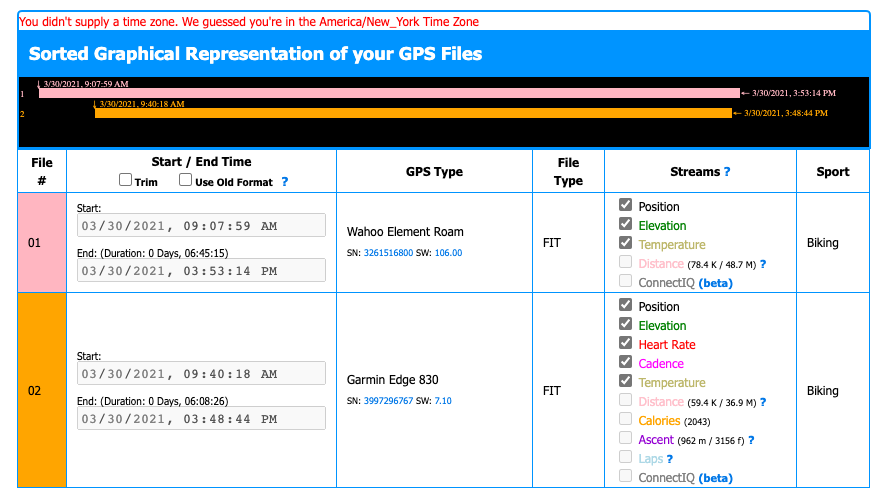

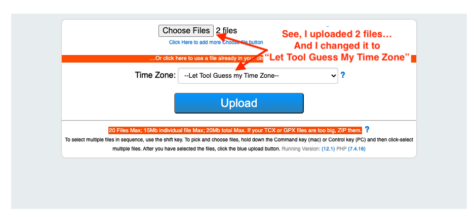

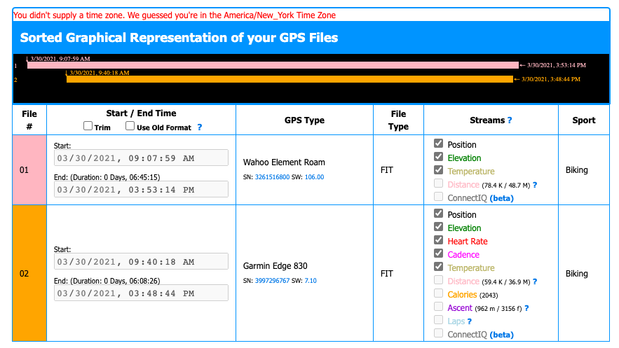

Step 7: We are now done with this window. Go back to https://gotoes.org/strava/Combine_GPX_TCX_FIT_Files.php - and this time upload Your ride AND your friend's ride.
Now we have two rides uploaded - your ride and your friend's ride.

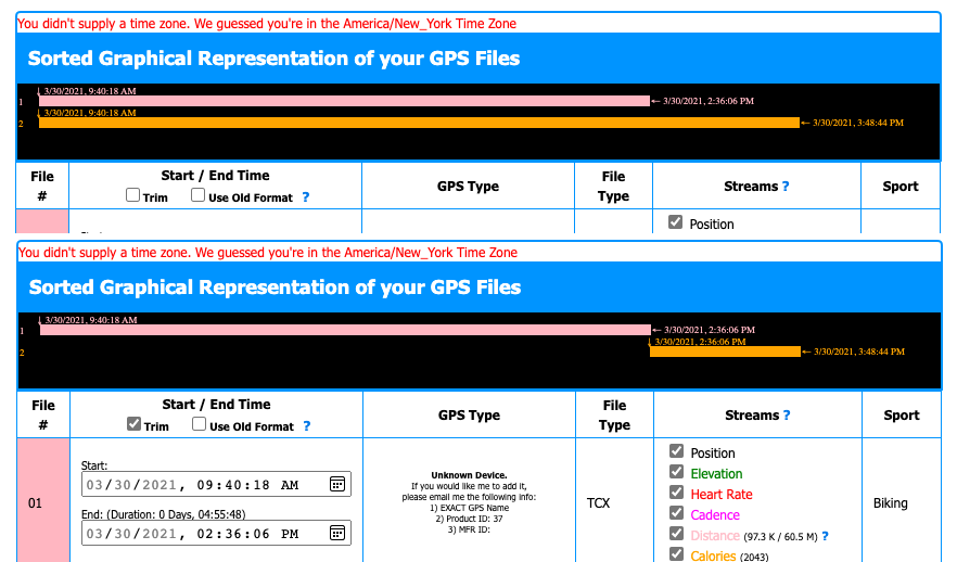

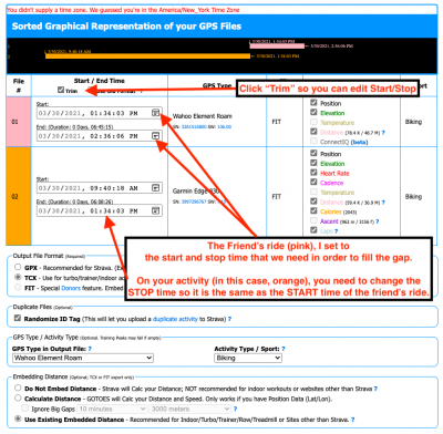

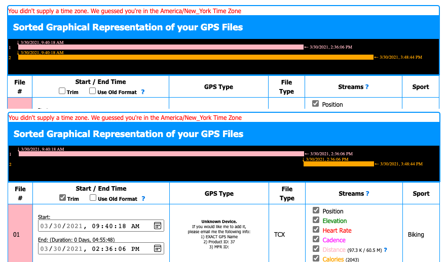

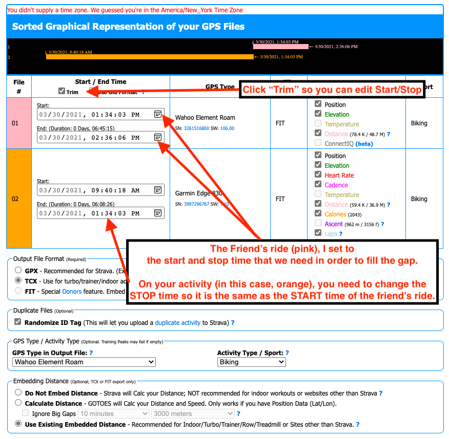

Step 8: Since we want to splice your friend's ride into the middle of your ride, this will be a two-step process. If you want to put part of your friend's ride at the end (or beginning) of your ride, it is actually a once step process. I'm showing the two step process because it is more complicated. What we are going to do is to use the "Trim" feature to trim your ride and your friend's ride. Using the time stamps you wrote down in Steps 5 and 6, we will first trim so we have the beginning of your ride + the section we want from your friend. Later, we will come back and add in the end of your ride.
Change the Start/Stop time of your friend's activity so you only have the portion you need to fill the gap.  Trim your activity to END right as the friend's activity begins.

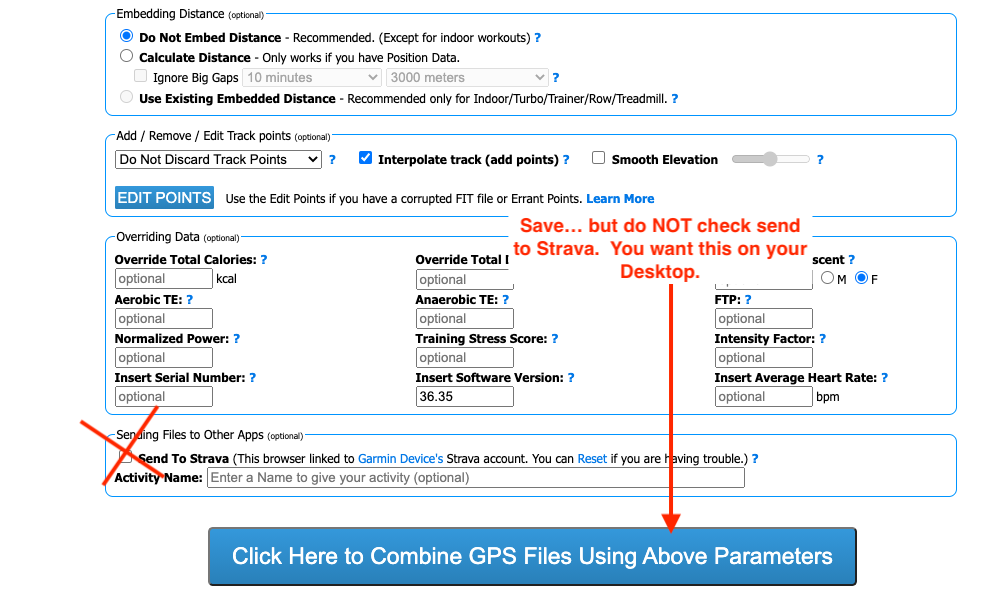

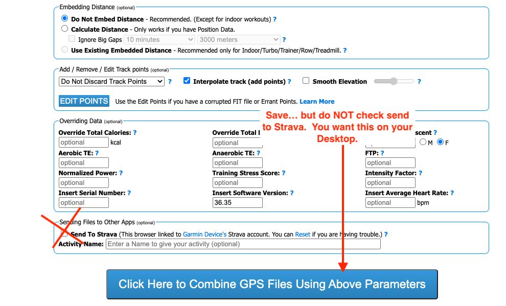

Step 9: Set all the options you want, and then export this piece of the ride. Note that you are missing the end of your ride... but we will come back and add that in again later in a second step.
Save your intermediate file to the desktop.  Don't send to Strava quite yet!

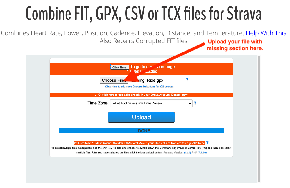

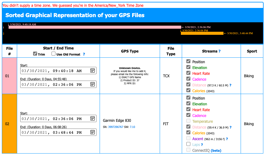

Step 10: Now you need to upload 2 files to the tool: The file you just exported, and your original file. This is the step where we will be adding back on the end of your activity.
Upload the file you just exported along with your original file to the tool.

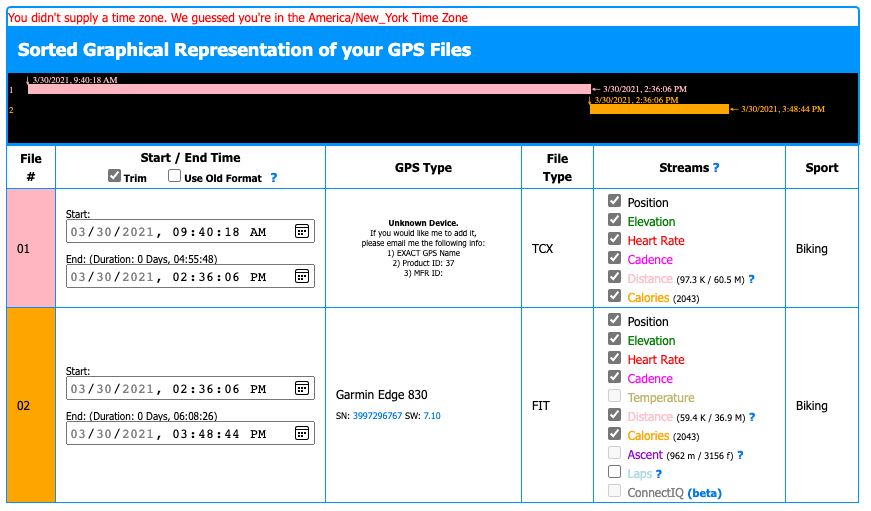

Step 11: At this point you can see the modified ride you just exported (pink) and your original ride (orange). We want to keep all of the pink portion because it includes the beginning of your ride as well as the piece you wanted from your friend's ride. We now just want to add on the end of your original ride. This is what it looks like before you set the trim:
Before Trim
Before Trim
This is what it looks like after we set up the trim:
After Trim
After Trim

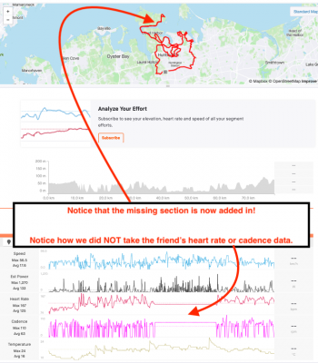

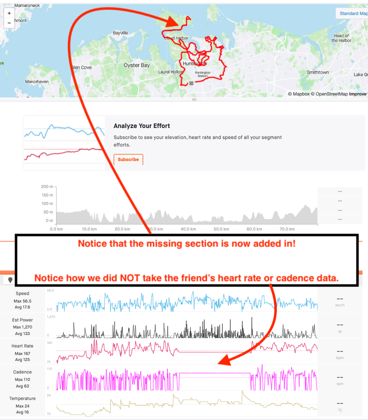

Step 12: Choose all of the options you want... and then send it off to Strava!
Final Repaired File
Final Repaired File
