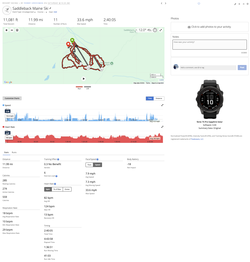

Hi there,
I signed up as a donor hoping to merge two Garmin FIT files that together, comprise a single day of resort skiing. However the output has a few issues.
First, a small thing, but I'd love to see the body battery metric supported. I believe Garmin calculates this in Garmin Connect in realtime, by subtracting the ending value from the starting value (vs storing a static value), so ideally a merge would contain the starting value from the first file and the ending value from the last file.
More importantly, the merged file loses the notion of downhill runs vs uphill lifts. The lift portions no longer show up as such on the Garmin Map, and the numbered "run" markers for each run are no longer present on the map when using the merged file.
I also noticed the merged file is about 148kb while one of my source files alone is 412kb, a bit of a red flag.
Any chance this ski run issue is resolvable, or is the current tool not up to this task? Should I be worried about the ~300kb of data that didn't make it into the merged file?

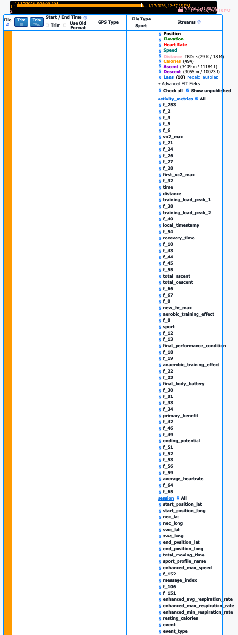

Thank you for the quick response! I did use the "Parse Rarely Used FIT Fields" checkbox, but yes, I see some of the fields I'd like are not supported by design right now.fulmar2 wrote: Sun Jan 18, 2026 3:36 am Hi Robby -

With respect to the gap, I think I misunderstood how the "Try to Insert Stopped Time" checkbox works. Intuitively I thought I would want that unchecked for what I'm describing, but you're right, when I check it, the issue I described seems to go away. PEBCAC, it seems, on that one -- sorry!
It would be great if there were a generic way to include all data, even that which isn't understood. But I understand that's a hard problem and probably impossible to get right, especially when it needs to be summarized and you don't know whether to capture the min, the max, the first, the last, an average, etc. FWIW, I've had pretty good success getting Cursor and ChatGPT to manipulate FIT files, working backwards from what I know I want the output to be to reverse engineer what some of the fields do. It's often specific to a FIT file or an Activity type, though -- not generic enough to work across the board.

Thanks! and one more thing: Can you please send a screenshot of an instance where Garmin Connect does NOT show a line in-between runs?
Re: Merging two ski activities yields incomplete results

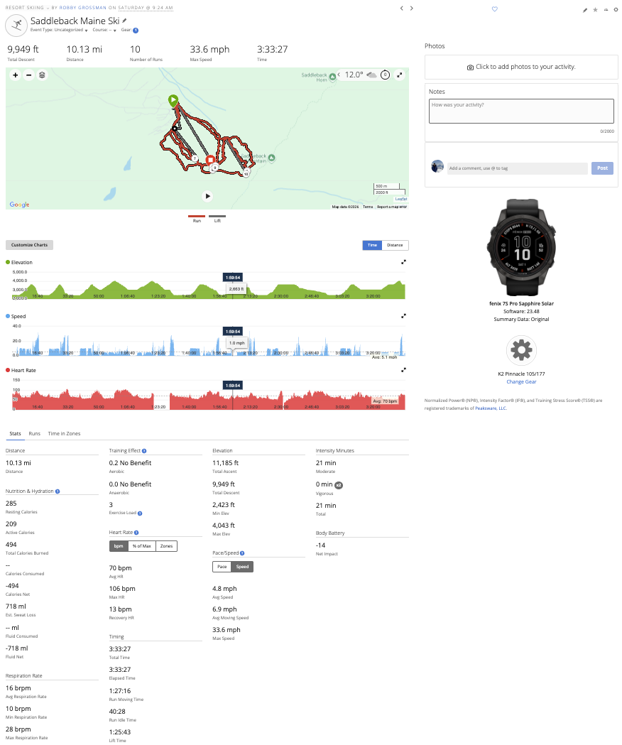

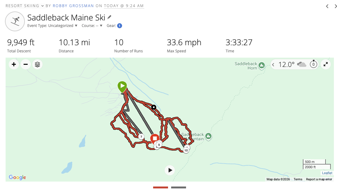

To be clear, it always shows the uphill lines, but it grays them out in a separate color and adds numbered markers at the start of each run. When I used the GOTOES combine tool, it got rid of the markers and made the track show up as one big speed heatmap (inclusive of the uphill). Here's what the original FIT file looks like in Garmin Connect:fulmar2 wrote: Mon Jan 19, 2026 11:25 pm Thanks! and one more thing: Can you please send a screenshot of an instance where Garmin Connect does NOT show a line in-between runs?

Awesome, this is much better and yes, both the table and map now show correctly - thank you!
