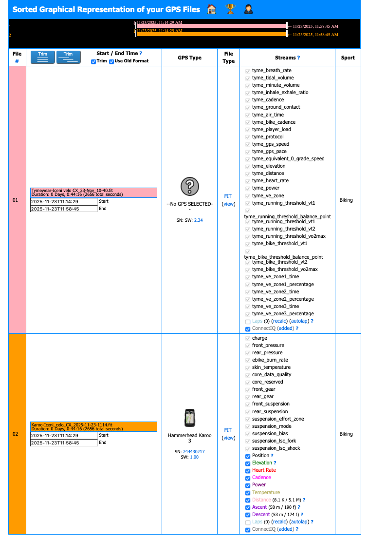

Re: Does the Merge Tool also combine developer fields from two FIT files?
In order to help, I'm going to need as much information as possible:
1) A raw time wear FIT file
2) a raw Karoo FIT file.
3) Screenshots of what you want, and what you're not getting from GOTOES.
Yes, GOTOES can do this, and yes, GOTOES creates valid files. In a sense, GOTOES is a file validator as It won't export invalid fields. A previous user posted a quote from Tymewear, but that is not a correct response from them because FIT files simply do not have "localization" (i.e. commas vs decimals) unless it is a text field (i.e. not a data field). I'd be surprised if Tymewear is using text fields to store data... Though I have definitely seen stranger things from new device makers! Upload all you can to the forum so I can begin working on a solution for you.

Tymewear-Iceni velo CX_23-Nov_10-40.fit- (433.45 KiB) Downloaded 164 times
Karoo-Iceni_celo_CX_2025-11-23-1114.fit- (74.66 KiB) Downloaded 162 times

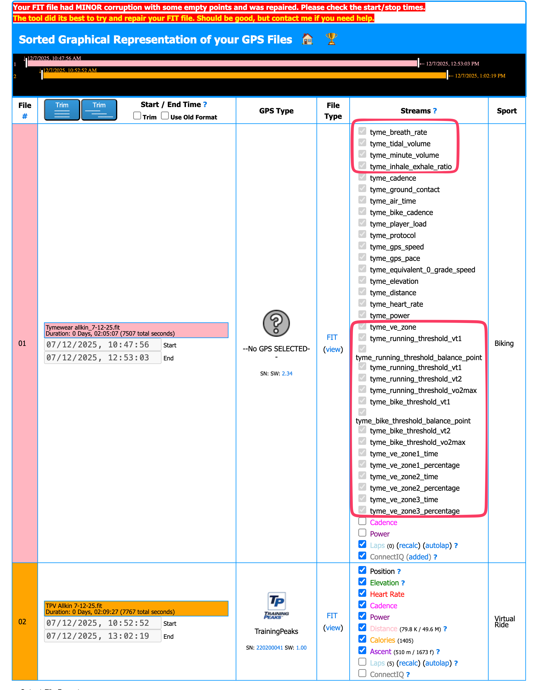

I then opened up a Tymewear account online, but could not find any way to upload the file I had created for a test. It seems as if you might need to be supplying files directly off the device? If this is the case, GOTOES might not be able to help, as I see no way to manually import files. Maybe you know how to do this?
I also uploaded the merged file to Garmin, but I saw that none of the developer data fields have been registered with Garmin (this includes the Karoo developer data). In order to "see" the developer data, it must be registered with the platform that you're viewing it on. So, if tymewear is able to read a file that has both Karoo and Tymewear data, this attached file (merged-6.fit) should work for you. I tried it in Garmin and could not see the Tymewear data.. but I could not see the Tymewear data in your original file either because Tymewear has not registered with Garmin. Tymewear has also not registered a Manufacturer ID, so the device is currently "unidentified" across platforms. If they get registered, I can add them to GOTOES (just let me know when this happens).
Oh, sorry; I thought you were suggesting that GOTOES does not work; not that you wanted to test out the platform. I took your files and loaded them into the GOTOES tool. I did a smart (overlap) trim, and then selected the ConnecIQ fields from both of the files. There were quite a few developer data fields, as you can see from the screenshots, so I am guessing you have A LOT of sensors connected. GOTOES definitely successfully merged the data (you can see it in the GOTOES FIT file viewer):
merged-6.fit- A sample merged file. If you are able to upload it to Tymewear, let me know. IF not, I can try merging without the Karoo data fields.

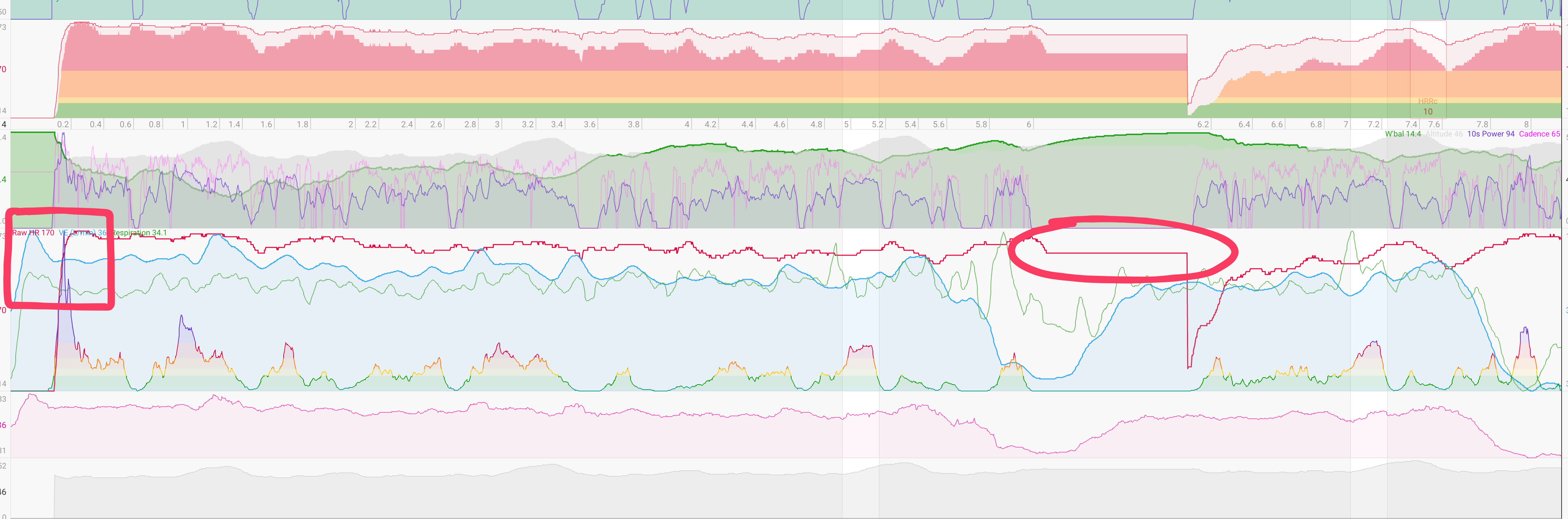

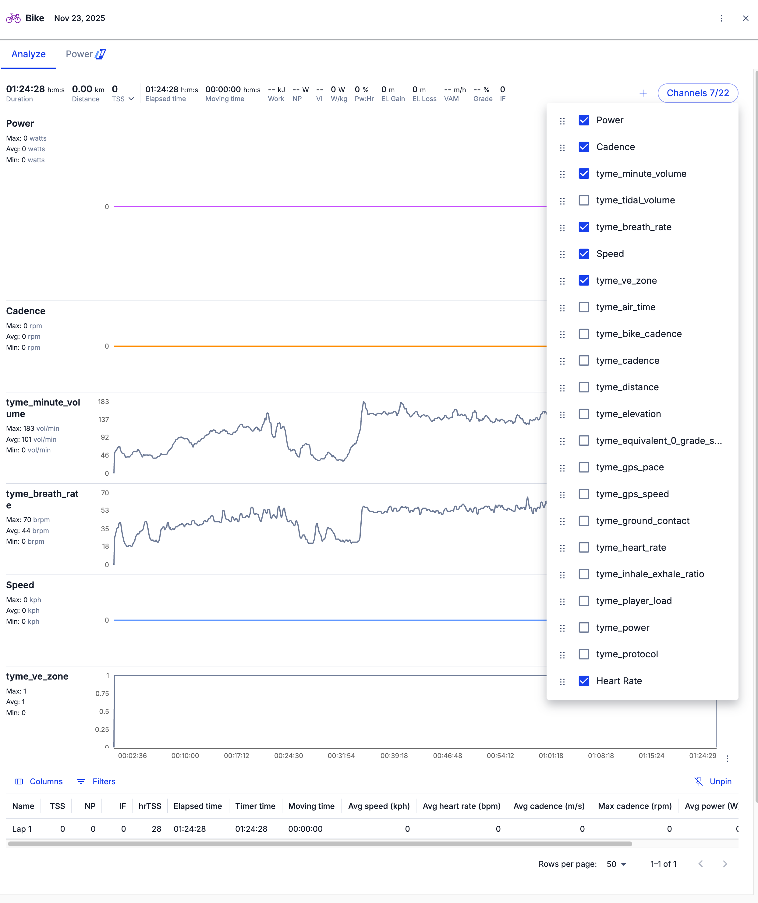

hi the merged file doesn't work, it has some data spikes but is missing the actual data and the spikes are 100x higher than possible.
Nothing shows in Garmin buyt I guess they don't support it and I don't use Garmin anyway.
Both Intervals and Trainingpeaks do support all the Tymewear fields.
The easiest way for you to test would be to upload to TP and look at their beta charts which support all the metrics.
Tymewear have the ability to merge a fir file from a headunit or whatever on their site but then I'm back to the main issue, it takes power HR etc, but strips all GPS data so no distance elevation grade or maps which makes it pretty useless.
Do you want one of their merged files for the 2 I supplied?

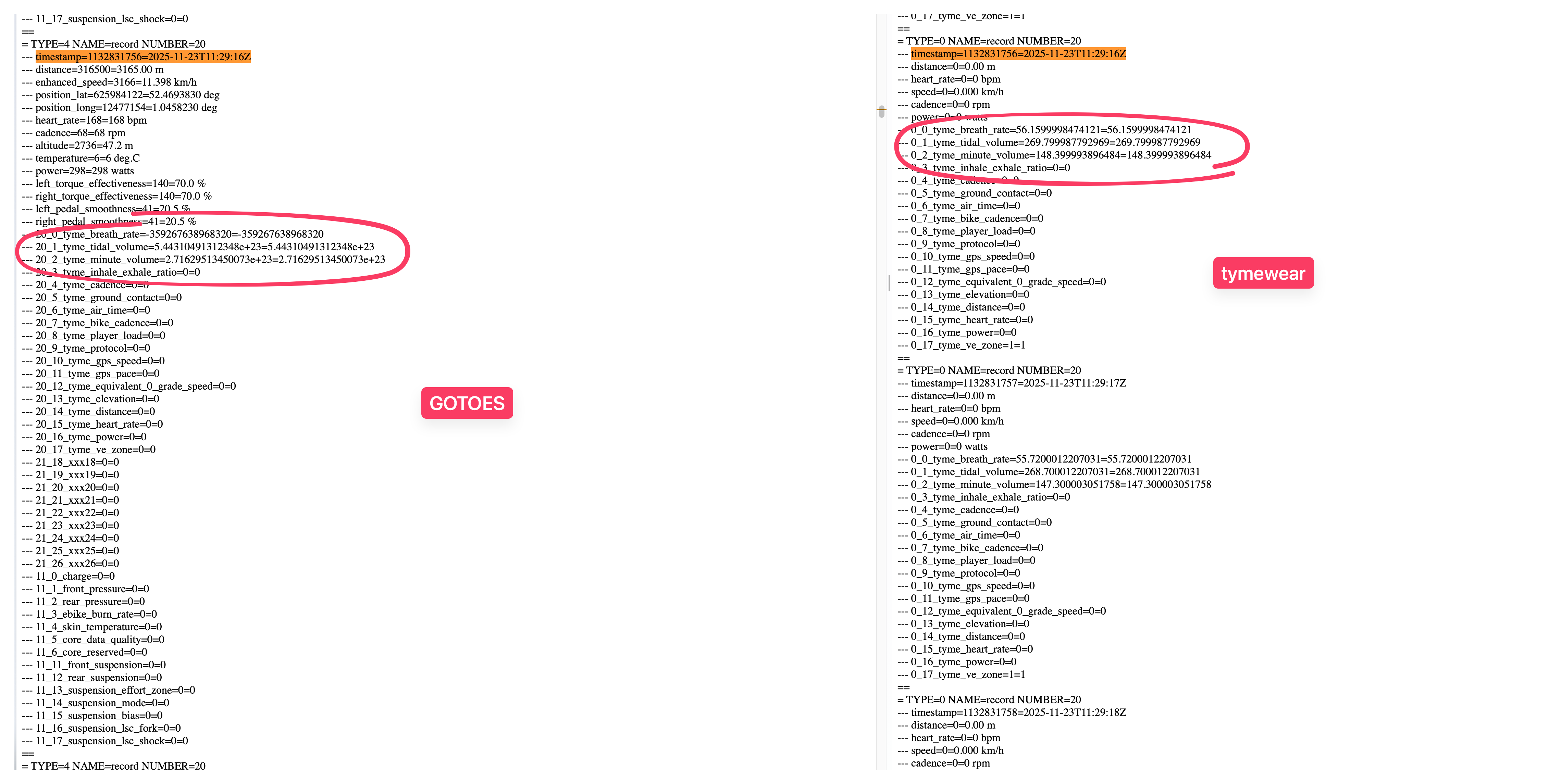

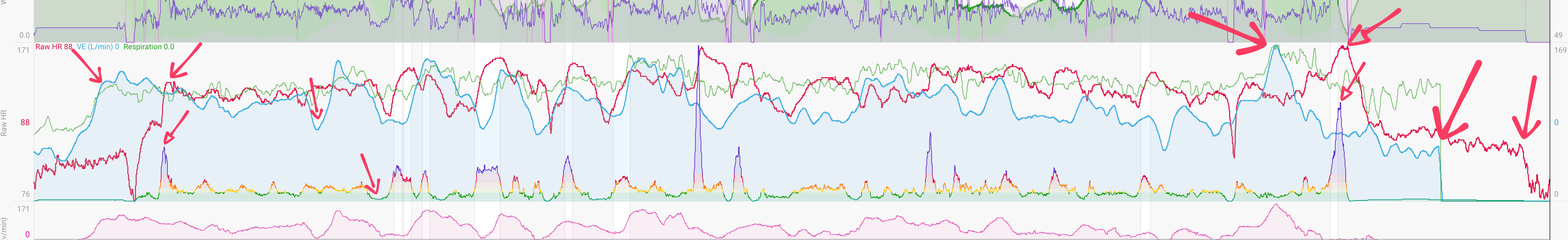

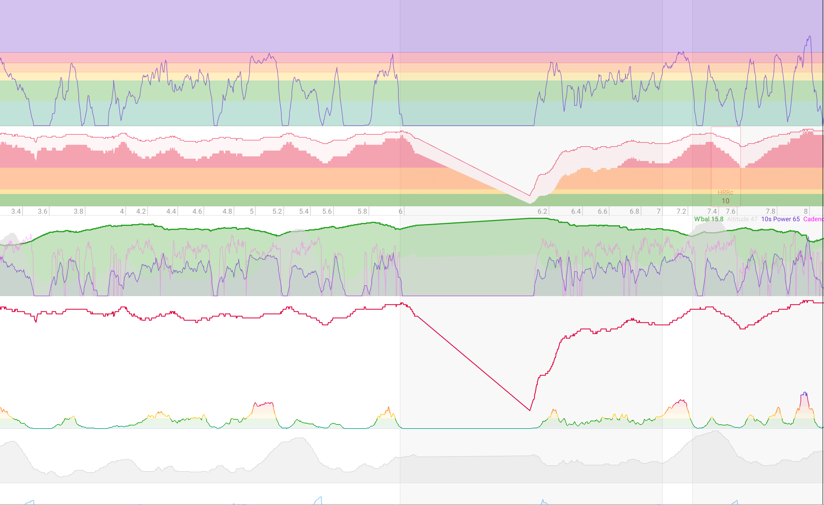

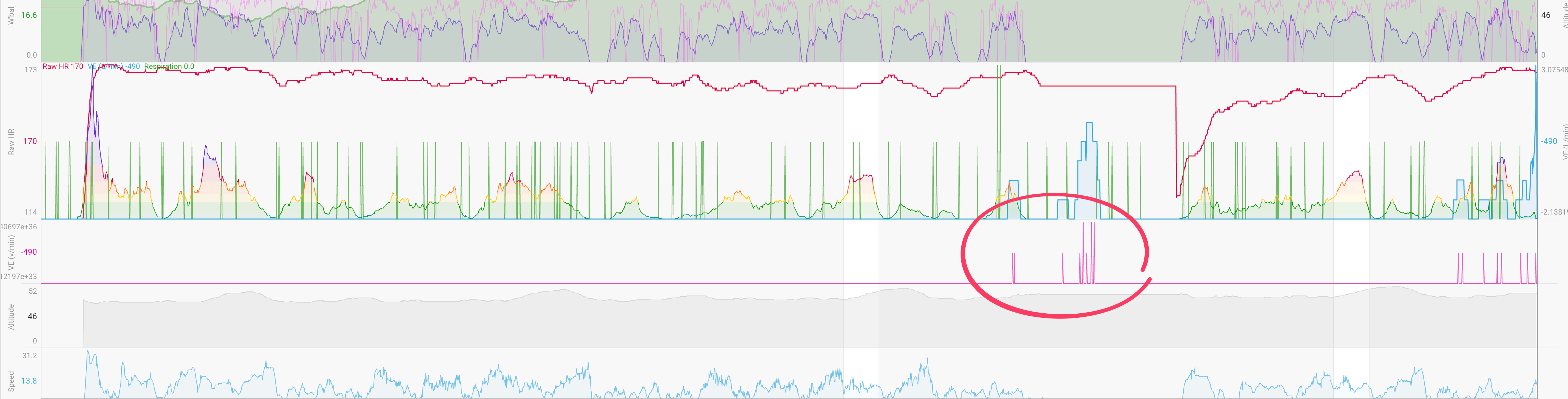

bit more info having done some digging.
I've compared 2 timestamps and although GOTOES has merged the data the figures are all wrong which is probably why it is all wrong in Intervals and TP.
this one is to show the fields recognised in TP from a Tymewear file this is the merged files but wrong numbers this is the merged file uploaded to Intervals, there are just a few spikes this what the data should look like in intervals - this is the un merged tymewear file

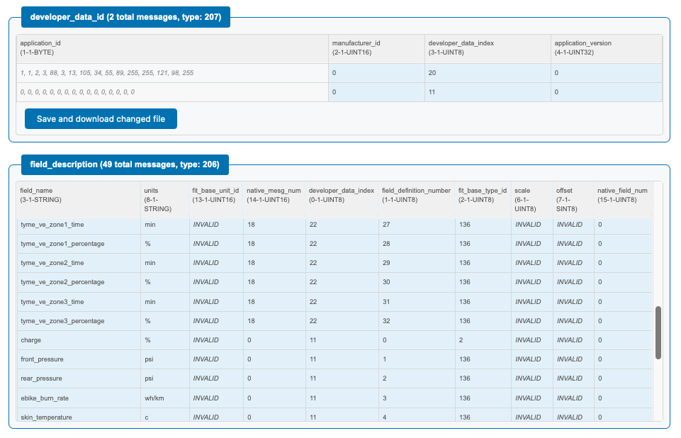

Ah, sounds like I can use Training Peaks to test. Are you a paid member of Training Peaks? The reason I ask is because even when I upload your original Tymewear file, I cannot see the Tymewear data in my account. Also, I was unable to import files to Tymewear for testing..
However, I do see from your screenshot, the most helpful one of the raw data, that there does seem to be some sort of units difference in the GOTOES file. GOTOES does not manipulate the developer data, but instead inserts it as-is. However, GOTOES does read the field types assigned by the file and puts them in the output in the same format as GOTOES reads in. So, there does seem to be a discrepancy there.
The short answer to your question seems to be that as of today (November 24) GOTOES needs to be updated to work around this data format anomaly. I'm going to be out of town for 3 weeks, but when I return, I'll work on making GOTOES work with Tymewear files.

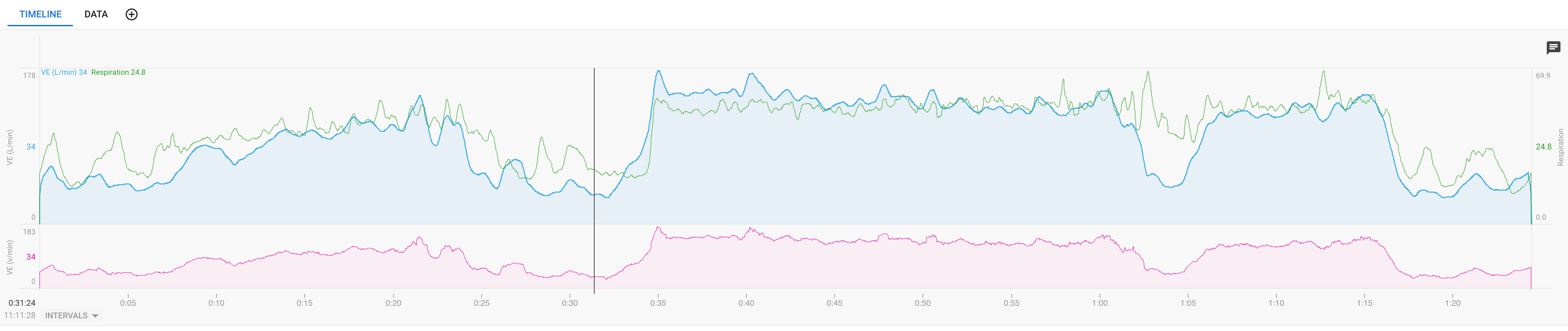

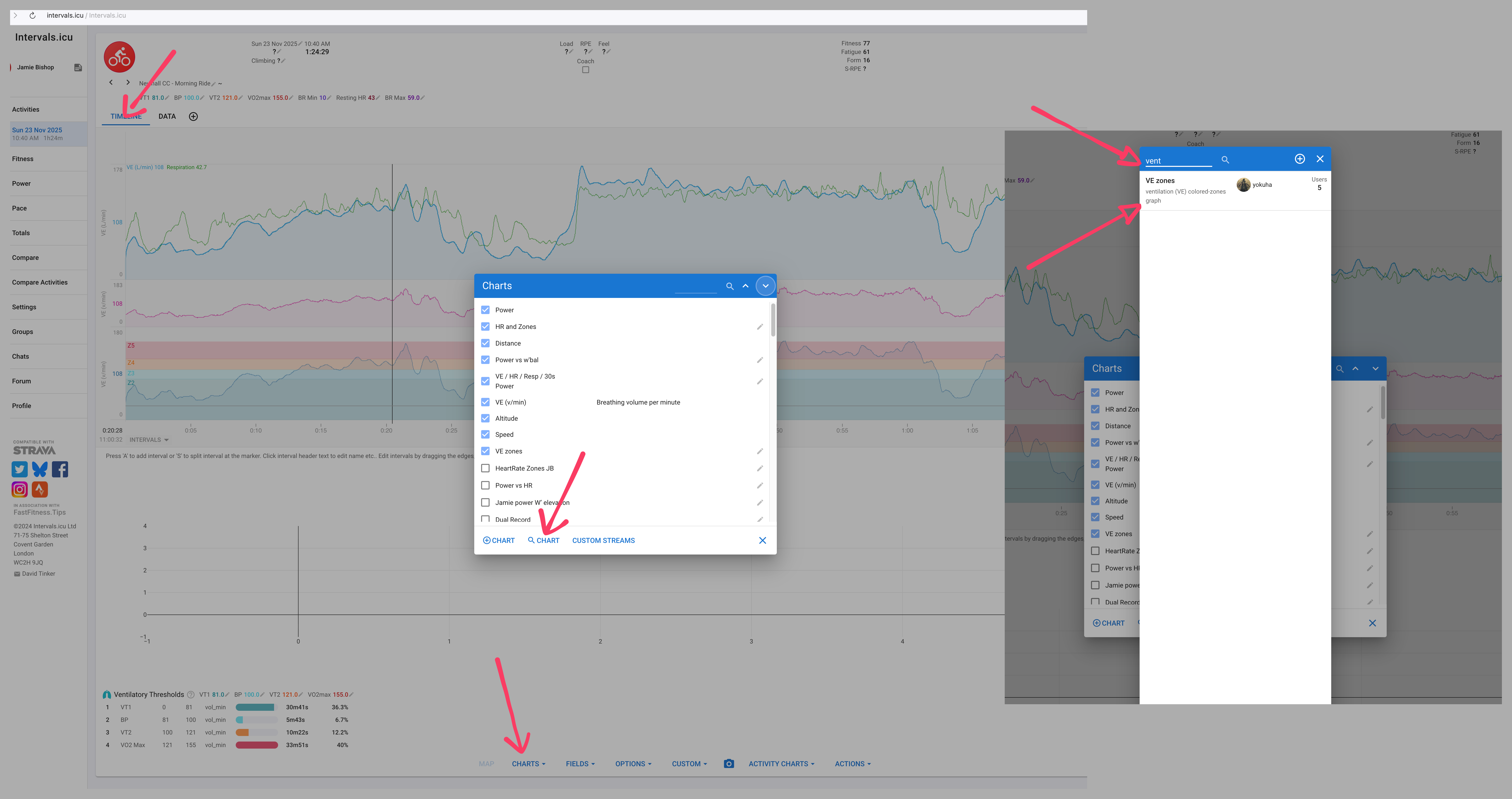

I am a premium TP member, just to do a free account to see if it works but if gives you 14 days premium free
You could test on intervals.icu following the below image. You upload file and view it, click on charts and search for VENT and then add the one that comes up. There loads already made in there if you search VE or tymewear, which will allow you to see the data.
Thanks for your help on this.

This is helpful, especially the AI response. I examined both the input as well as the output, and both fields are being treated the same way (as float32)... But actually, I do see how the response (above) from Tymewear is actually correct. It turns out that GOTOES is seeing the arrays as single numeric values. I will fix it. Probably won't be until I get back, but I do see the issue.

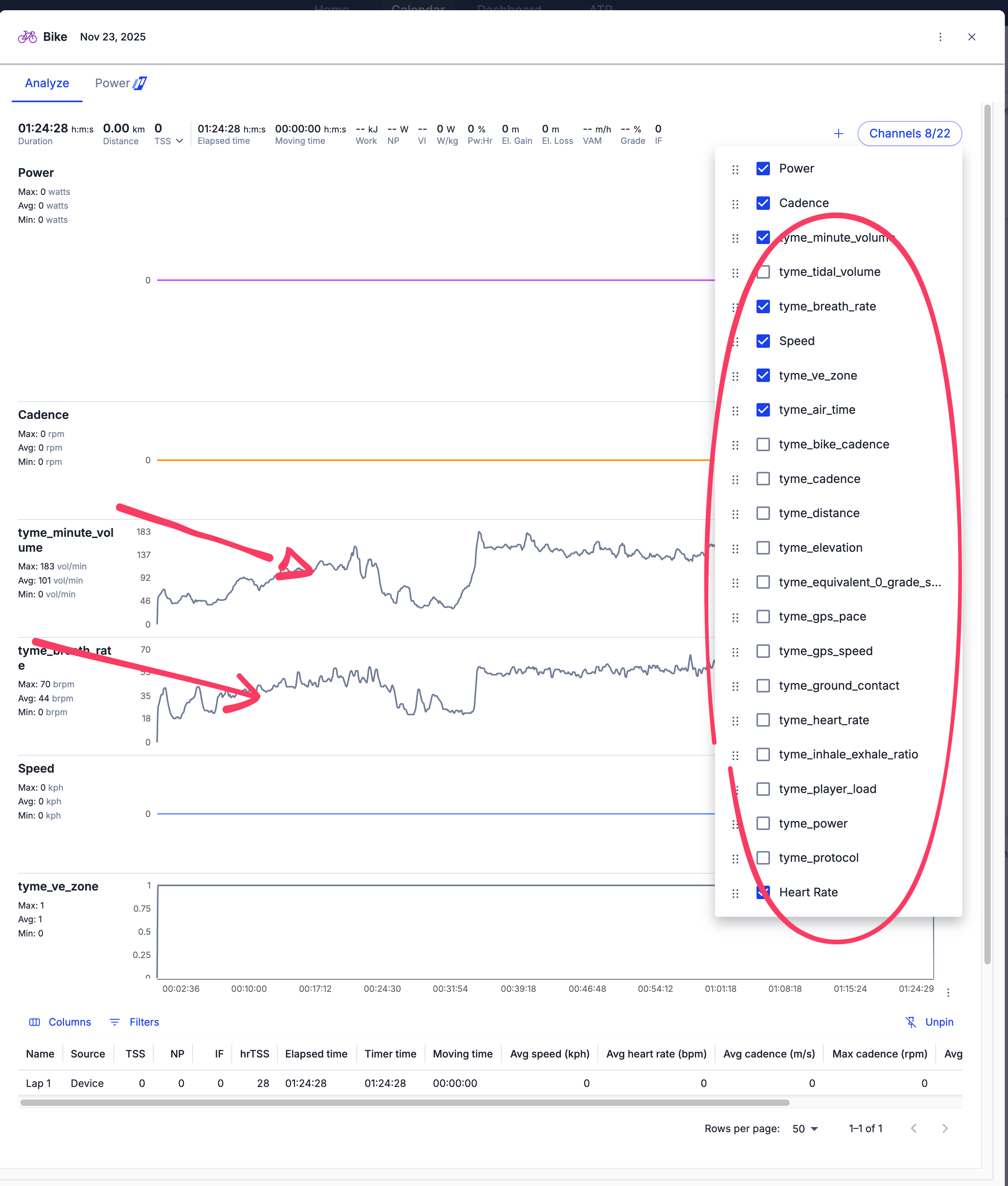

thanks, Tymewear still have no merge at all now
OK, after several hours of work, I think I may have identified the issue. I am not able to easily test on the tymewear website, as there is not a way for me to easily upload and delete files. I get the feeling that their site is very much a work-in-progress.
I did follow your instructions on intervals.icu, and if I'm not mistaken, I have fixed the issue with GOTOE's interpretation of the values. Indeed, this was a bug with GOTOES (Assuming it is now fixed). Can you please report back to me to make sure that this issue is truly resolved?

Hey, I become a donor and tried it. It's very nearly there.
It has combined the data an d the value look correct but having tried 2 activities the data is about 6 minutes out in terms of timestamp.
The tymewear breathing data is too soon.
See below, you can see were power is applied and HR rate rises, breathing is a very similar graph to HR but is way too soon.
Red is HR and breathing is blue. You can see the final sprint and peak HR, breathing is about 6 mins before, and you can see where HR drops at end of activity, again breathing finish way too early.
As a second request would it be possible to toggle on/off tymewear fields that are added as their HR data is funky and I only need the breathing related fields

Hi j4m1eb -
GOTOES does not alter timestamps within the files; it uses the embedded time. In fact, time is the ONE field that GOTOES never changes unless you're using the timestamp tool. Typically, with outdoor units (like GPS), the device captures the precise time from the satellites. However, it appears that you're using two non-GPS units (I don't know where your TrainingPeaks file is capturing position data from, but perhaps it is an indoor activity?). Regardless, GOTOES bases everything off of the time - so you will need to set the time to be correct (or at least matching) in both devices.
Moreover, I can see from your screenshot that you might also want to use the "smarttrim" feature to cut off the head and tail of the overlaps. This makes your uploads more tidy.
With Regards to your request about removing developer data fields - I will consider that; but before I do, how much of an inconvenience is it to have an extra data stream? Can you just hide/show that in your viewer? I'm asking because adding the ability to remove the datastreams is probably another 2+ days of work for me, and I've recently been tasked with some other important feature requests. I am guessing that this isn't something that will help many people - but please correct me if I'm mistaken.

I've merged another activity, this time main data recorded with Karoo, Tymewear is recorded by the strap then synced back to their phone app for upload, time is out again so I assume Tymewear is the issue, not sure how to fix.
Is time shift possible?
The dodgy HR bit in in this file. Not super important. Think it's just how tymewear deals with no data. I was fixing a mechanical, for some reason HR stay at last record then jumps to new value. Throws metrics off a bit, but hopefully it's a one off.
Tymewear merged Karoo only

For the first issue, I am not familiar with Tymewear devices - but is it possible for you to set the time on that device? This is almost certainly the issue there.
For the 2nd issue (the flat line heart rate after the merge), this is a feature of GOTOES where if your device is turned off/not recording, it continues with the "last known heart rate". The purpose of this feature is to repair files where the heart rate monitor drops out frequently. Anything below a heart rate of ~26 is "carried over".
However, in a FIT file, you can insert start/stop time. Depending on the viewer, start/stopped time may or may not be respected. I am not sure how your viewer handles stopped time, but you probably want to check the insert stopped time box anyway to make your output be accurate.

I didn't notice before that my Intervals response got quoted here
I'm not a TymeWear member, just an avid Intervals user and also using your brilliant tool a lot. Guess I was the one who introduced it on the Intervals forum when I asked you if it was possible to also include dev fields from non-Garmin devices as I started using Coros, somewhere 3 years ago.
So when the TymeWear issue was brought up on the Intervals forum, I pointed to gotoes and tested some files that I got from a TymeWear user.
Greetings and congrats on the new site!
MedTechCD
MedTechCD

I tired it a bunch of times but it only sort of works, the data combines but the breathing data is always out by about 14 minutes, no idea why.
If there was a way to time shift it'd work but as it ease the breathing data doesn't align with effort level
