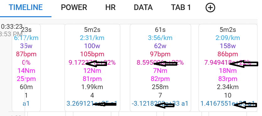

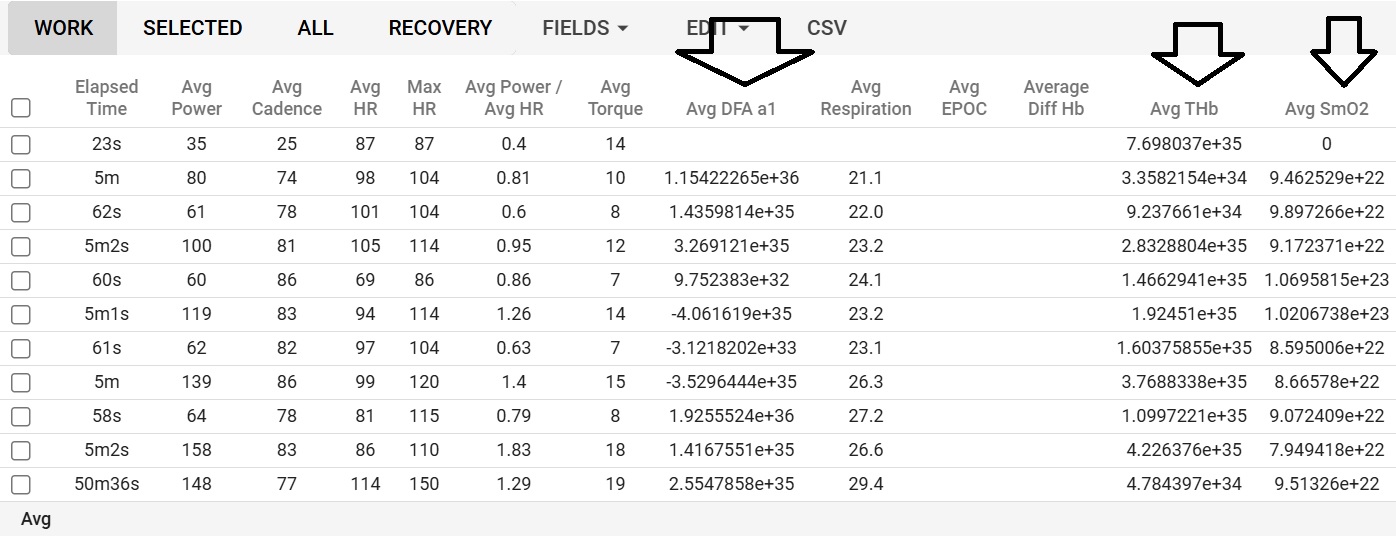

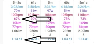

Thank you. I tried a different method today, an "easier" one, using only the power, cadence, speed, and elevation data from the Wahoo FIT file, and from the Garmin file I just checked the other fields to add SmO2, etc. There's an error in the SmO2 and DFA1 values, as you can see in the image. Perhaps it's a formatting issue?

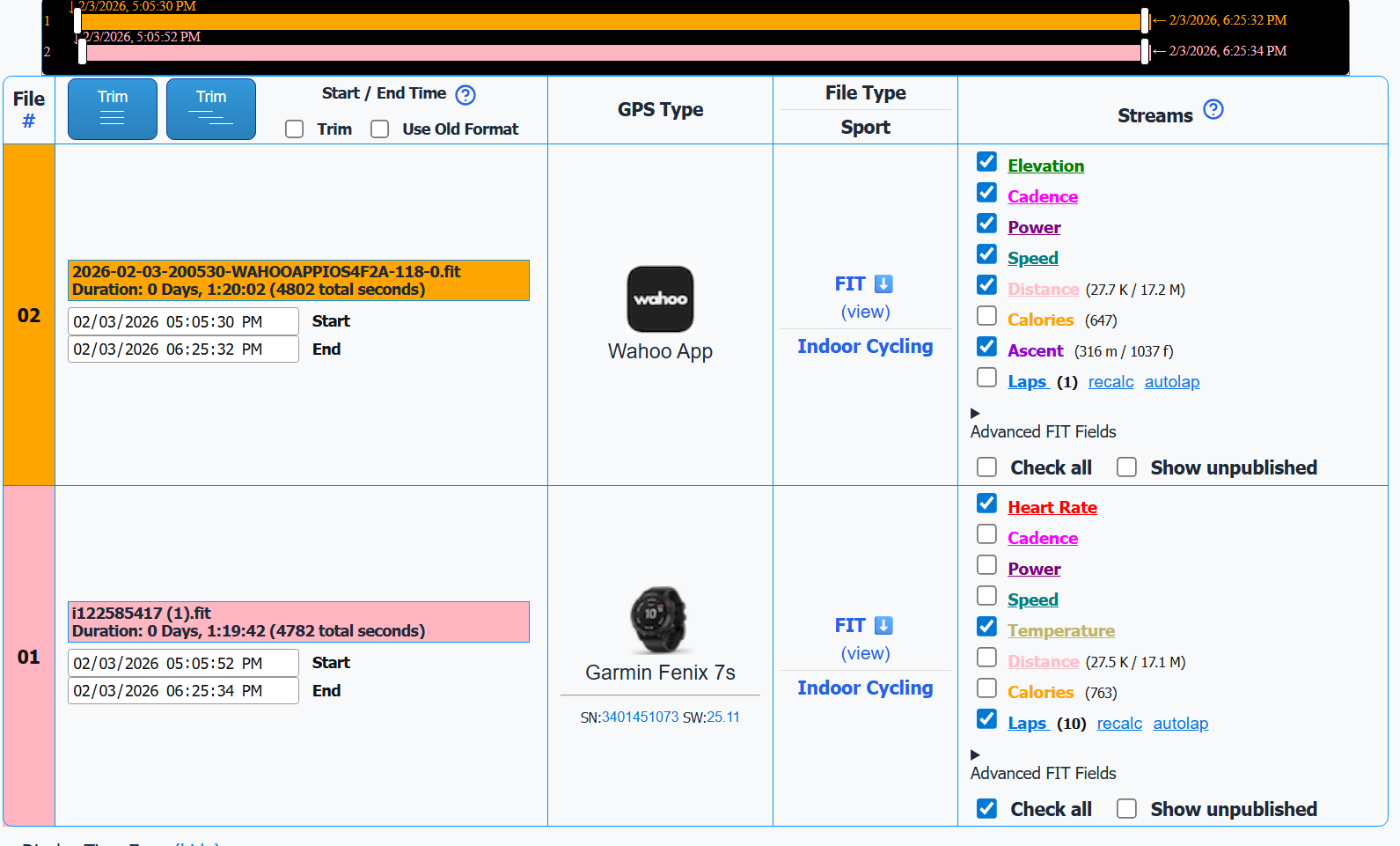

Hi -
I'm not able to tell much from that image; I'm going to need test files AND a full screenshot of your GOTOES settings.

Hi! I’m trying to pin down exactly what’s going wrong so I can fix it for you.
Here’s what I did on my side:
1) I took both of your files and trimmed + merged them. (In your screenshot it looks like trimming wasn’t used, but for overlapping files it’s usually recommended)
2) I then merged them using your same settings up top. I was not able to see any of your other settings down below so I just guessed.
I examined the file in my fit viewer (I used that tool because I don't know how to generate the intervals.icu view that you took the screenshot of). What I DO know is that the data in the output file needs to match the inputs as best as possible (I say best because merging is not as simple as it seems; you have to make decisions about what data to include, exclude, average, max, min, carry over, etc or risk a corrupted FIT)... Inside the FIT fields for SM02 and A1.... the data in the output file was exactly the same as the input (I only paginated over 5 pages, but it appears that the data is 100% intact.
Merging is unfortunately full of these “decision points,” and the new tool intentionally gives more options (good for flexibility, but it also means the output can vary more depending on what a specific device/app expects).
If you can describe the problem in a way that assumes I hardly use intervals.icu, I can probably get this resolved quickly. Specifically, could you tell me:
1) What exactly is wrong in the final result? (e.g., wrong totals, missing sensor data, spikes, gaps, wrong timestamps, wrong distance, etc.)
2) How can I reproduce?
3) If possible: a before/after screenshot of the same metric (original file vs merged file), or the exact name of the field/metric that looks incorrect.
Once I know which metric is “off” and how the device is interpreting it, I can adjust the merge behavior to match what you need.

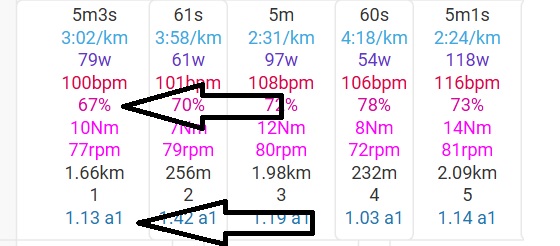

In the image, you can see that the normal values for SMo2 in % and Daf-a 1 are displayed differently compared to the image above. Previously, merging did not cause problems, and I don't think the trimming at the beginning is related to this issue.
I can see, as shown in the images, that the lap data includes both correct and "abnormal" values—likely a formatting issue? I'm not sure if it's interfering with other data as well; I haven't filled in other parts or noticed other anomalies yet.

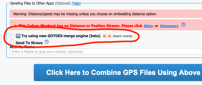

Update February 2026:
The new GOTOES Merge engine is now the only (therefore default) merge engine. I have since removed the intermediate one. I am leaving this post up for historical purposes, but the new engine should address many of the Connect IQ "edge case" issues.
-------------------------------Archived Post Below-------------------------------
Hi there! I just uploaded a new engine for the output. It is intended to fix these "edge cases" with Connect IQ data fields. Can you please give it a try? You need to make sure the "NEW" checkbox is checked. My plan is to make remove this checkbox soon and make this the default engine. I am looking for feedback before I dustbin the old version.

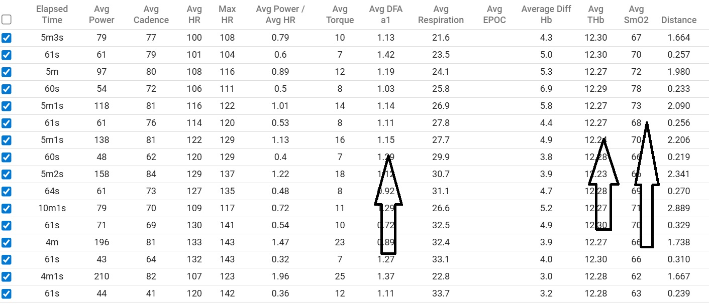

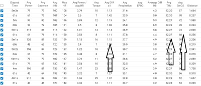

Looks like worked for this file, i will test with others and others config, like that one before, after training
