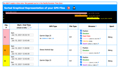

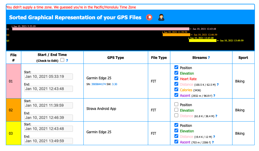

It appears that the 2nd file you sent (the one from the iPhone) is actually corrupted. Check out the attached image.
In the attached image, you will see a pink line (that represents your Garmin 25).
Next you will see the orange line. That is the iPhone file you sent me. It is corrupted, as it ends at 12:46:39...
So, I uploaded your corrupted iPhone file to Strava, and they got the remaining missing part out of it. Then I exported it from Strava as GPX, and uploaded it to my tool (just that one file; like you did: used the merger with one file). When I did that, I also did a crop so it would begin at 12:43:48... the exact same second as the pink line ends. That is what you see as the yellow line in my image.
I went ahead and unchecked all the boxes for the orange line, and combined everything from the pink and yellow lines.
Congratulations - that was a lot of climbing!
Best,
Best,
