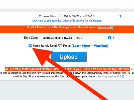

I wanted to add to this thread because another user got this same error message and was confused about the difference between "Connect IQ" fields and "Garmin Native Fields." Garmin Native fields will not be identified as "Connect IQ" fields, and there is a different way to get those to be processed by the tool (which is to check the box as shown in the image below):
Check This Box to get the extra Garmin Fields!
For a full discussion on what is going on in this situation, please read my reply to this post here. That reply explains in detail the difference between these two data sets and should hopefully help users avoid future confusion.
