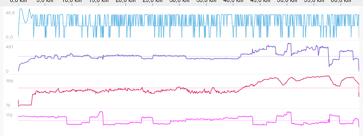

Yesterday, a user reported to me that they experienced a spiky speed graph after using the GOTOES | Strava tools to merge two overlapping files. Here is what it looked like:
Notice the speed graph (blue) spikes up and down erratically
The Problem:
I investigated the files carefully; the original TCX file looked very similar to the original file. It took me a long time to determine the difference, but I finally found it:

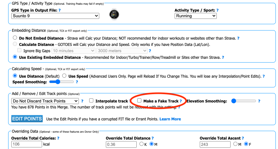

Make the Indoor workout look like an Outdoor workout to Strava. Since we know that Strava is going to recalculate the speed no matter what, we can "take control" over how they calculate the speed by giving them something else to make the calculation based on: Latitude and Longitude. If we make a "fake" GPS track, we can force Strava to consider the workout to be an outdoor activity instead of an indoor workout. The tool can carefully place GPS points based on the (Distance = Speed * Time) equation so when Strava does the reverse calculation (Speed = Distance ÷ Time) it gets the correct speed. This allows us to use 1-second recording in the final file AND maintain proper speed. Here is how you achieve that in the GOTOES | Strava Tools:
To try and fix the irregular speed issue, please try checking the &quot;Make a Fake Track&quot; option.
To try and fix the irregular speed issue, please try checking the "Make a Fake Track" option.

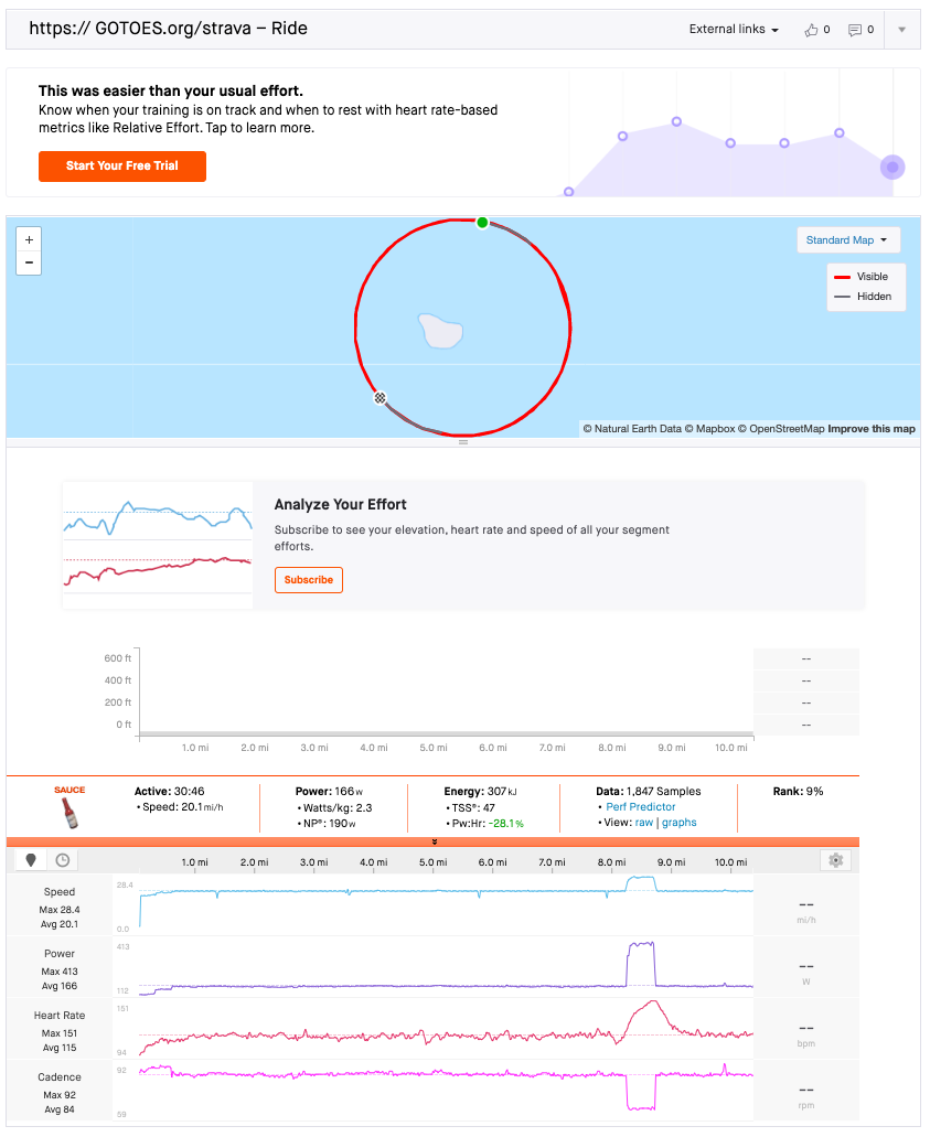

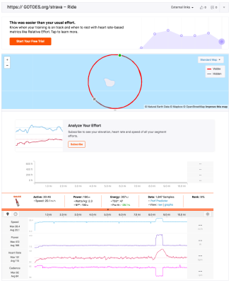

After you make a fake track, this is what your activity will look like... notice how there is now a map associated with your activity. The map is essentially a circle out in the middle of the Pacific Ocean. The reason I selected this location is because the entire segment has an elevation of 0 (as to prevent Strava from automatically calculating elevation. By the way, the fake-track feature also can help if your indoor workout isn't showing override elevation properly). Also, because it is in the middle-of-nowhere, it shouldn't affect any real leaderboards.
Also, notice that the speed graph is now correct and much smoother than before:
Making a fake track - essentially making an indoor workout look like an outdoor activity allows us to &quot;take control&quot; over how Strava calculates speed from the activity.
Making a fake track - essentially making an indoor workout look like an outdoor activity allows us to "take control" over how Strava calculates speed from the activity.
