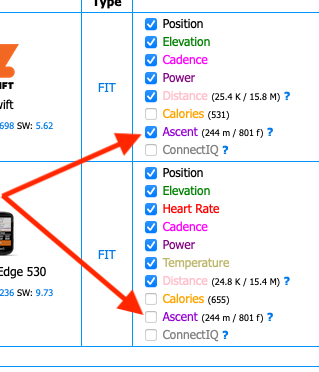

For files that DO have total ascent embedded, you will see the checkbox in GOTOES to include it in your final file. Here is a screenshot of what it SHOULD look like if you have ascent embedded in the original file:
Please notice how both of these example files have the "ascent stream" embedded in the original file.  This tells the software how much climbing the GPS thinks you did.  Without this information, the software will be forced to calculate your ascent - and the calculations are often different from what the GPS originally stored.
Here is what your file looked like. Notice the absence of an ascent stream:
In the absence of an ascent stream, Garmin and/or Strava will calculate your ascent.  You can override that calculation if you fill out the "Override Total Ascent" box (as described in next paragraph).

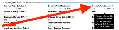

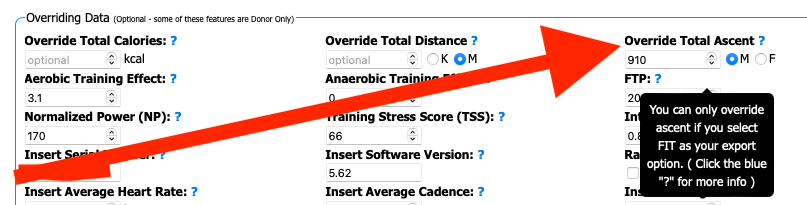

So, if you do not want for Garmin to recalculate your ascent, you can just have GOTOES override your total ascent. That is one of the features enabled by GOTOES FIT file export. In the screen shot, you can see, I typed in 910 meters as you want the final ascent to be. That is what Garmin will display.:
This is how you can override the total ascent to get the EXACT climbing you think is correct.
