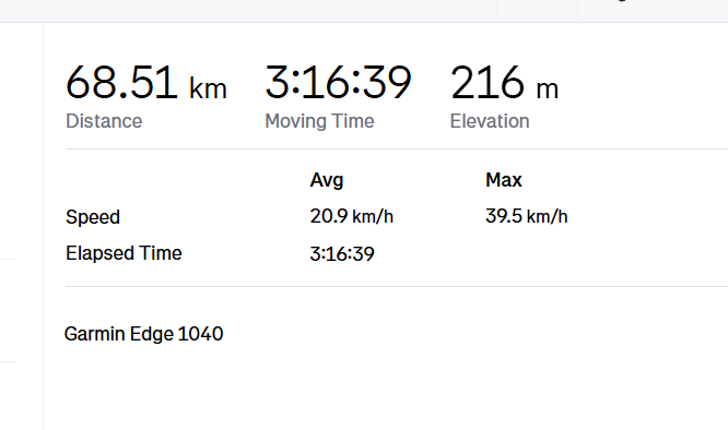

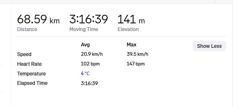

After uploading it to Strava all data is visible. But after going through gotoes additional data is lost. Fit only has distance and time.

I have already corrected the errors and I get the correct fit file with complete data.
