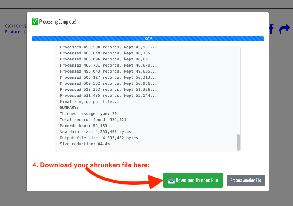

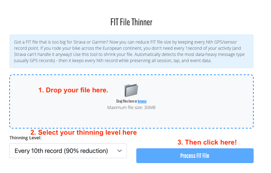

The way the tool works is that you upload your FIT file, and GOTOES searches for the most abundant message type (typically the records - the ones that include your position, heart rate, cadence, power, etc.). GOTOES lets you specify how much data will be removed and how much smaller your file will become. Your goal is to get your FIT file down to about 2Mb. So, if you have a 24Mb file, you're going to want to select the "Every 10th record (90% reduction)" option. If your file is only 10Mb, you might be able to get away with only discarding half of the data... Feel free to try different options.
