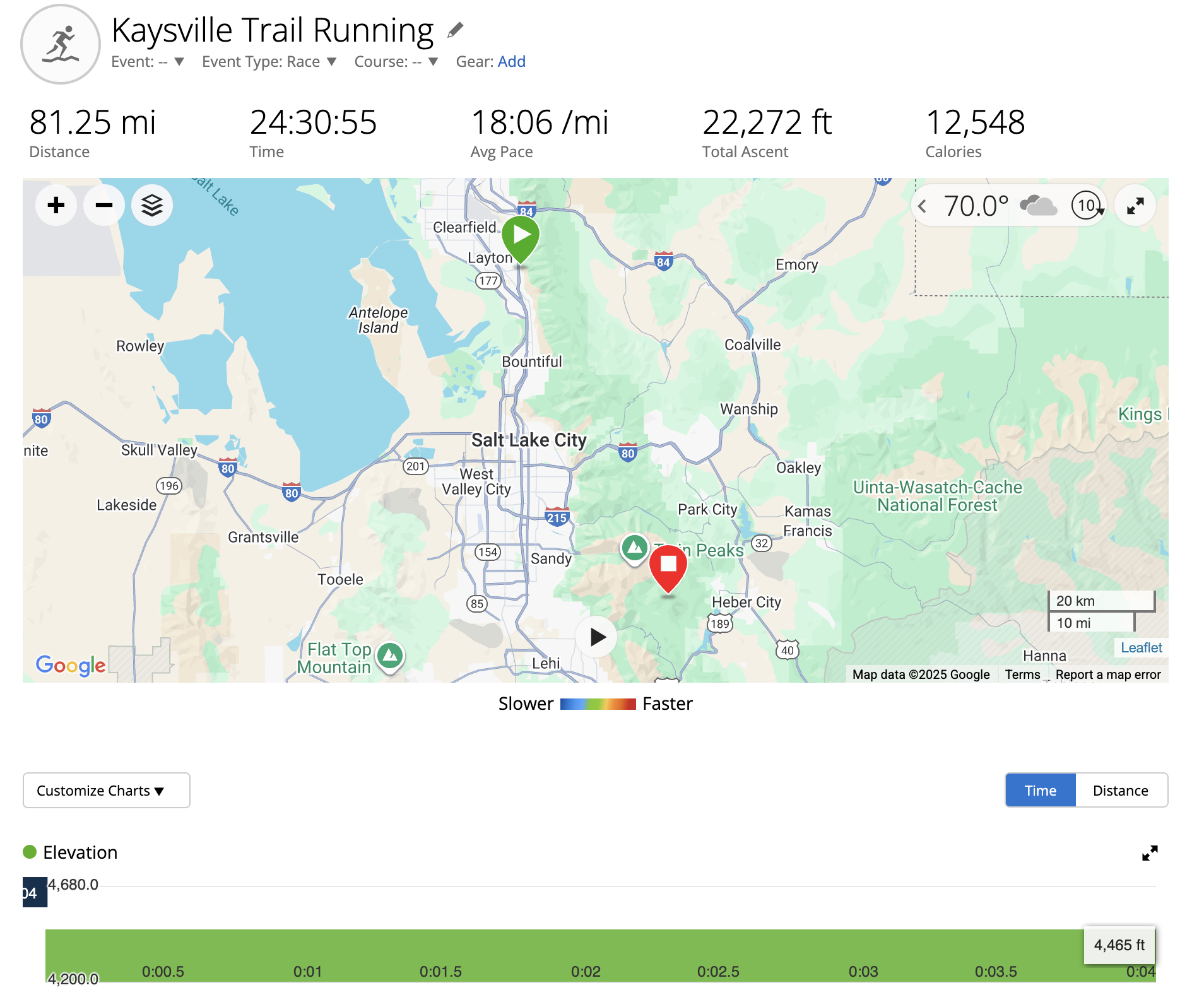

Garmin died during a race. The actviityon garmin has the pace per mile, but total duration shows as 4 seconds long. It also has the inccorect start time, which should be Sep 5th 5 AM. Tried using time shift, but I'm still not able to fix. Trying to fix the fit file then combine with my pacers recording of later stages.

Thanks for your post. I have tried all of the FIT FILE REPAIR methods described here and the most that I was able to realistically get out of your file were 5 points. These were 5 records (#20) - all without position data. There is some non standard data in there; this isn't a "frame shift." It may be able to be repaired.. but I don't know how to interpret it. Sorry.
